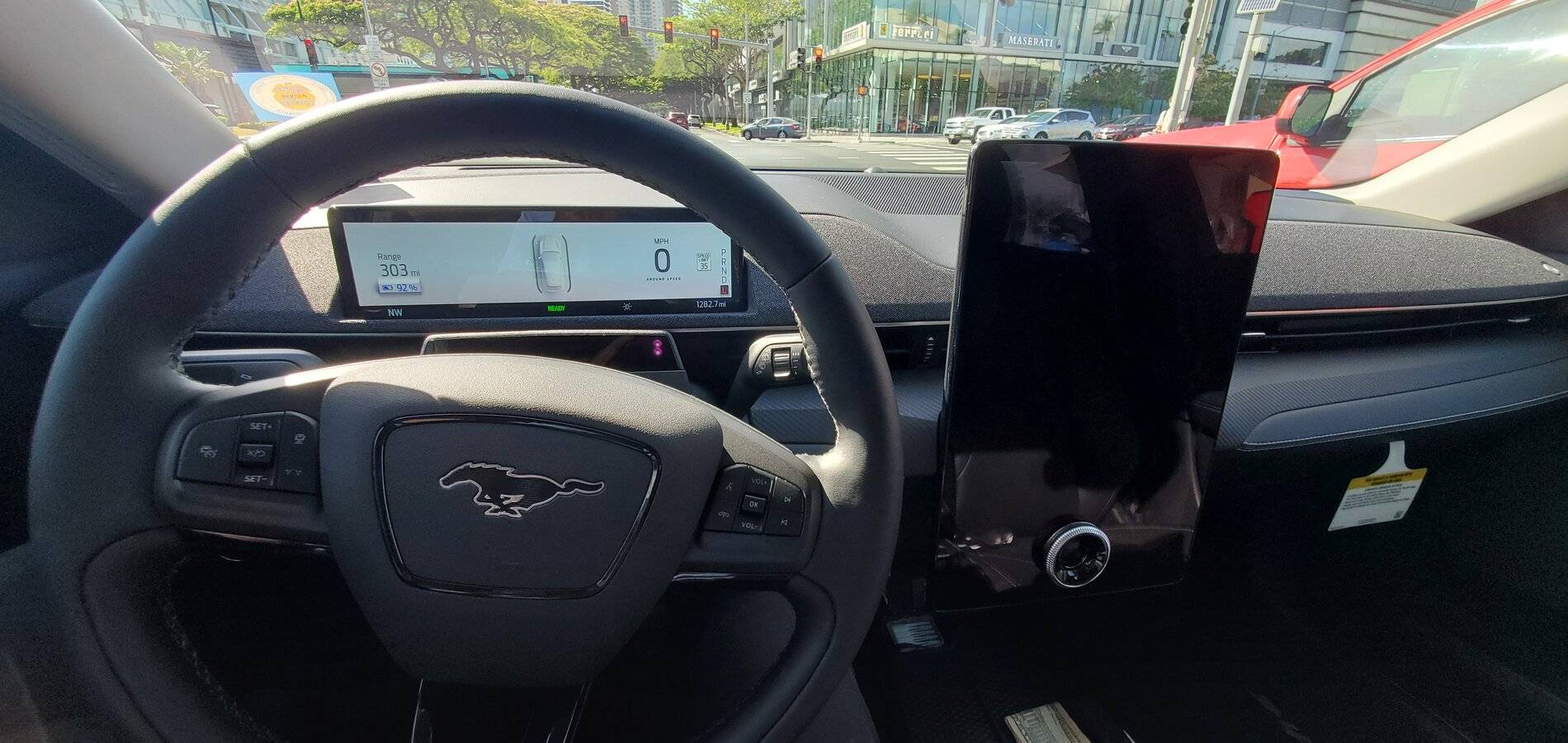

This black screen issue happened with my MME. The touchscreen worked fine when I drove from my home to the mall. Then when I got in my car to drive home, the touchscreen was blank (black). I started the car, but no radio, no A/C, and everything you do through the touchscreen was inoperable including the A/C, radio, forward crash alert, brake assist, auto lane assist, all while I was driving home. When I got home, I plugged the MME into my Level 2 charger in the garage and started researching this forum. 30 minutes later I returned to my garage to try the Sync4 reset mentioned above; I started the ignition - and the touchscreen booted up completely into full operation mode. The only odd thing was the tire pressure read "2.8 bar", and my settings were missing; but all of the stored setting took about two minutes to fully restore including the tire pressure at 40 PSI. I guess the electronics needed some sort of wake up which the Sync4 reset could solve, but maybe just plugging it into a Level 2 charger works too like it did for mine. MY MME range was over 300 miles at the time. Thanks for all the posts!
screen *should never* go black.... despite re-boot working, you should tell your dealership, send this photo, and have them schedule replacement of display and associated modules.
In the meantime, be sure not to park facing south without putting your sunshade up to prevent the back of the display from getting super hot.
