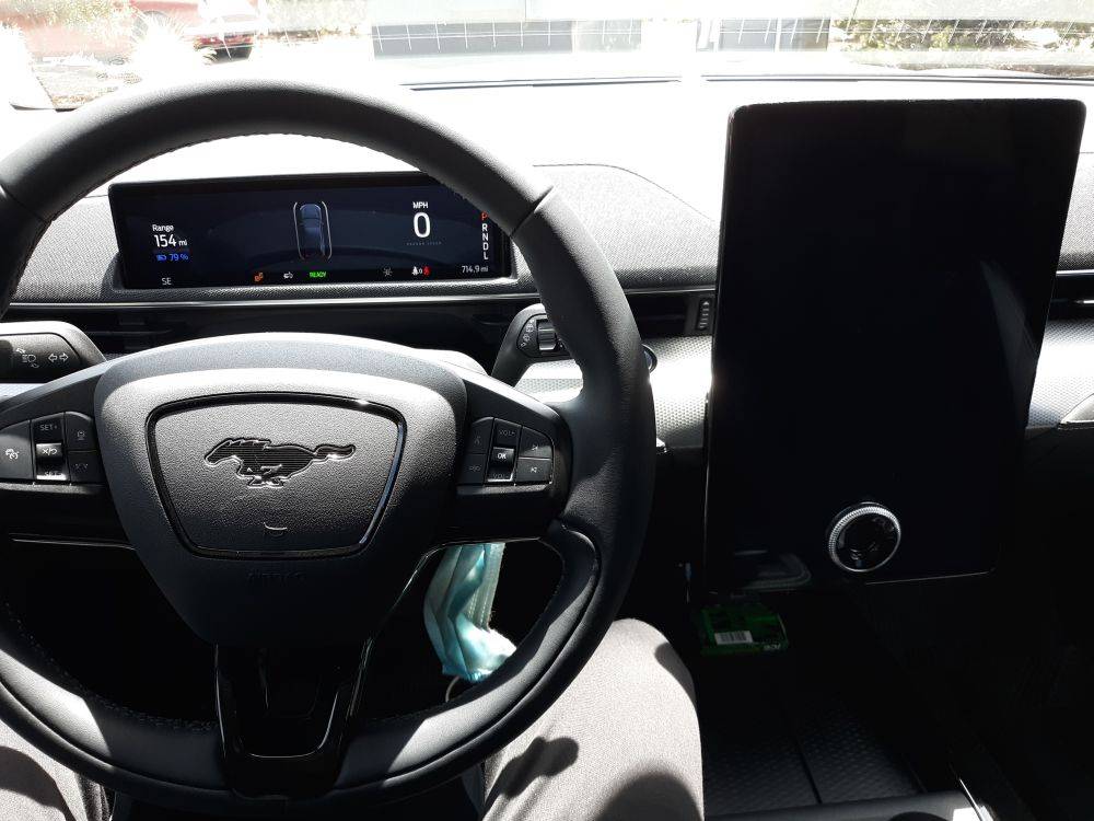

My center console went black for the second time yesterday. Both times it happened after I had parked outside facing south for an hour or so.... and both times the cabin temp was 'not bad', but the back of the console (facing the sun) was uncomfortably hot to the touch. I'd guess 115+ deg F.
MME started and ran fine.... console, including radio power button were black. Console FUNCTIONED to touch, but display was black.
This is a big problem, not just a pain.... There are plenty of times when PAAK doesn't work for me, and I have to enter BackupStartCode; won't be possible on a completely black screen!
My bet is that the console has a temp sensor like any computer and is shutting down the display above some set temp.

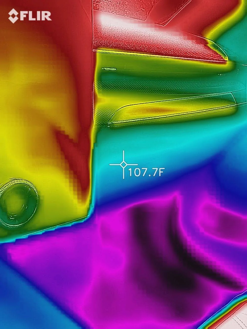

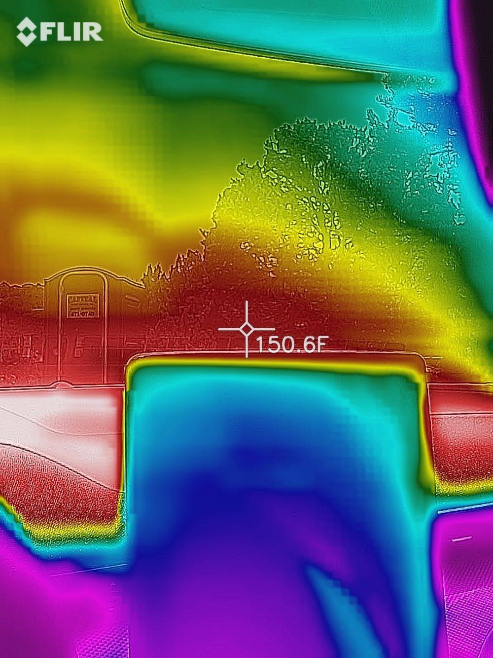

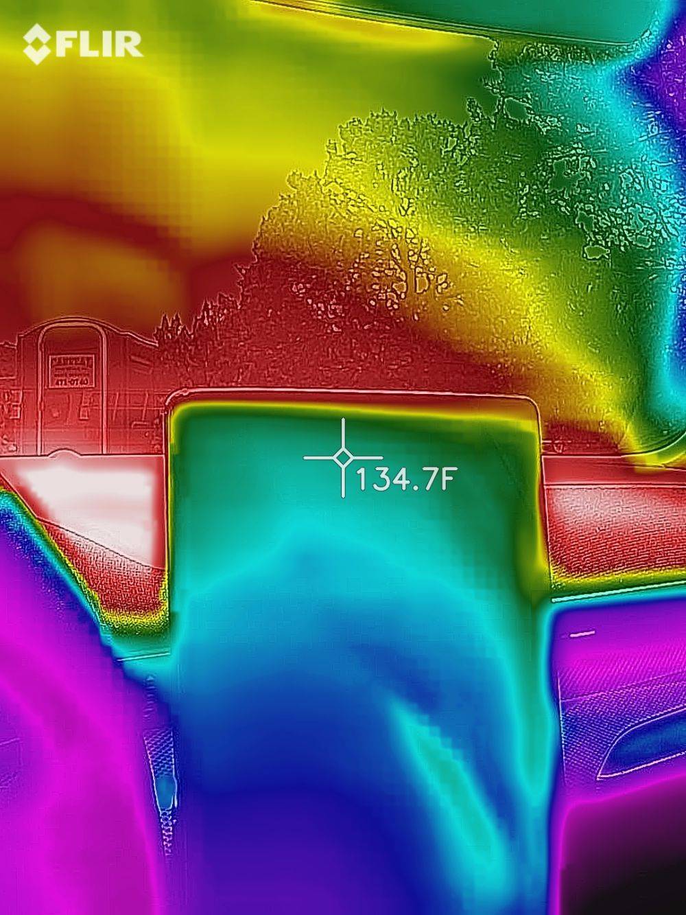

I ran a test today....
a. pulled MME out of the garage, parked facing south at 10am, turned off
air temp about 60 deg, winds about 15mph SSW
b. went back at 1pm, started MME, center console BLACK
cabin temp of dash in shade = 108
center display = 135
inside windsheild surface = 150
can anyone else repeat this test?
and happen to have a FLIR or other way to measure surface temps?
...possibly important note is that I have infinite blue MME, and back of display is BLACK.
So, I would advise using a Sunshade when parked outside if you are facing South, and hope that Ford considers a design change for 2022, and maybe some 'snap-on' retrofit to give to 2021 owners to protect the back of the display from direct sun exposure.
I would not consider this issue [SOLVED] until I can park in the sun facing south, and the display works when I start the car.
