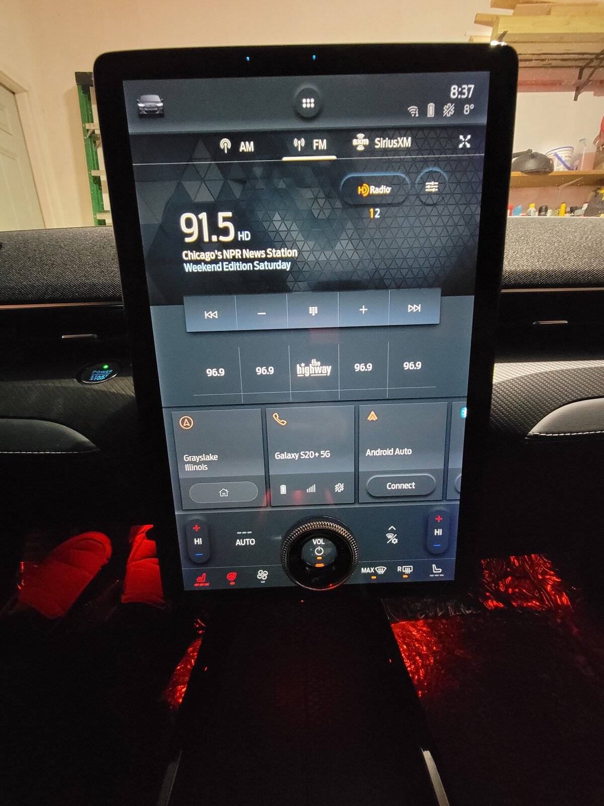

Yep, exactly. Held for maybe 10 seconds is. Screen restarted and all has been good since!

There's a soft reset procedure that isn't in our manuals that I can find, but is the same as Sync 3 - seek right plus volume down, on the wheel in this case:
https://www.macheforum.com/site/threads/ssm-49457-various-sync-4-system-concerns.3005/

THANK YOU! This fixed it!!
I tried volume down + LEFT to try and enter the diagnostics screen, but volume down + RIGHT does a soft reset of Sync and the touchscreen!!
