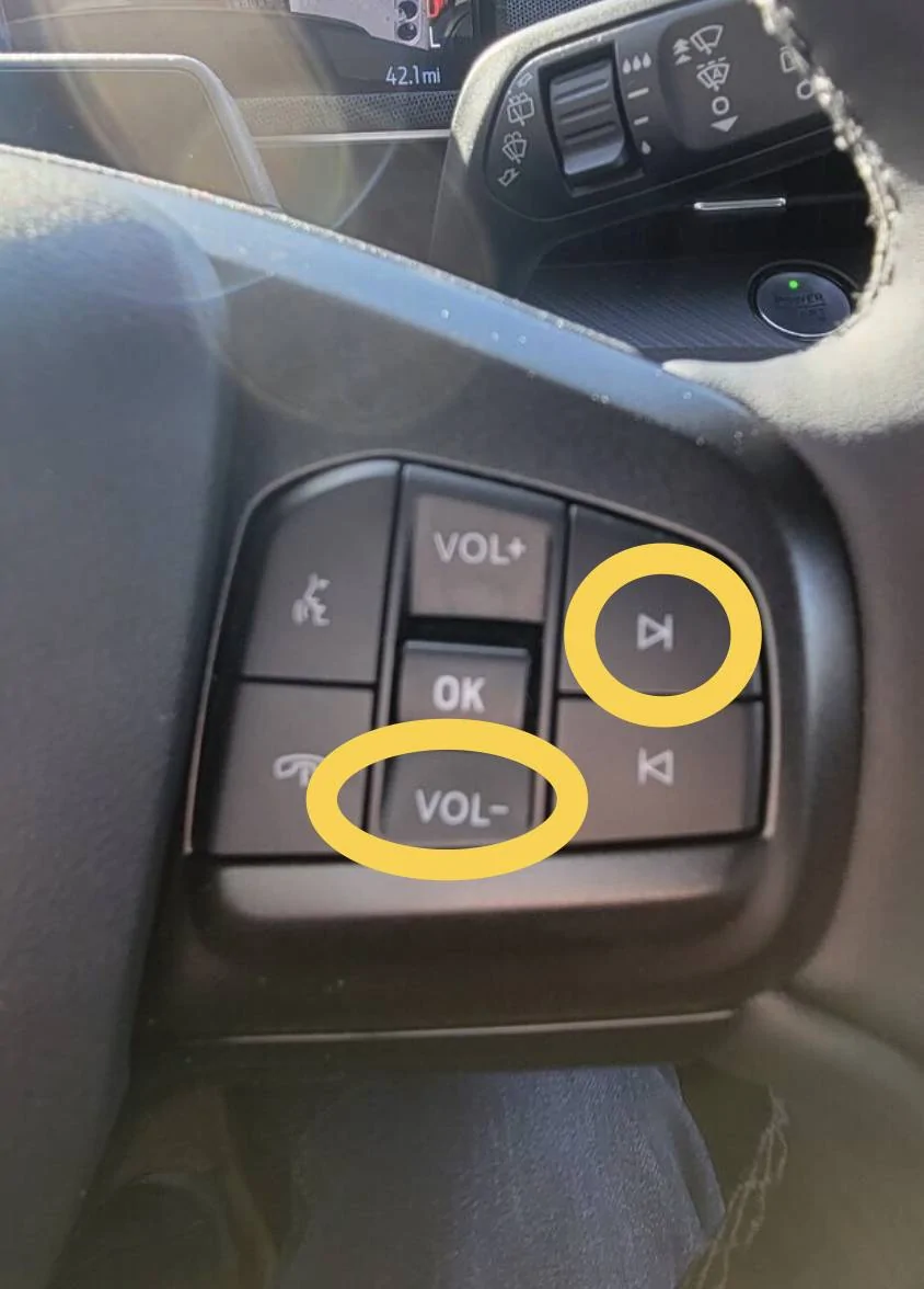

Just to be perfectly sure-we hold both of these two buttons in unison for 10 seconds to perform a reset of the Sync 4a system?
Yep, exactly. The volume key on the steering wheel is actually a rocker, so just push it to the volume down position and hold that right arrow key for 10 seconds.
There was another user here that was having a different issue, but related to Sync/the touchscreen and this reset seemed to help them too. So this might be quite a handy thing to remember!
This seems to be equal to CTRL ALT DEL

THANK YOU! This fixed it!!
I tried volume down + LEFT to try and enter the diagnostics screen, but volume down + RIGHT does a soft reset of Sync and the touchscreen!!

The Sync4 reset is to hold the volume rocker in the volumne down position and the right arrow key together for 10 seconds (both on the right side of the steering wheel). This resets the 15.5' touchscreen and in my case solved the issue! The screen came right back on and has worked since!

That sucks!! I'm sorry to hear that it isn't working for you. I found I had to hold it down longer than I expected. I'm sure you have been, but make sure you hold it down long enough.
There were a lot of people in this thread mentioning fuses and to try and pull one of the terminals of the 12V temporarily to do a hard Sync reset, so maybe those are options for you?
