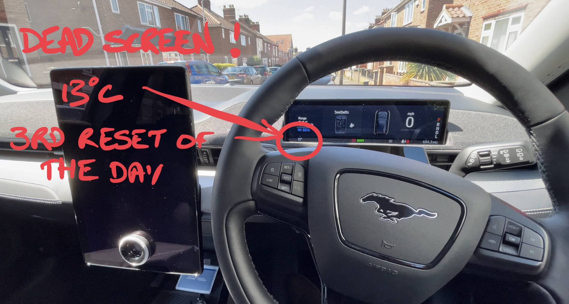

I picked up the car two weeks ago, so far I've had to reset the screen 11 times.
Ford UK are "looking into it" ?

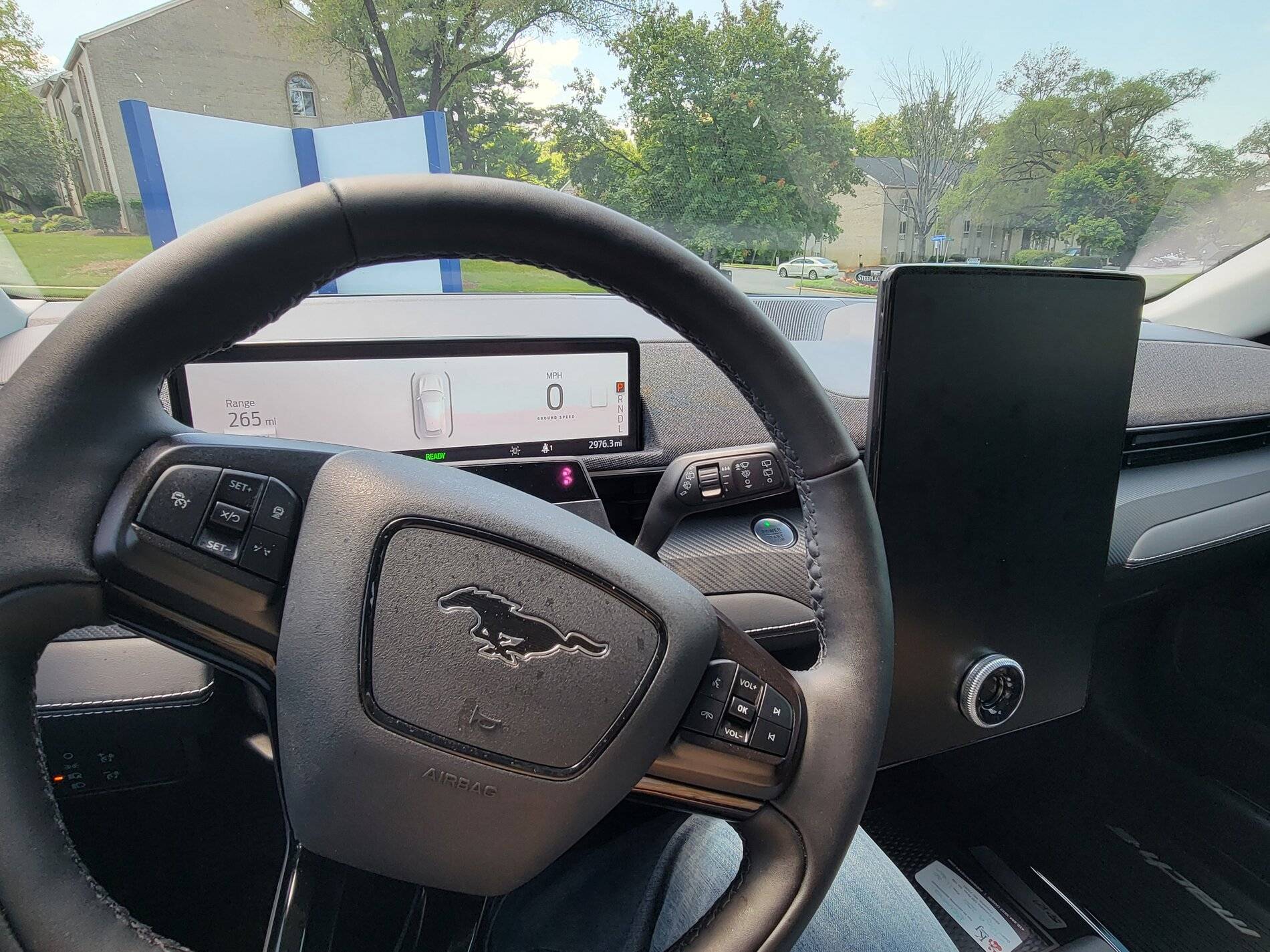

I've got this same issue. I'm going to try and do the reset. I didn't have my car in the sun. So, I'm not understanding why it blanked out. It works when I put the car in reverse. It will display what the camera is seeing.

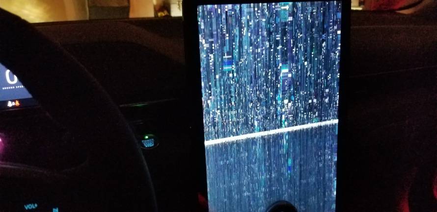

Did you ever get a response from the dealer on this? This happened to me today and if it wasn't for reading this forum I wouldn't have known about the soft reboot ahead of time. Luckily the key combo is all over google now if you search for it. But if what others are saying here is correct that there is some issue that requires a console replaced I better contact them on it. This to me looks like a video driver issue but who knows.
