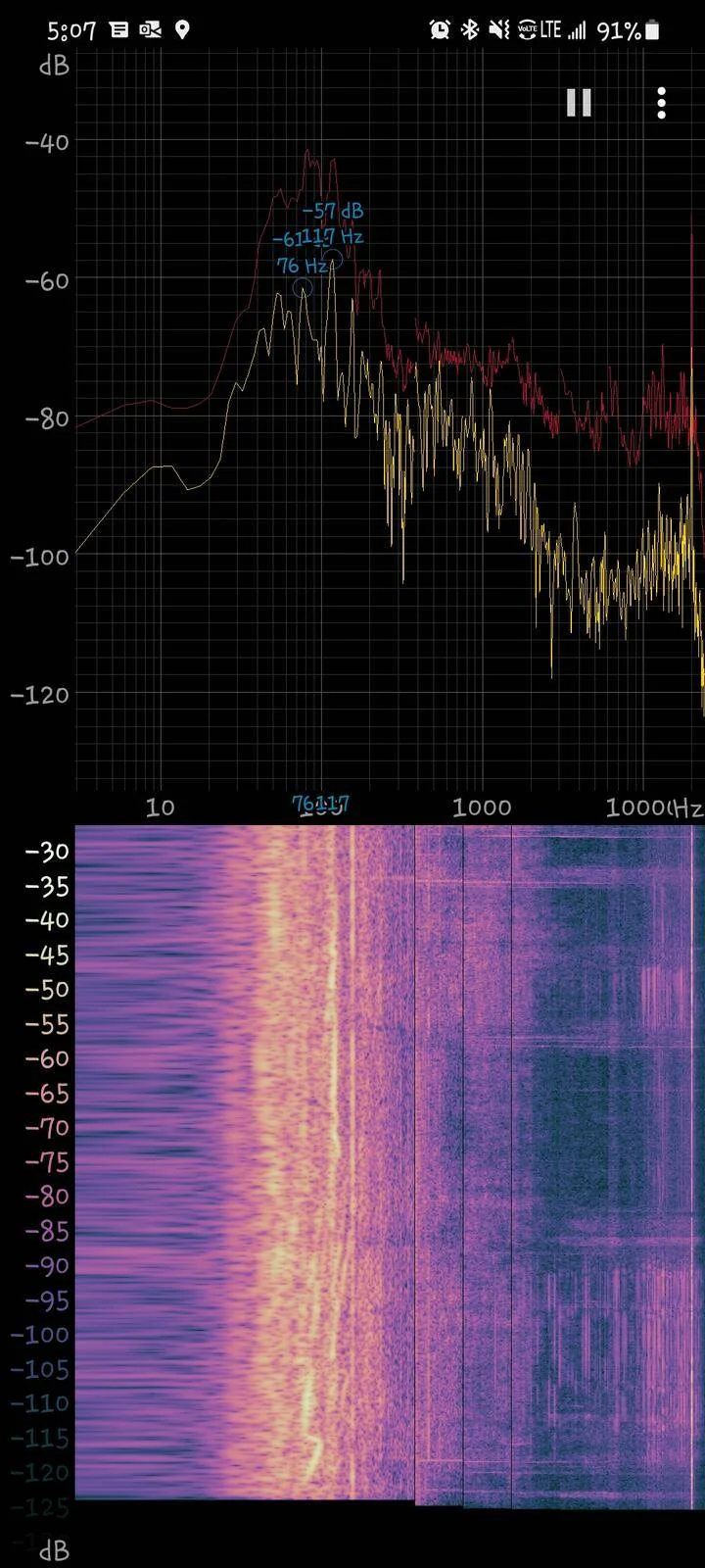

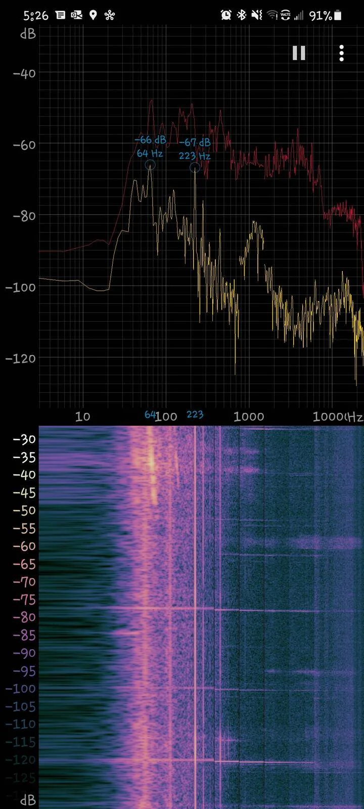

So I finally got to take a test drive today. Loved everything about the car, except that the car I drove definitely had an audible screen whine. In October I got to sit in the road tour car and didn't hear it there. In the test drive, I could hear it clearly from my seated position while driving with no music playing. I think it would be drowned out with music, but not great without it. Really annoying. I took a spectrum capture for reference in the MME and in my current car (Audi A4).
MME (Premium AWD Extended Range - Early December Build - VIN: 3FMTK3SU7MMA03470)
Ford Mustang Mach-E High-pitched "Electrical Whine" 1614384676418
My 2017 Audi A4 with climate and radio off...
Ford Mustang Mach-E High-pitched "Electrical Whine" 1614384743006
Both range from the phone in front of the steering wheel and moved to the seated position. For reference the A4 also has a screen behind the dash. There was a MUCH bigger peak in the MME especially around 117 Hz and a higher average power. Here's hoping Ford can fix this and that mine doesn't have it.
