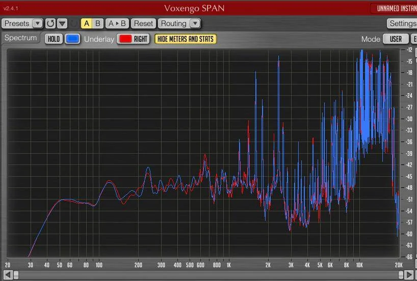

Oh that whine is nasty! This is what his recording looks like as a spectrum:
As somebody said, it is probably a square wave, which would have lots of harmonics, which the above indicates.
