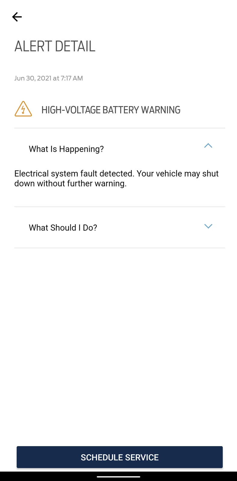

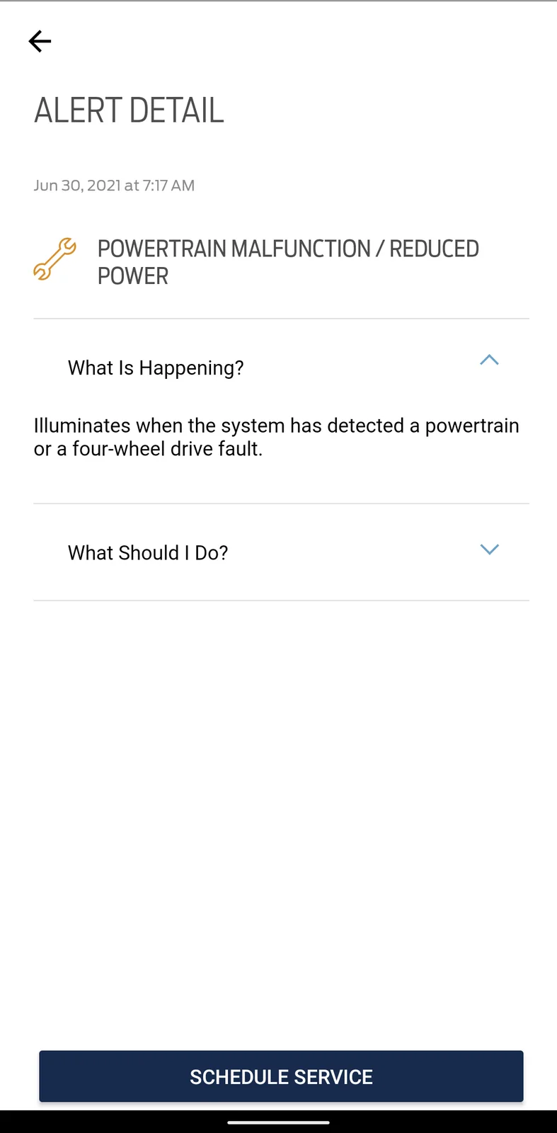

So I got my car back on Friday (Aug 6) after 37days at the dealership with no loaner car, even after tons of calls and complaining to Ford Customer service.
It turns out the issue was one cell in one battery module was reading ~216mAh, they should be around 270mAh. They had to replace 2 full modules because the are on the cooling plates in pairs and they must be assembled in the factory. So due to 1 out of 36 cells in one module was bad, they had to replace 2 of the 12 battery modules/packs.
I got the car on Friday evening, and it was at ~80% charged. I drove about 80 miles Saturday, then it sat in my driveway till this morning (Monday) and I did not charge it. Went to leave for work this morning and BAM! Same faults! And in limp home / turtle mode.
Now I am at the Dealership. The Tech just talked to the Ford Engineer, they told him it looks like one of the modules did not update fully and get up to the correct voltage. Even though a Ford Engineer was at the dealership when it was completed/fixed last time and was supposed to verify everything was set and updated correctly.
Ford Engineering is asking the Technician to use ”Expert Mode” in the battery update tool to get the voltages up in that one module. He is working on it now, but he has to drop the entire battery pack out of the car to do that...
The Dealership is working to get me a loaner right now as I sit in the waiting room....

Also, Ford will not fix the buzzing screen issue, they say some cars have it and it is "normal”. Here is the text (Friday) from when the Ford Engineer was on site to help finalize the fix on the battery the first time.
Ford Mustang Mach-E High Voltage Battery Failure (2 modules need to be replaced) Screenshot_20210809-101514
