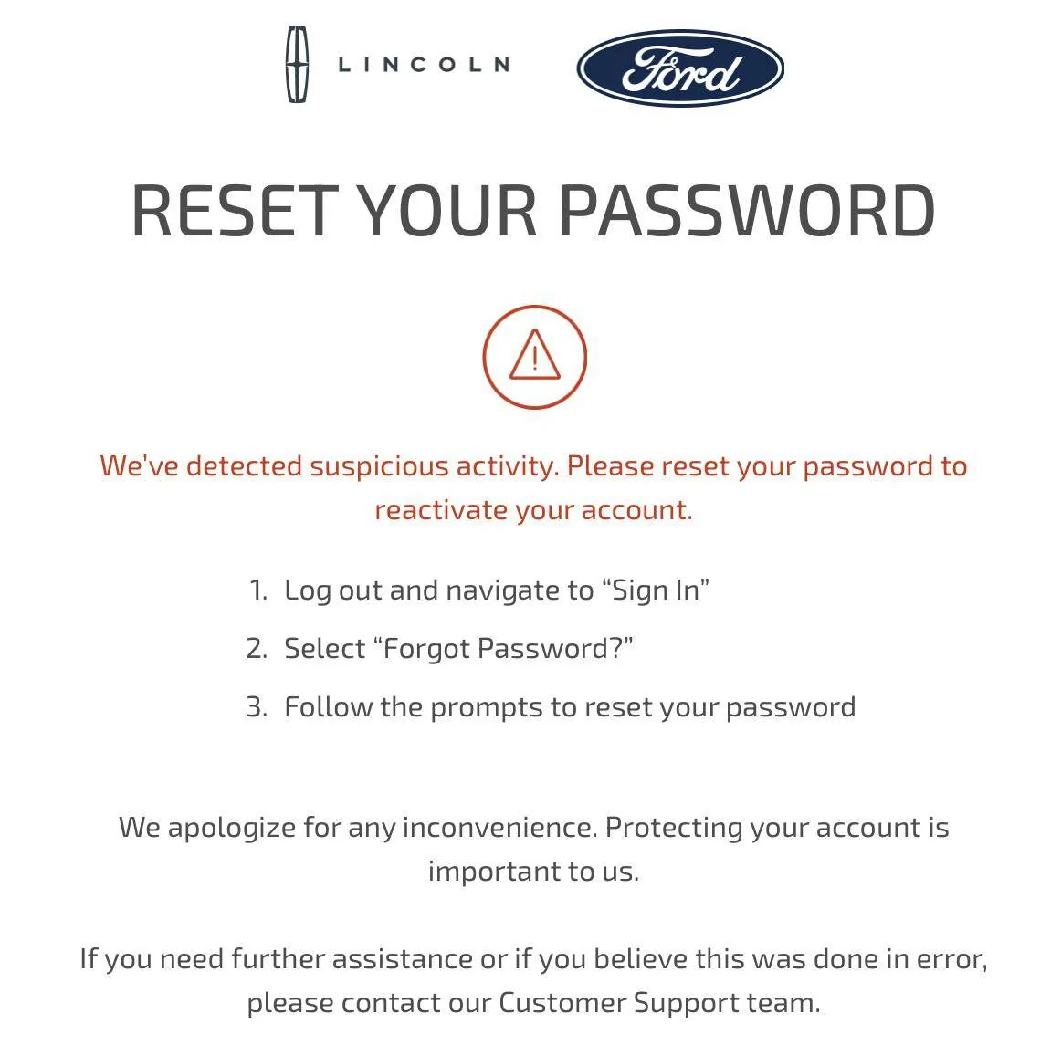

I just thought I would share my experience connecting FordPass to HA. I have 2 Ford vehicles now, so I decided to connect the Mach-E, too. After a few hours, I got an email saying Ford detected suspicious activity and locked the account. After a couple of rounds of it. I decided to setup another account and connect each vehicle with one account to HA, and since then, everything has been working fine. I guess this keeps the account below its API threshold that Ford has setup and blocks the account. Hope this helps in case anyone else is looking to setup HA automation with multiple vehicles from Ford.
