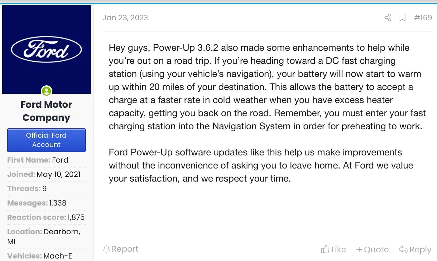

To Lee's point, FoMoCo kinda dropped the ball on this one - I just went back to look at the 3.6.2 release notes in FordPass and they make no mention of it, just the GOM update - "more oooo and less ahhh" or whatever it said
I wasn’t replying to him. The two people I quoted specifically questioned Ford’s social media account mentioning this feature. The link I posted was to the thread where the feature was confirmed by the Ford account. ??‍♂
Right - I'm just wondering out loud why pre-conditioning wasn't mentioned in the 3.6.2 release notes when it had the potential to earn Ford some Brownie Points. That's a pretty useful OTA update
Generally very little of substance in the release notes, like you said earlier.

Ford's release notes are wild. When they have good stuff to report like preconditioning and the fixed youtube client, it's nowhere to be found. But when they add a shitty Adobe flash-era game to the car? You'll know about it.
