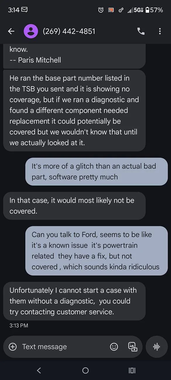

My 21 Mach E premium AWD first edition does the same thing this is the response I got from the dealer
"unfortunately we can't do anything about your broken car until you pay us money, even if it's an issue caused from how your vehicle was made"

My powertrain warranty runs out in January or February so I was trying to get them to use that to cover this somehow
