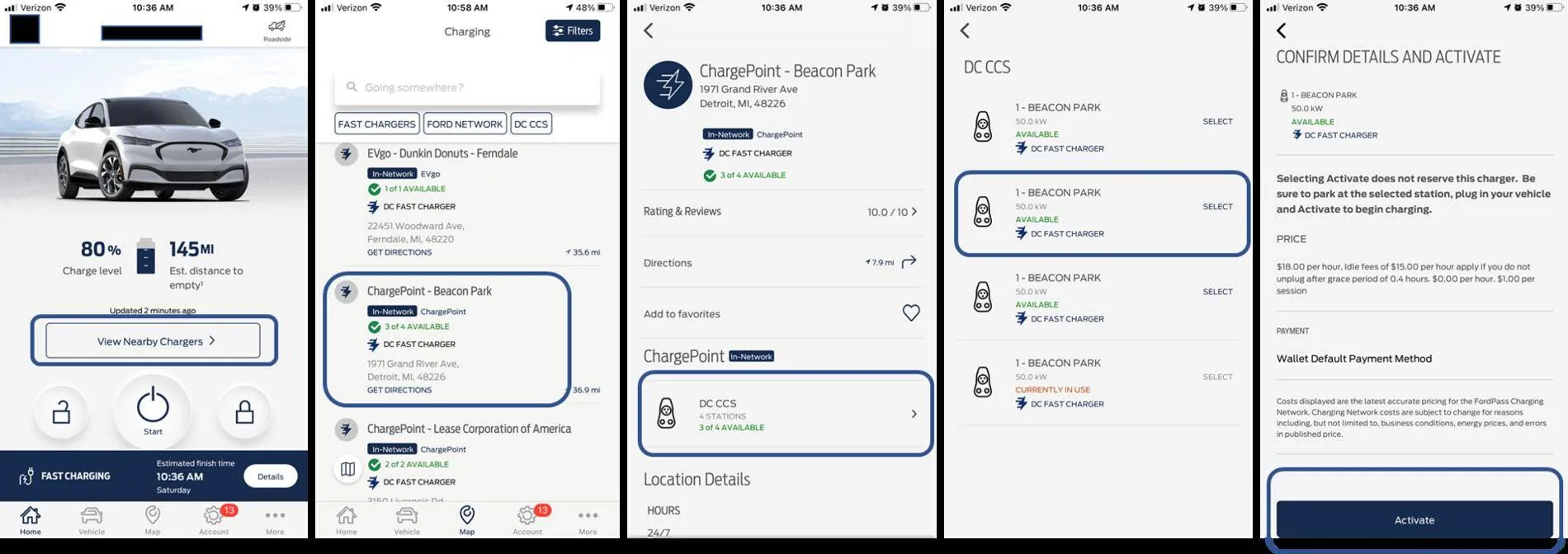

I had done this weeks ago and got exited that was the missing link to make Plug & Charge actually work. I tried on 3 different chargers and it never worked as advertised. Each time I got "Charge Station Fault" after plugging in and waiting a few minutes. The only way I was able to get it working with FordPass was the manual process:
1. Find the charging station in the app
2. Selecting the charge station I'm parked at
3. Activating the specific charge plug
This process worked for me every time, but it is hardly as simple as "Plug & Charge". I'm sure it will work correctly eventually, but considering VW's own EV's don't do Plug & Charge on their own charging network (Electrify America) I'm not surprised it doesn't work consistently with the MME ?.
I was hoping to use my free 250kWhr on upcoming trip... but I can't unless I can activate my Ford charging network membership.

The tech support person fixed it on their side.
Good luck!
smp
hhhmmmm, tech support person I finally got said there was nothing they could do to activate plug & charge from their side. ;(

Have you tried using the 7 step approach that bypasses P&C?
I tried following the OP steps.... I get the final screen that says 'confirm activation', and.... error dialog pops up, "oops, call ford", did that, they can't activate from their side apparently.
505
14,328
28,694
Bummer

followup for today is
SUCCESS.
My scathing review of my failed phone support call, or perhaps my email to Mike Levine, caught the attention of Matt Stover who is in charge of Plug & Charge issues. Matt emailed, and called me back directly to help debug as they are working on this exact issue with a number of people at the moment.
apparently there is a bit of Latency in the activation/confirmation process as Ford has to swap info with all their participating chargers. It can 2 hours to 2 days at this point.
so...... they are listening, they are working on it, and the better news is they are also working on centralizing support handling, knowledge base, and hopefully enabling online support in addition to phone

For future reference once you get past the confirmation/activation......I clipped this from a previous post and kept it handy when I went to EA to use FordPass and the free kWh.
A perhaps stupid question, if I may:
In your example, the location shows 4 chargers....how does one tell which entry in the app corresponds to which charger?
The station charge port will have a number label on it that corresponds to what is shown on the app. I've noticed the label is at the top of the charge station.
