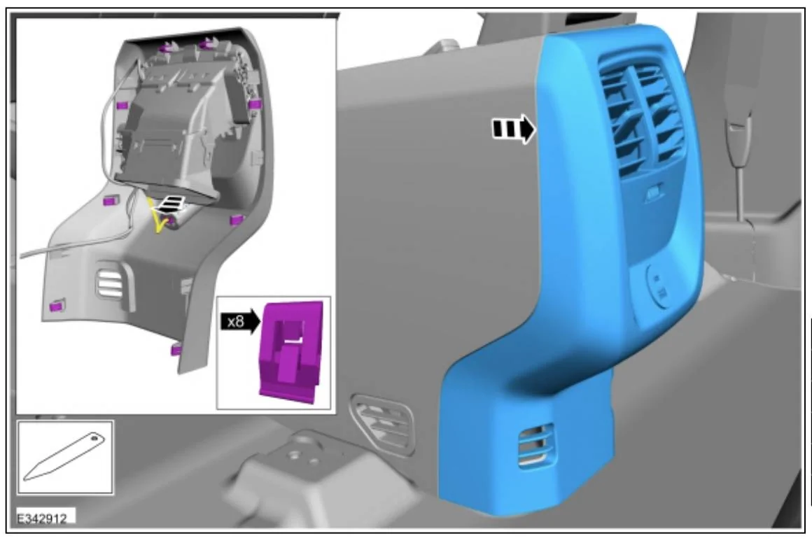

Does anyone happen to know how to remove the center console panel with the air vents and USB ports? Does it just clip on and can be pulled straight off?

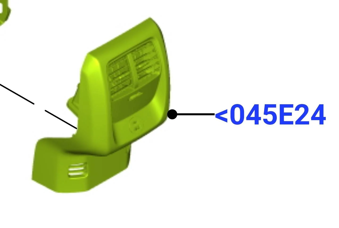

Eric, yes that rear console panel just pulls off. There are 8 clips holding it on. The full part number is LJ8Z-58045E24-AA and costs around $167 at Tasca Parts or most other parts suppliers.
Great, thanks a lot for your help! I figured it would be cheaper somewhere else but couldn't find the full part number.
By the way, where'd you get that diagram?

You had a partial part number and the Mach-E parts prefix for many parts starts with LJ8Z so I added that to your number to get the full number. I got the diagram from the repair manual.
