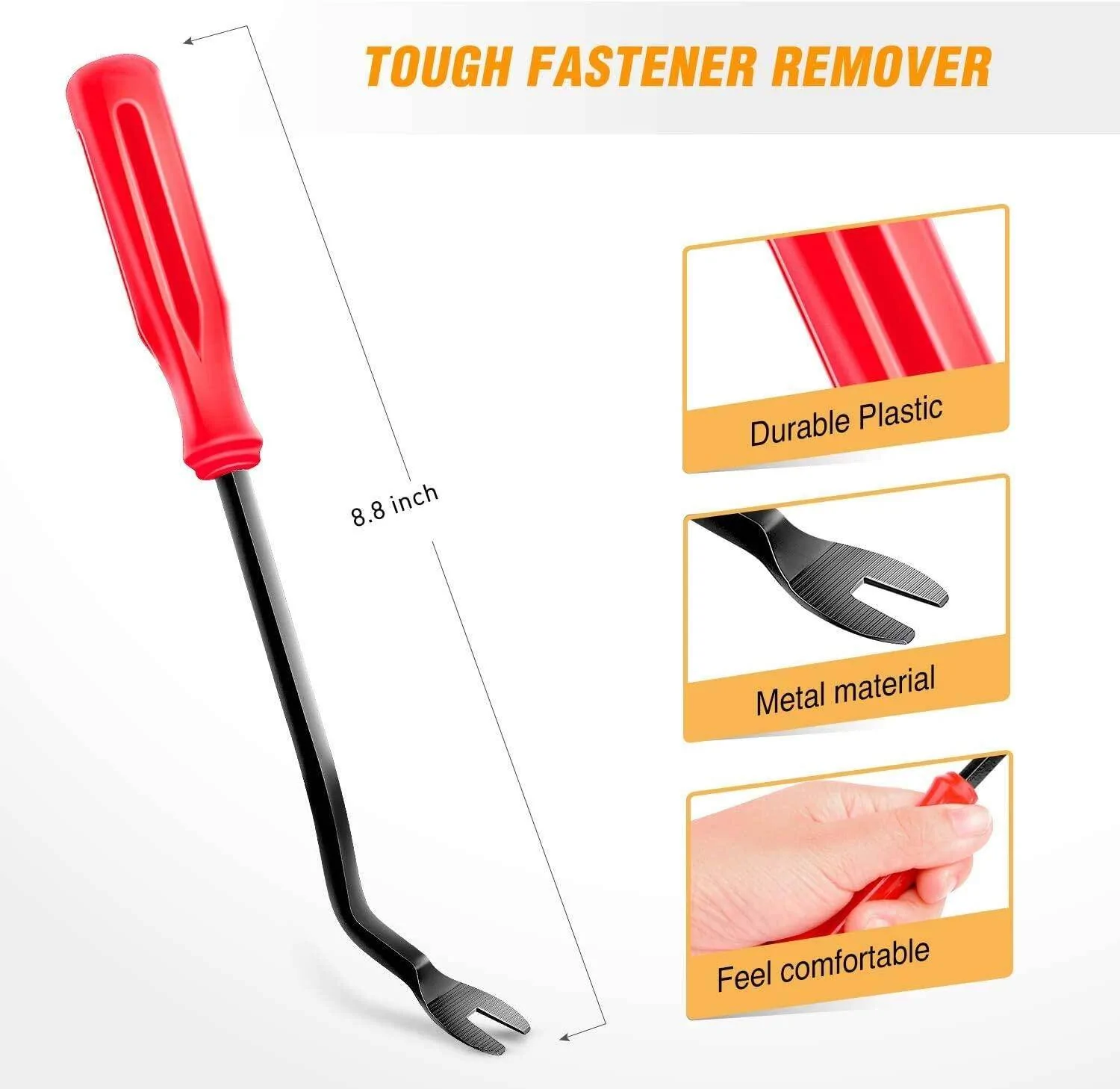

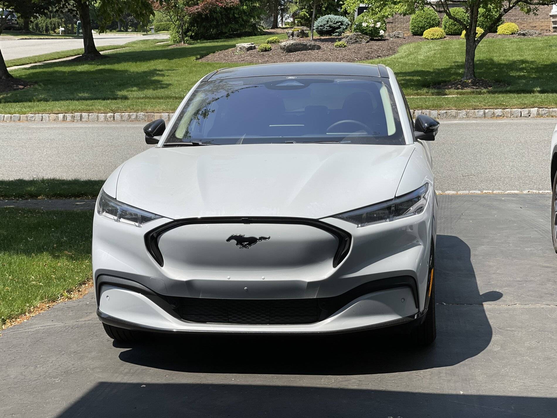

I used 1/4" hole plugs from Home Depot that are $.89/pair and some touch up paint/clear coat. Perfect fit without having to make the holes any bigger than they already were. To remove the plate bracket I used a fastener removal tool like this. A couple of the fasters broke but I'm not brave enough to go near my car's front bumper with a drill. Also including a photo of the end result. Not the best photo but the color match is great and they look factory. If they fall out, I bought extras and have plenty of touch up paint (nice to have regardless of this DIY project).
