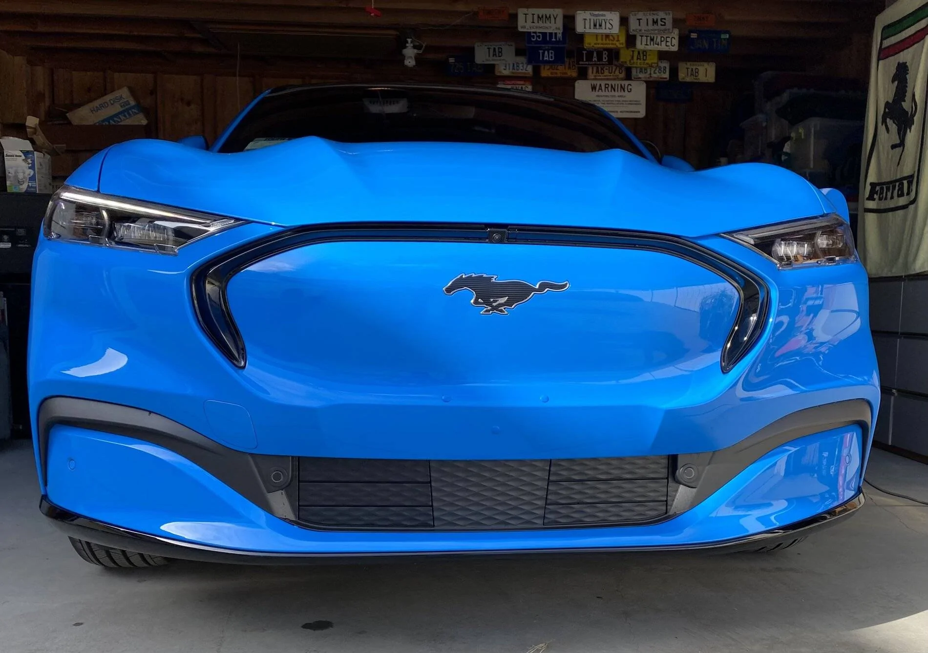

bumperplugs.com worked great on my Grabber Blue FE. Did not have to drill out the holes. Extremely happy with the plugs.
nice color match!
my Infinite blue is dark enough that black plugs are not TOO bad
Looks fantastic. I'll be getting those for my Rapid Red since the dealer told me no what they tried, Ford is shipping them to NJ with front brackets installed.

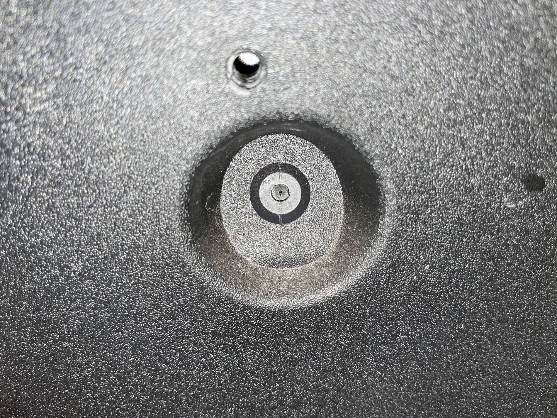

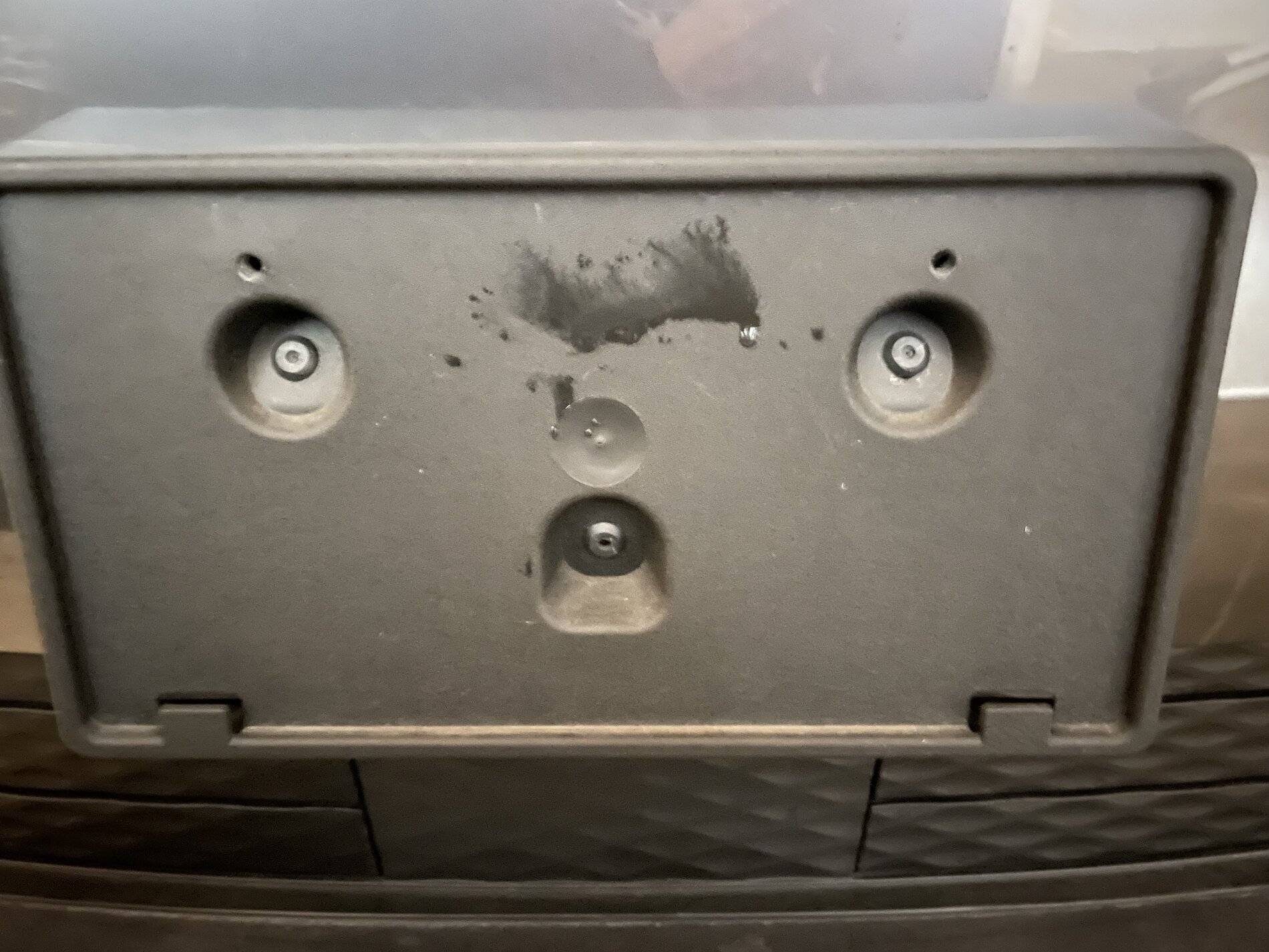

Ok....the more I thought about how a rivet works......you should be able to push the pin of the rivet through the back and remove rivets.....these rivets were not easy to push so I used a heat gun for about 15 seconds and bingo....
Lost 2 of the pins behind the bumper but imagine they will find their way out down the road.
All set for XPEL install next week
