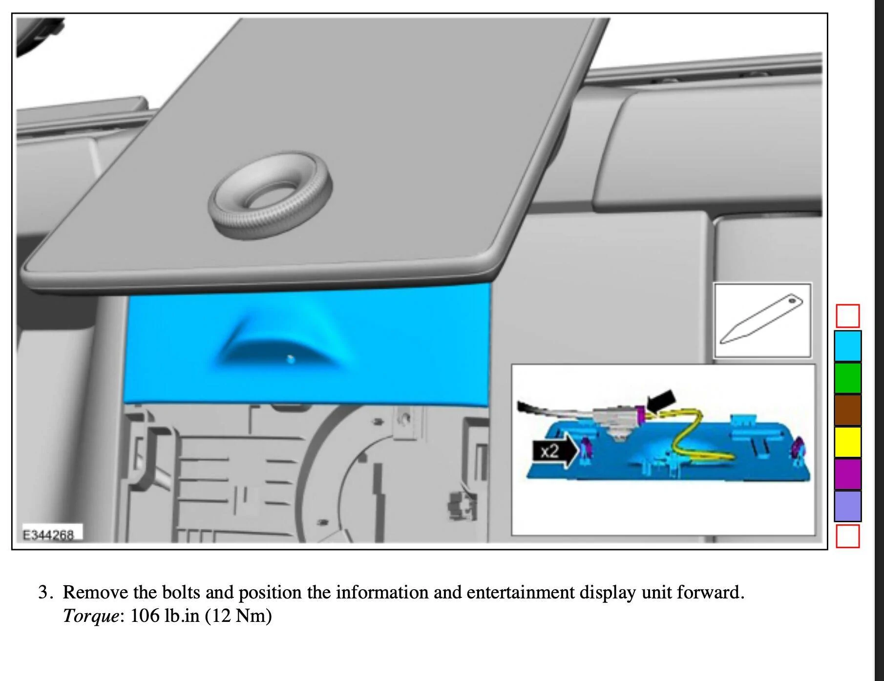

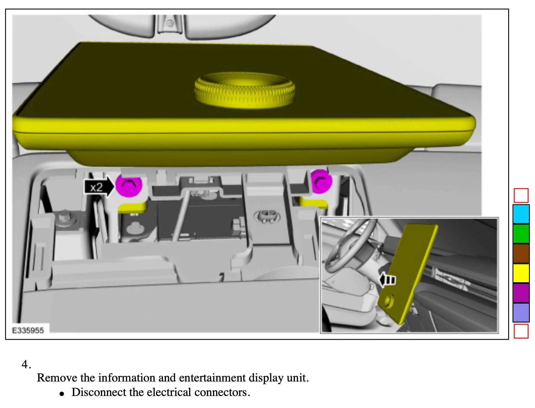

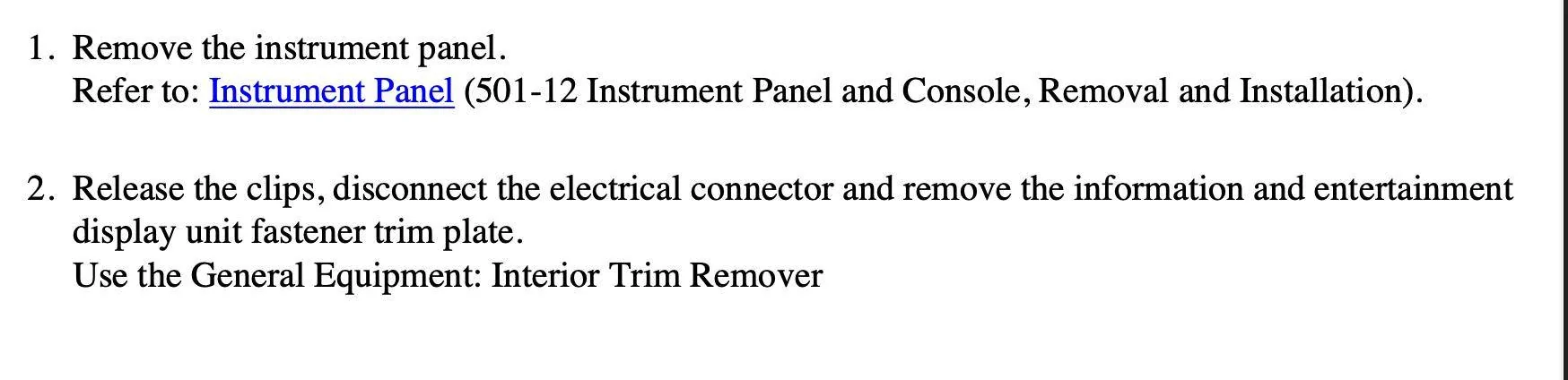

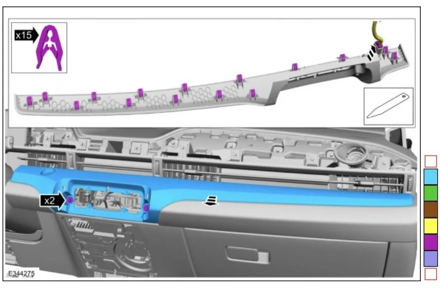

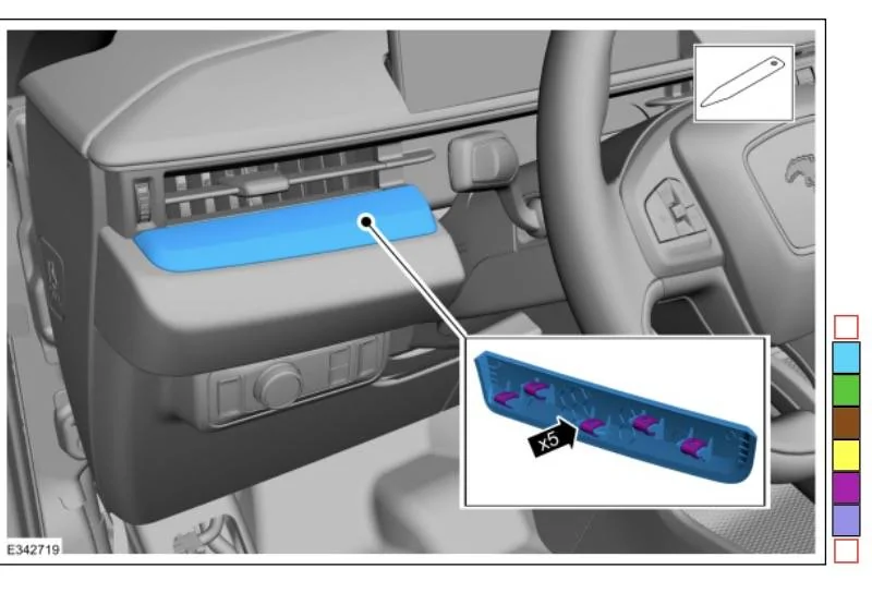

I'm trying to remove the trim piece so I can wrap it, but it looks like it might be bolted down behind the screen. Has anyone done this before? Or perhaps have a copy of the official service manual with instructions on removing the screen and trim piece? Thanks!
