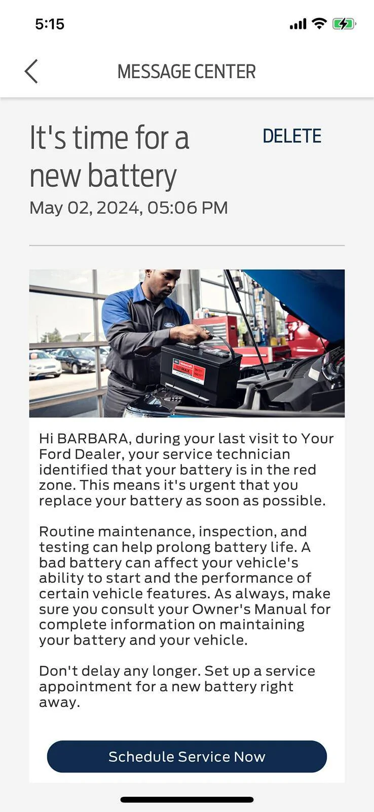

I got this message from ford psss today. Last time st dealer was February for HVBJB. Car is 2 years old I’m on S florida. No garage so have I been in red for 3 months?? Advise please

If your car is only 2-yrs old, then I think a failing 12V would fall under the 3-yr warranty (unless you're over on miles)? Ask your dealer if its covered under warranty and if yes, then do it.
In my experience, the 12V batteries all seem to have about the same lifetime -- 3yrs is short and 5yrs is exceptionally long. In a warm climate, I don't know why it would be near failure after only 2-yrs.

I’d follow the maker’s and dealer’s recommendations and have it changed, under warranty if possible, if not I’d pay for it (mine if required, not yours?).
They’re not expensive.
Your experience proves the value of taking car in for its routine servicing on time & other recommended maintenance, I’d ignore all the claims of “all they do on a service is swap tyres around & change cabin filter.
They check things like the battery, go underneath for an expert examination and do safety & general checks-it’s a preventative thing and worth every penny ??

Only have 8500 miles was planing a 200 mile trip this Sunday for 2 days Hotel has charger so can keep it plugged in. Or take husband ice

There is no indication in the vehicle data that the 12V battery is bad. It does not need replacement at this time. I'm not sure why that message was triggered, but it could be dealer fundraising.

Thank you. Was hoping from a reply from you. Would you drive to car from miami to cocoa beach without worries? Also should I charge up L1 or L2 before trip or doesn’t matter. Thanks again !
