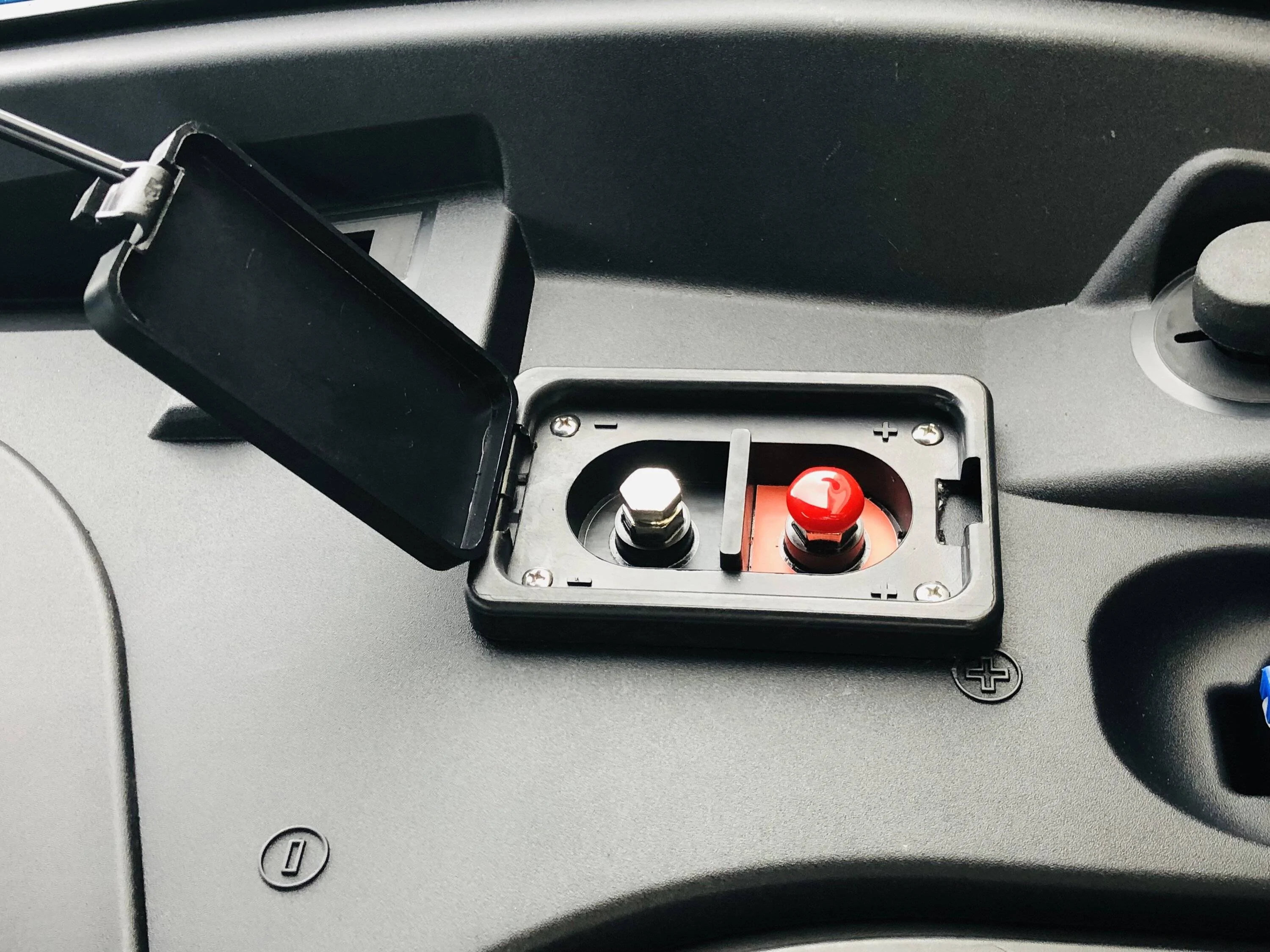

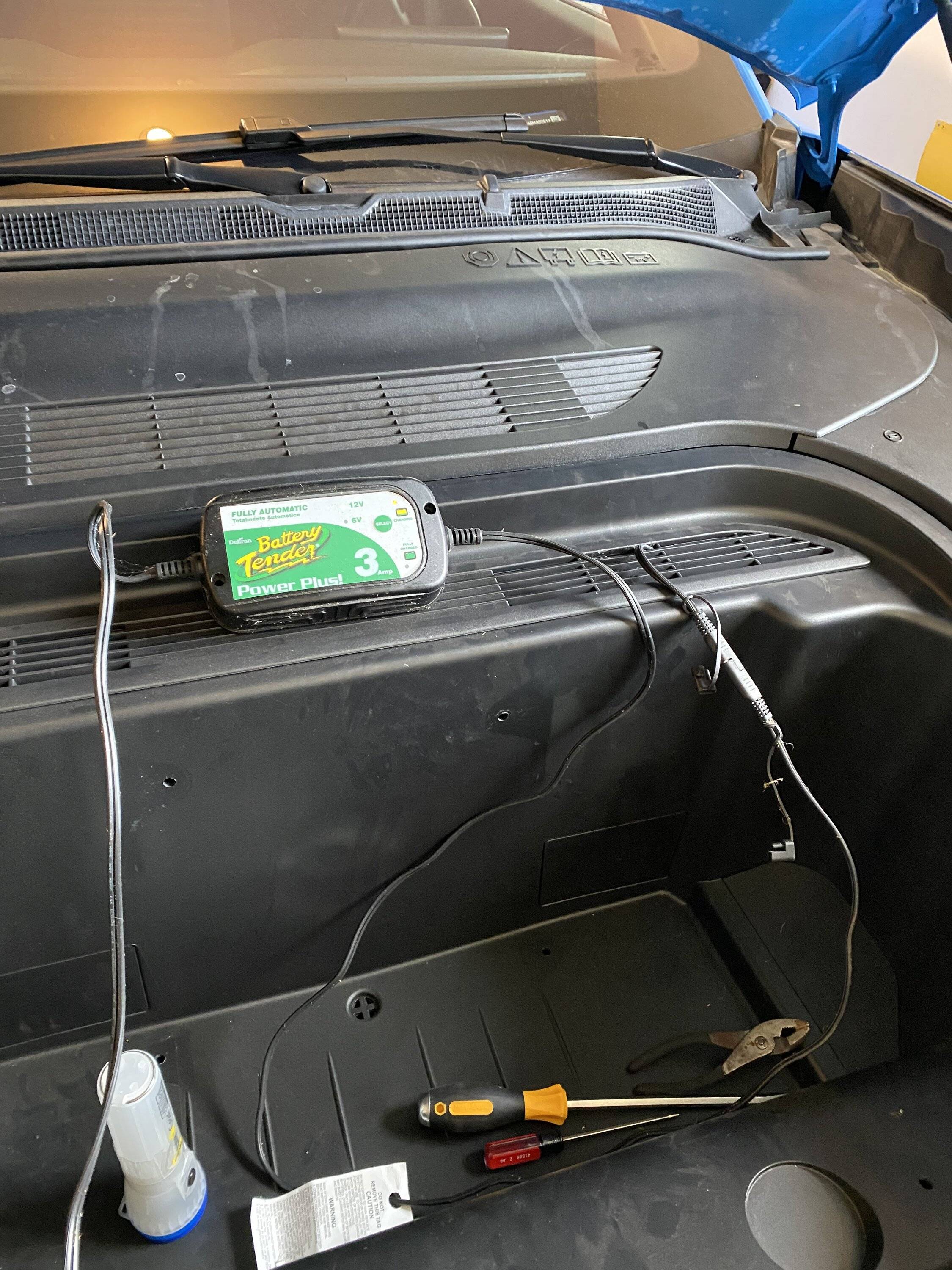

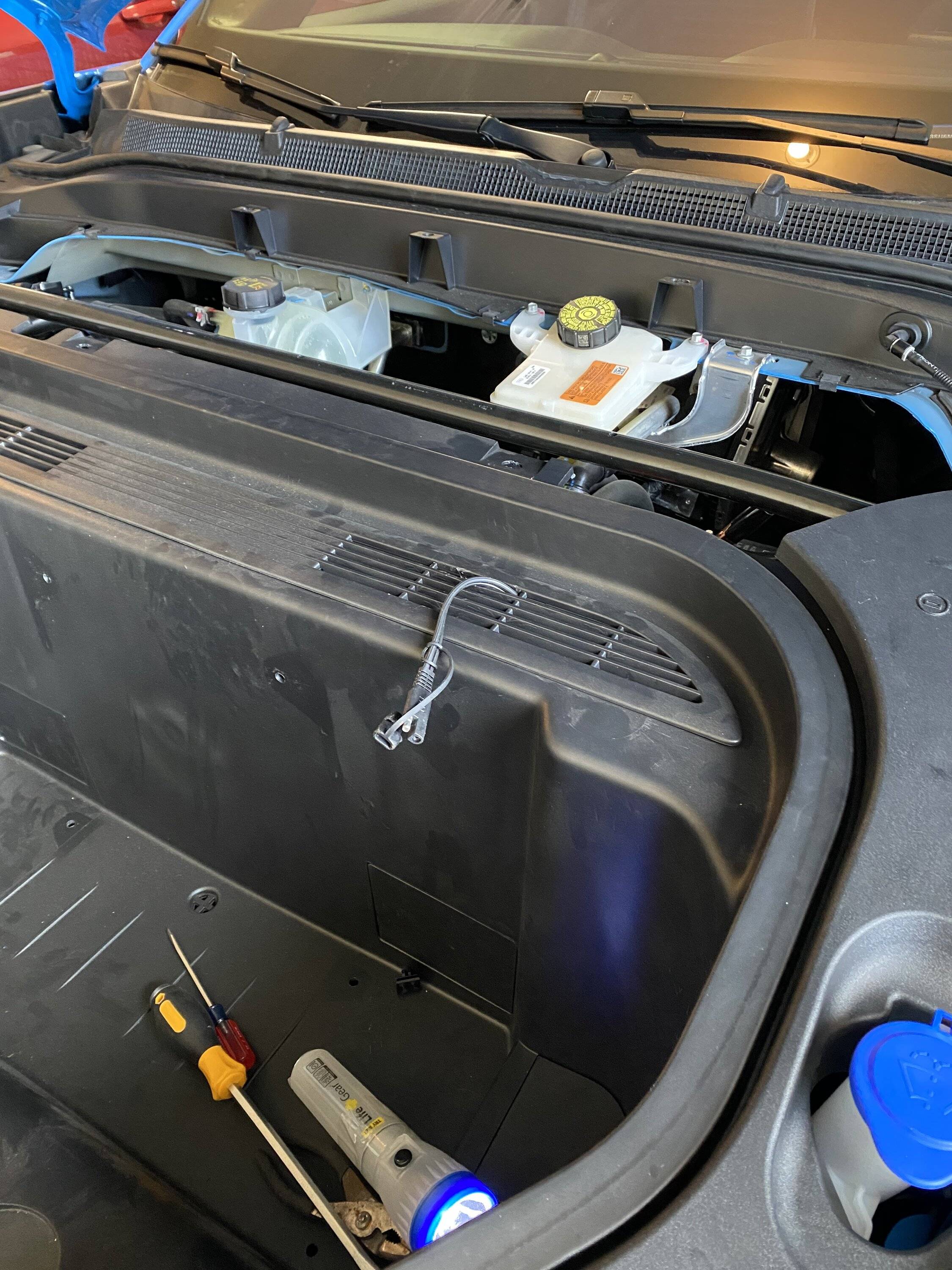

There are several safe methods. The cheapest is the two holes and furniture plug method. There is also the method @markboris used in placing a bulkhead connector inside the charge port. There's also the much more expensive route that I took (but it's really intended for doing FDRS updates, not trickle charging): ??
Although I like your approach more, my approach from early 2021 was easy and free…
