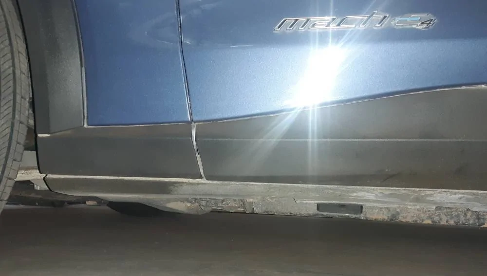

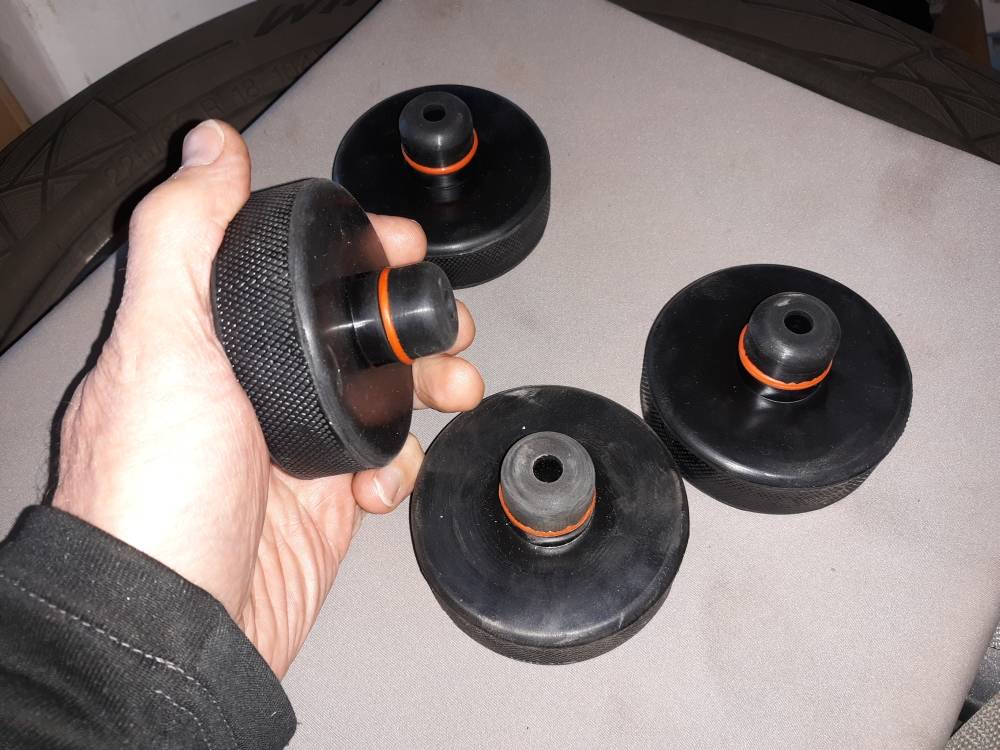

Since Ford does not provide Jack lift pads, and the average DIY mechanic and/or tire shop is quite likely to position their Lift pads on the battery rails with potentially disastrous results if the aluminum rails are crushed... I thought I'd look around for something more elegant than a piece of 2x4 that could be installed in CORRECT lift points.
I found nothing for the Mach-e online, but I did find lift pads for the Tesla x,y,etc $20 for a set of 4
https://www.amazon.com/dp/B09NRLZNRK?

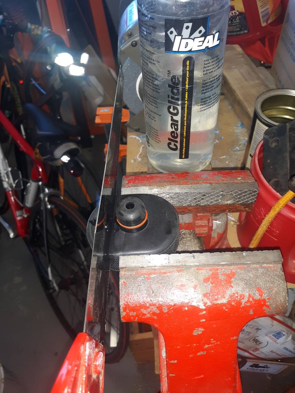

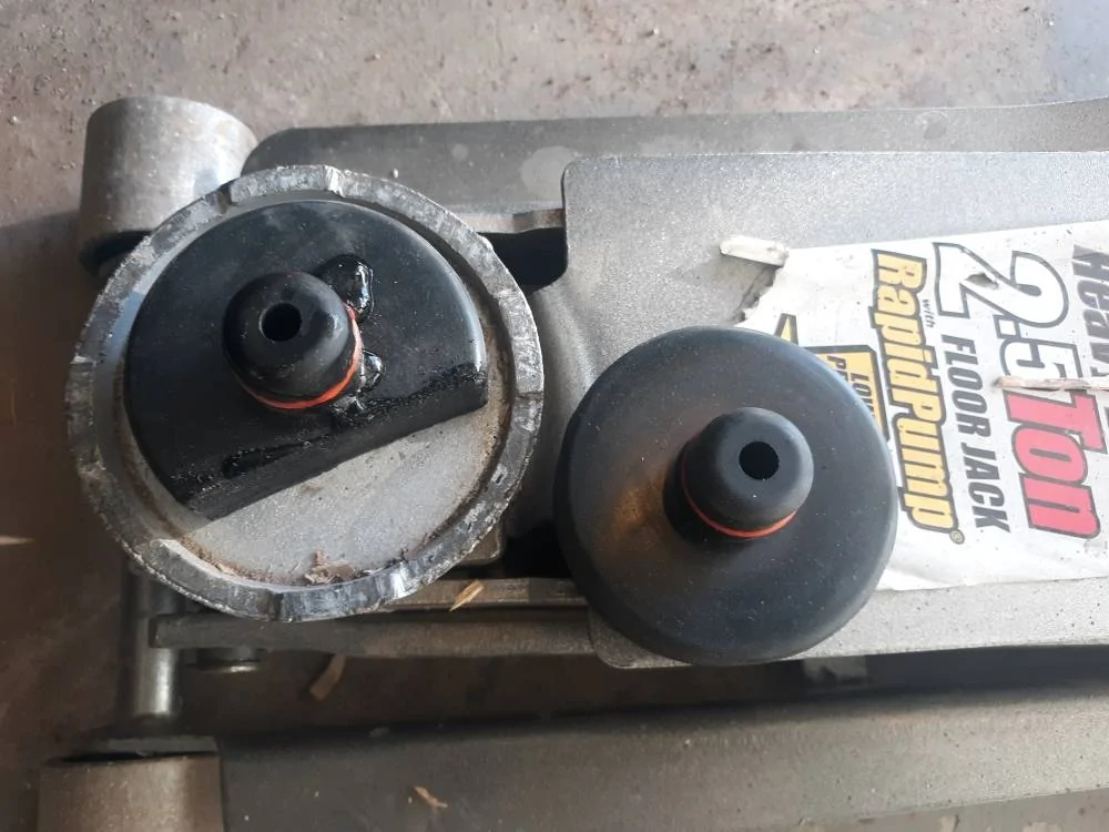

turns out however that they interfere with the lower molding on Mach-e, and need a little trim to fit well. Here's the pix of the stock lift pads, how I trimmed them, and the end result.... which I hope is obvious if anyone by me lifts the car.
---- post install update ----

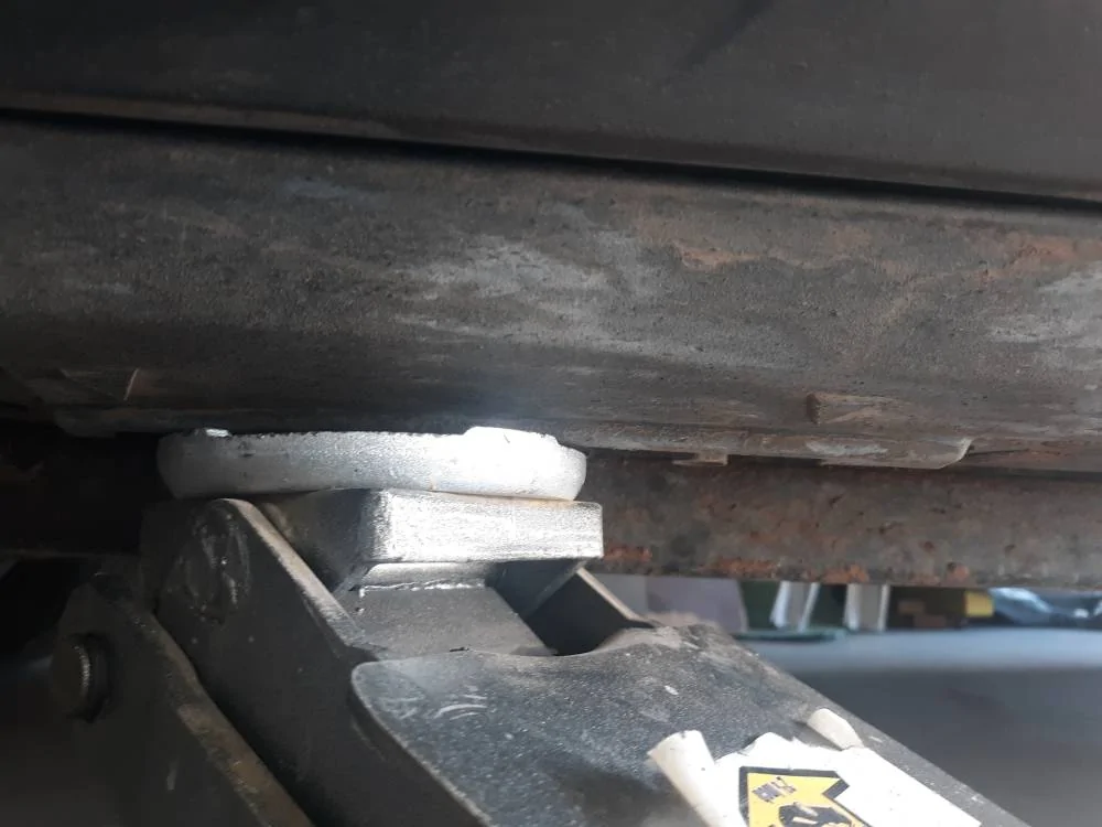

after initial 'install' when I lifted all 4 corners to swap all-season with winter snows, the lift pads are hanging in there with no additional expansion bolts or screw or anything. The rubber nubs on the pads apparently are soft enough to deform on install, and bulge a bit inside the rail after installed.
so..... works great, and makes it much easier to locate the jack correctly before lifting!

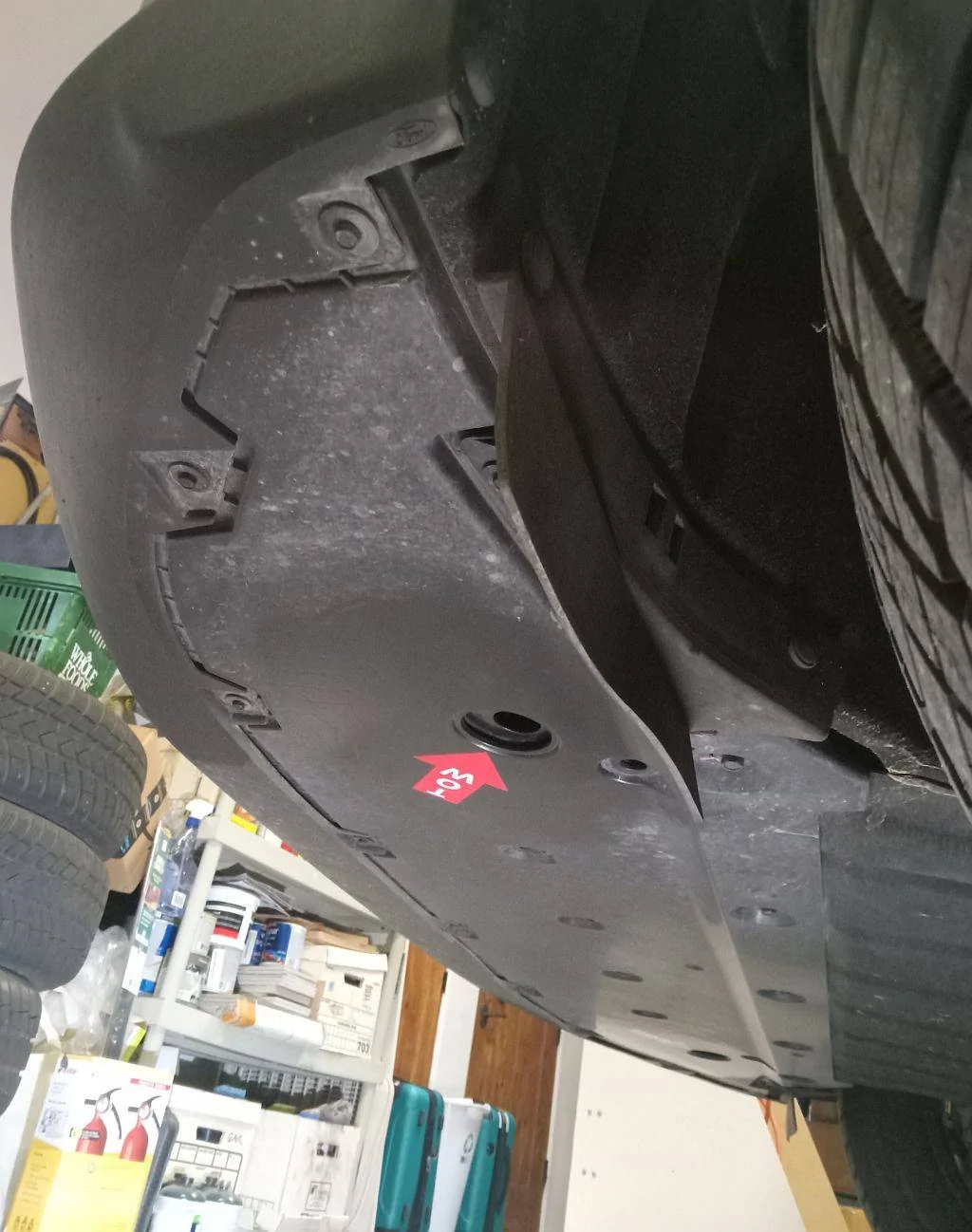

and as long as I was there, I added TOW stickers at the front locations.
