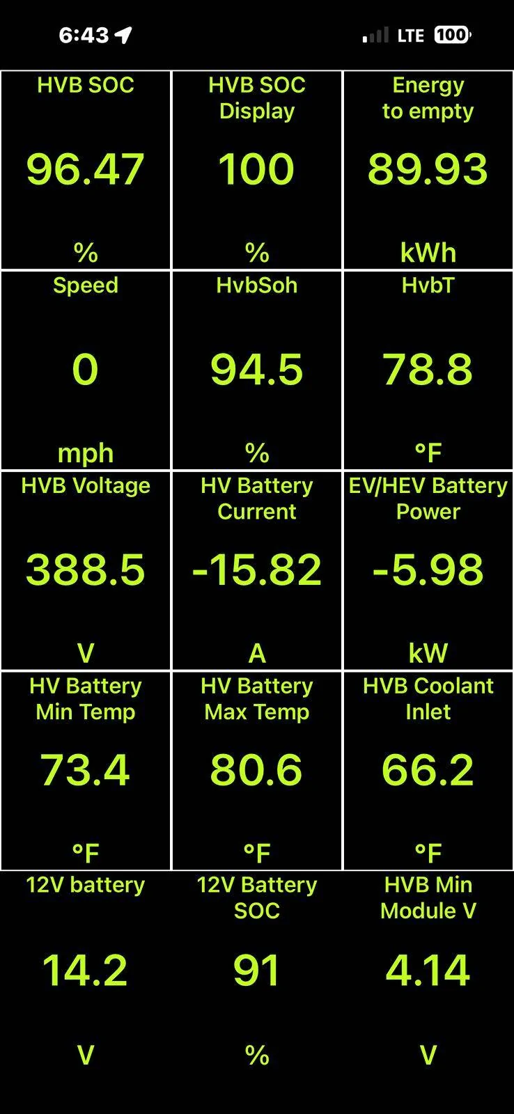

Just did this. 21 GT 33,000 miles. Nov 23 SOH showed 100%. at 28,000 miles. This week SOH shows 94.5%. Let it rest 6 hours 71 degrees in garage. Took 10.5 hours to charge from 10-100%. Range of Ford Pass now shows 267 miles. Still waiting on final rest before checking SOH. Very seldom used DC fast chg and run between 50-80% levels. Never down to 20%. Thanks for the instructions on how to do this.

What got me curious was after two years the battery was still 100% so I figured gee we were doing pretty good with not over doing the charging. Then 7 months later we are down 5.5%. Then saw posts about OTA updates may be the cause. But Lee’s post interested me so I tried it. Not sure what to make any of this other than it made sense to me.
No change in SOH. Interesting.

More interesting if you divide 89.93/91 equals 98.8 which equates to the GOM drop from 270 mile range to 266 range now showing.

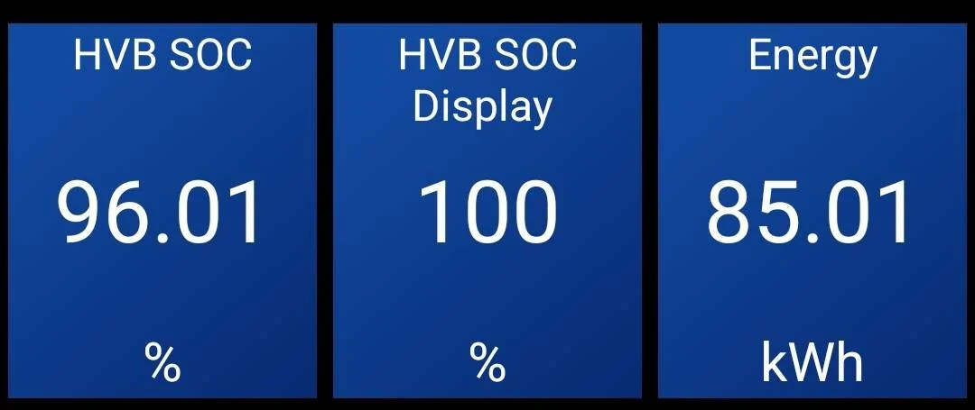

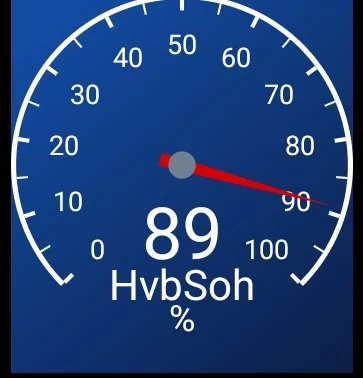

I did the calibration, because I had a very low SOH at 88,5 after only 23563 km (14631 miles)
I brought the car to 5% SOC Display. In CarScanner I had 9,5% HVB SOC.
When I started charing something weird happened. The Display SOC jumped to 10% after one minute of charging.
During the last 1% from 99% to 100% my charger was still delivering 11 kWh during 30 minutes. This is approx 5kWh added (should be more than 5 % battery capacity) after that charging power went down and kept slowly charging for an extra hour. After that the car stopped the charging (no blue leds at charging port)
In total my charger added 92,26 kWh during the session. For a charge from 5 till 100% including charging loss this is a very encouraging figure.
But when I read the data with car scanner I saw still 89% SOH, but also 100% SOC, 96% HVB SOC and only 85,01 kWh energy left.
If I had really only 89 SOH i would expect only 81 kWh left (91 - 11%)
Is there something wrong with the car, or is the SOH reported in car scanner not reliable.

Nothing is wrong, that’s just how those parameters work. You cannot run the battery all the way down to 0 kWh to empty, 0% will be like 2-3 kWh left.
The sudden jump from 5-10% when you started charging means the SoC was off that much. I suggest repeating the procedure again a second time to minimize that.

I did it again and now my SOH went up to 92%. That is still not what I expect after 27000 km. I have the same usage and experience as mkhuffman .
At 100% HVB Soc Display i have 84,85 kWh left. HVB Soc is than at 96,68%
But 1 second before display SOC is at 100%, the HVB Soc reaches 100% and then Energy left is 88,25 kWh
Where is that difference from 88,25 - 84,85 kWh = 3,4 kWh gone?

I have noticed that also. I think the reason the kWh drops after the charge finishes is due to the way the BMS does the estimate. It is not perfect, and an approximation anyway, I think. Doing the recalibration can help get the BMS a more accurate reading.
I may need to do the procedure again myself, although I charge to 100% every week or two. It seems that should keep the BMS accurate, but maybe not. The SoH of my battery is now showing 88.5%. Grrr.
