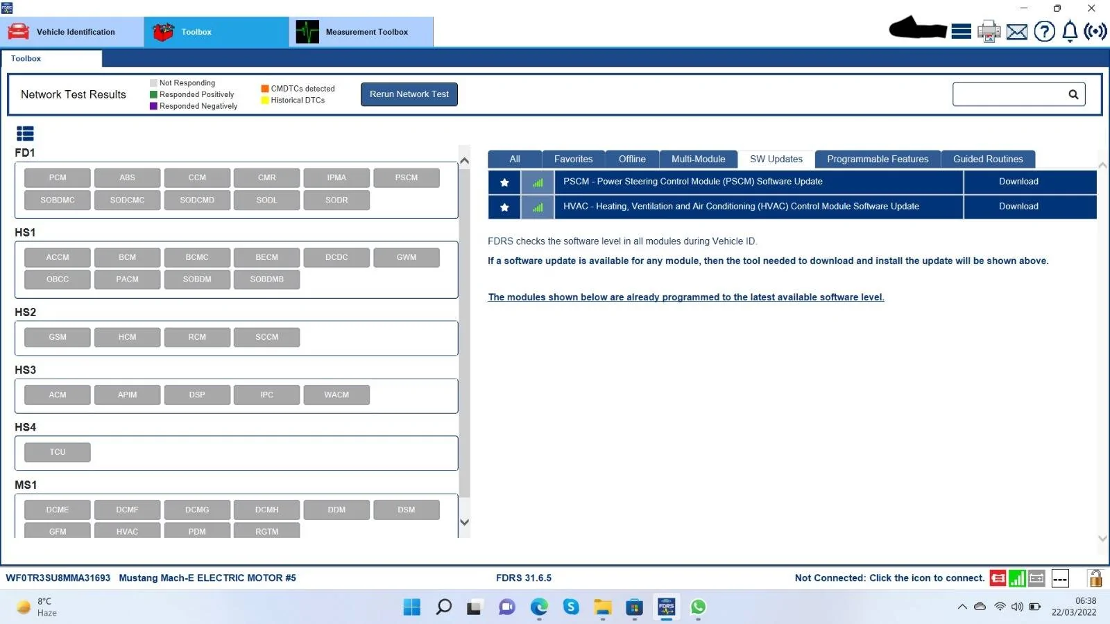

Hi Everyone,
Just to let you know that there is a new software update in FDRS for the HVAC / Heating, ventilation and AC
Any ideas what is the fix for ?
Walt.
what software is the screenshot from?
