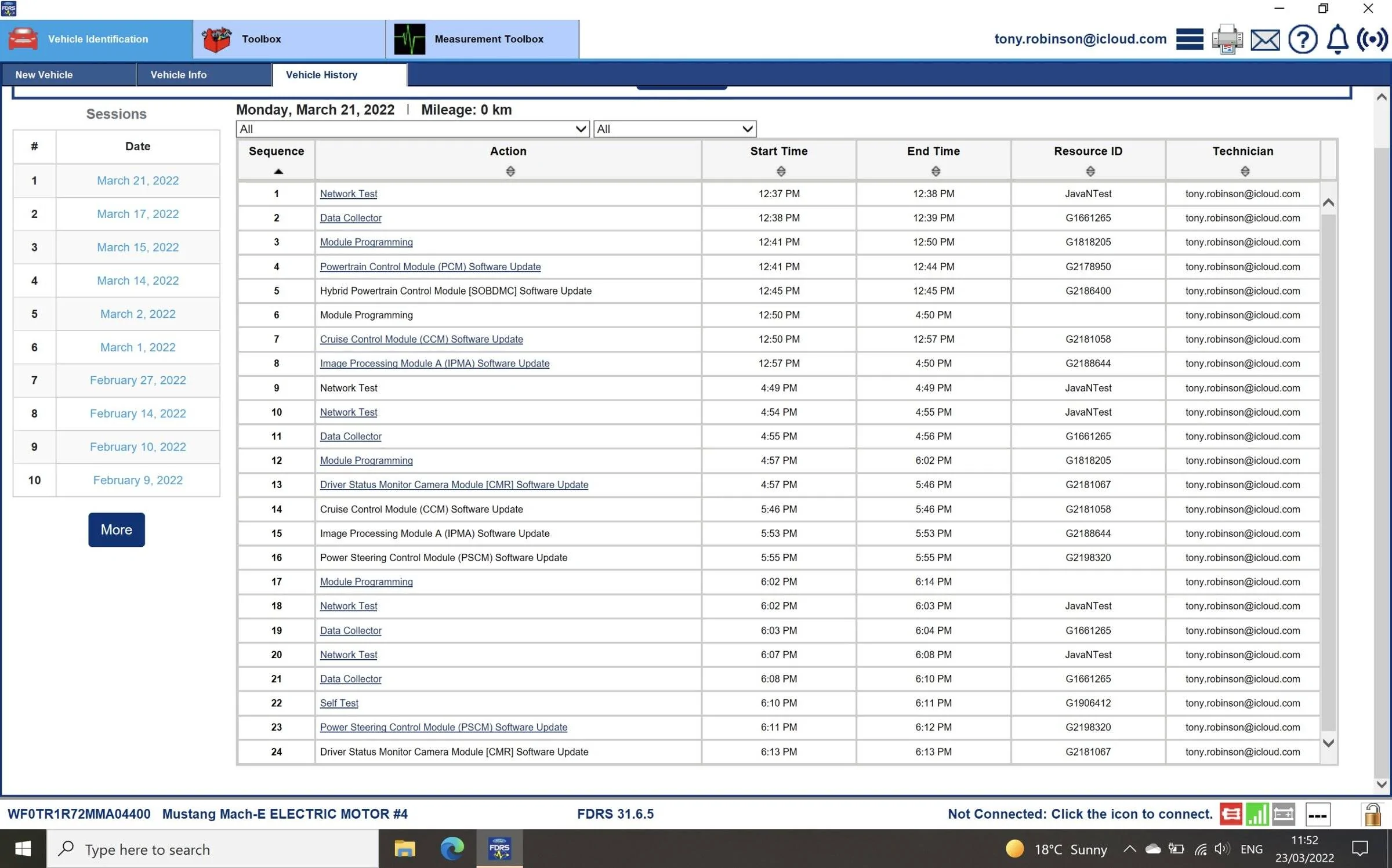

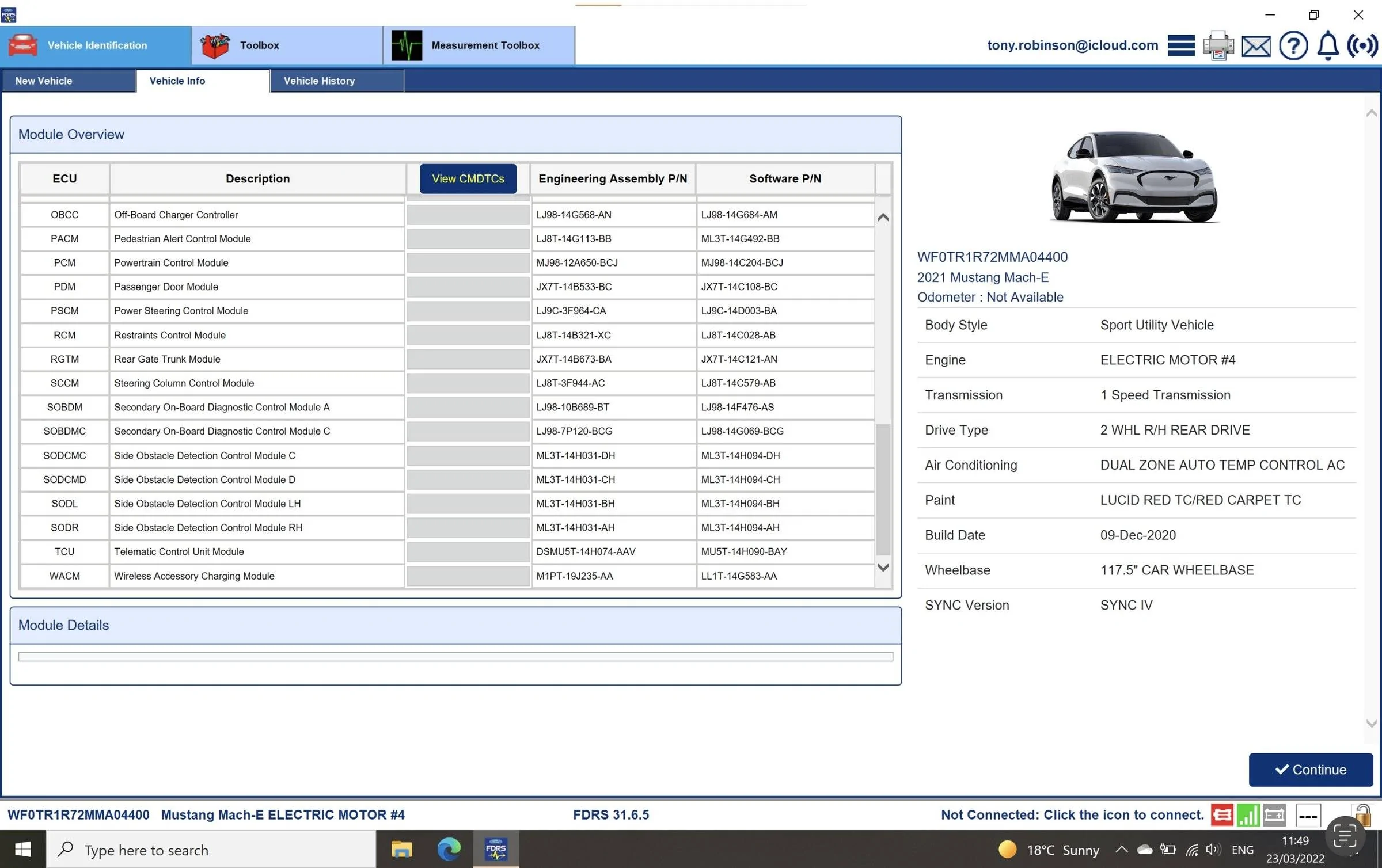

Here’s my current software version numbers and my FDRS activity report - can you check your PSCM and see if it’s at version LJ9C-14D003-BA as well?

No, mine is at LJ9C-14D003-AK. I wonder if its different if you have the bluecruise sensor or not. I dont...

Interesting in my History log, it shows under PSCM, "Vehicle Update" with the show button that shows nothing.
It did ask me to power the ignition about 4 times during the update?
Edit: All my actions appear under "Module Programming" for PSCM

Yeah it had me doing the hokey cokey with the ignition switch towards the end where it was updating this and that.
My neighbours think I’m nuts sat in the car for hours turning it on and off and on and off. ?

Just done another update of PSCM. Still not clearing. Software P/N is the same LJ9C-14D003-AK

I ran many updates on Monday and Tuesday including the HVAC update that appeared Monday evening while I was doing them. Everything cleared fine except for the PSCM, I reran it on different days and after disconnecting the battery, still there. Mine is also on LJ9C-14D003-AK, the car is a 2021 Premium AWD SR. I just had a 2 day license so it will stay as it is until next time.

Well we've got a mix of Standard Range and Extended Range vehicles with the same software code. So maybe it's an RWD / AWD thing.
PSCM Software version scores so far:
LJ9C-14D003-AK on 3 x AWD models
LJ9C-14D003-BA on 1 x RWD model
