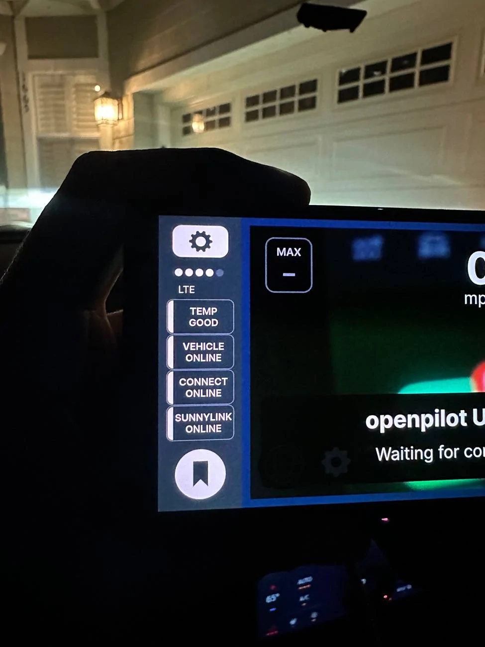

Message I get now after swapping the cable and I get the camera to show up

That error never goes away?
Click on the screen so the menu will come up, use the settings button in top left. On the first page of the menu is a "view error" button.
Usually that message clears after 10-15 seconds.

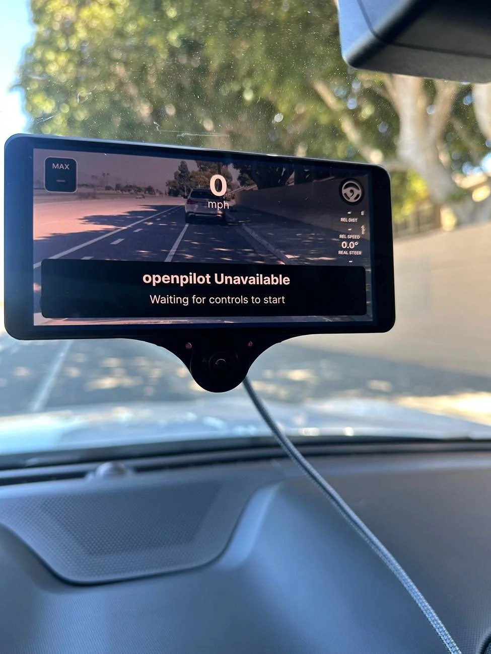

Went on a 5 min drive and never went away. I had an appointment and had to stop messing with it. Will try in about an hour or two
no luck?

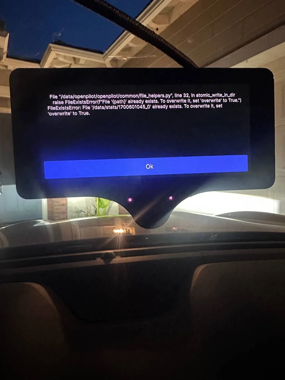

This is what's in the error log. Not sure where that overwrite setting is.

That’s new.
go into the “software” menu and uninstall, then reinstall. Seems to be corrupted.
bit.ly/bp-stable
for installer url

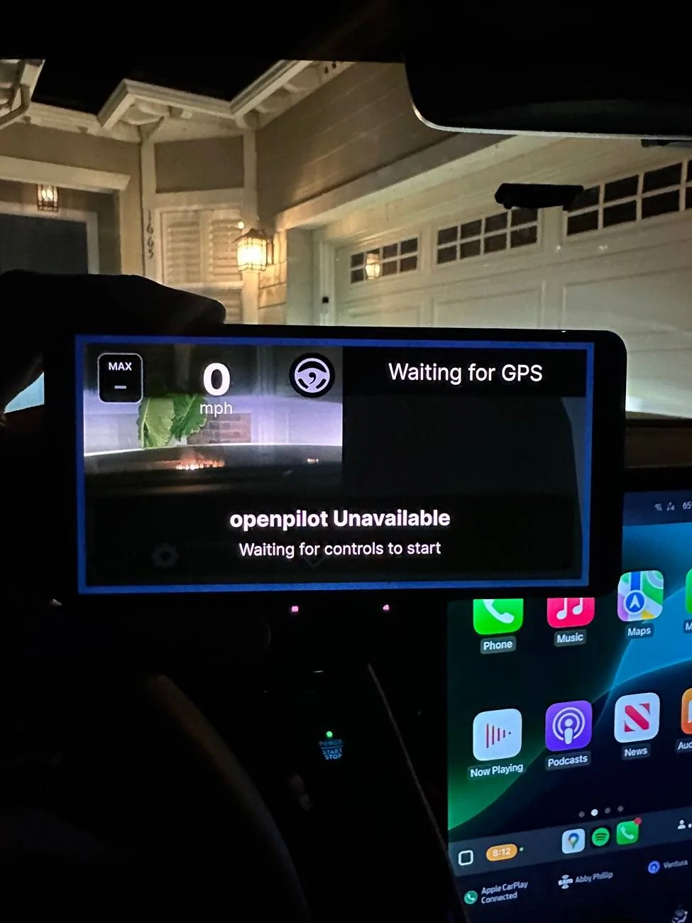

No error message, but that screen still won't go away. I do notice it never acquires GPS - Keeps showing waiting for GPS even after about 10 mins. Rebooted a couples times and took a drive still nothing.
what year is your car?
nvm, I figured out how to see it on Mobile.
I’ll send you a DM here in a bit with how to add me to your device so I can see diagnostics data.
