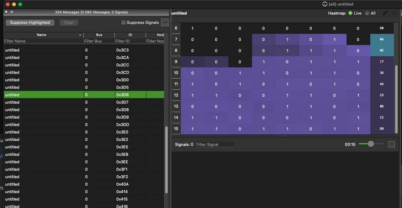

Someone hooked up to a 2025 MachE today. 16-byte Canbus Messages mean TRON encryption.
The 2025 Mach E does have CAN Message Authentication, openpilot and forks will not work on any 25 Mach Es or newer unless someone manages to find a way to extract the keys. That's probably going to be unlikely as Ford is probably requiring suppliers have the keys stored in the ECU's HSM.
We have suspected this for a while now, but this was the first time we actually got to log the canbus messages and verify it.
I could have confirmed that if I had been actively looking at the thread lol. I have second-hand knowledge as I know someone who's been working in the group at Ford that developed the CAN bus security.
