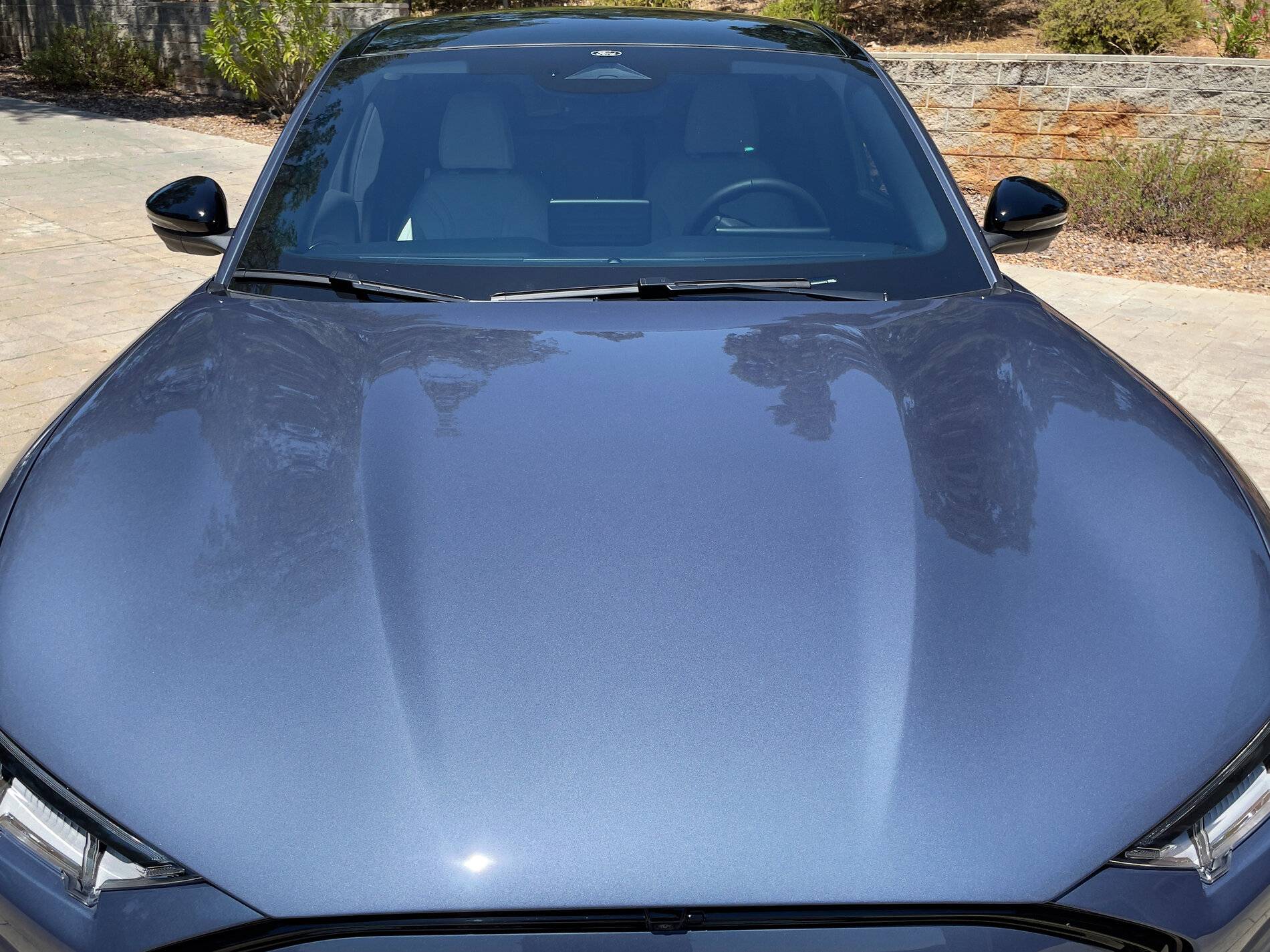

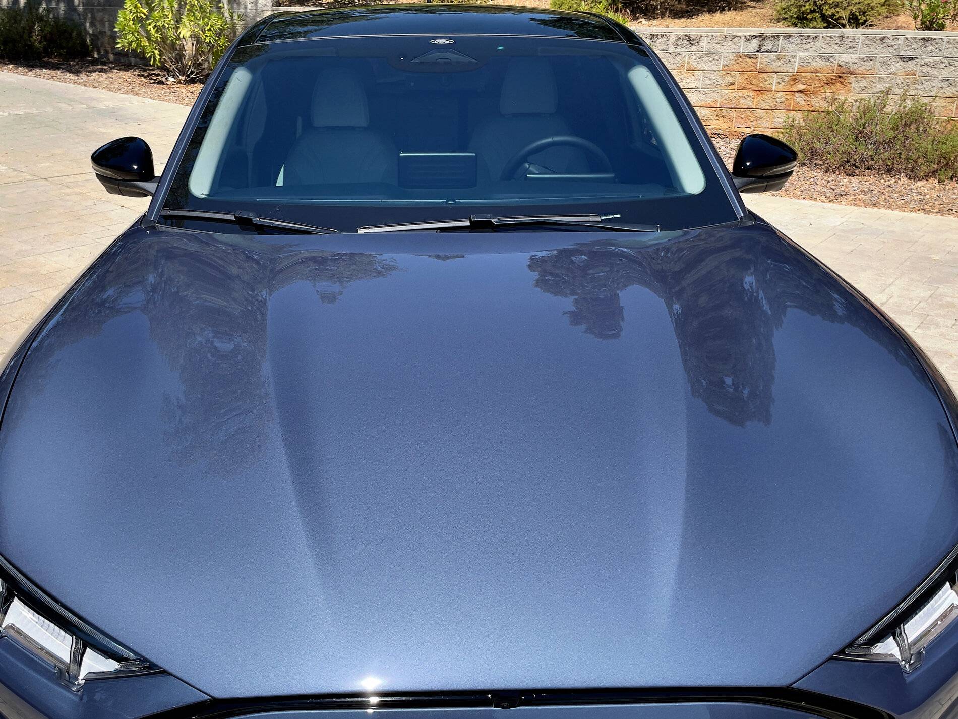

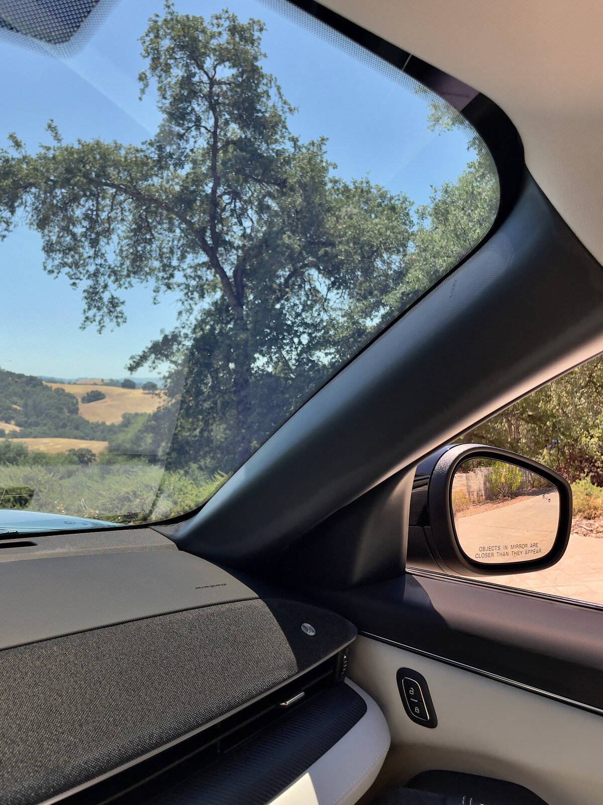

Finally got around to replacing the space gray A pillars with black ones. As I said here in an earlier post, the only reason I was replacing them is because of how awful they look from the outside of the car. The B and C pillars are black already and now with the A pillar black it looks better inside the car too. Also no glare on the inside of the windshield anymore.

They look great. How tricky was the swap? I’ve read the instructions from the service manual posted earlier, but I don’t really get it. They say to remove the tether clips first, but how do you get to them if they’re on the back side of the pillars?
How tricky was the swap? They took less than a minute to remove but are a pain going back in, about 5 minutes of getting it just right to snap in.
Because I was not going to use the space gray ones again, I did not go by the service manual. I grabbed the top of the pillar and pulled forward which easily released the two clips. Then I cut the tethered cord at the clips and pulled the pillar straight up out of the dash. Like I said, less than a minute. Now you have to remove the two clips that had the tethered cord on them which are on a support bracket next to the airbag. Just push on either side of the clip while holding tension on the side you first released and the clip falls out.
Installing the pillar is not so easy. It is a tight fit and everything has to line up perfectly. The new pillars come with tethered clips so no problem there. Installing the base of the pillar into the dash is the difficult issue. The defroster vent receiver in the pillar has to line up perfectly with the duct in the dash and it is not easy to do. Also there is a trim at the edge of the dash that has a protruding pin that has to fit into the bottom of the pillar. It is all kind of like a puzzle. Then there is the door seal that gets in the way and you have to work around that. Just takes a little time and patience but it is all back together and looks really good.
