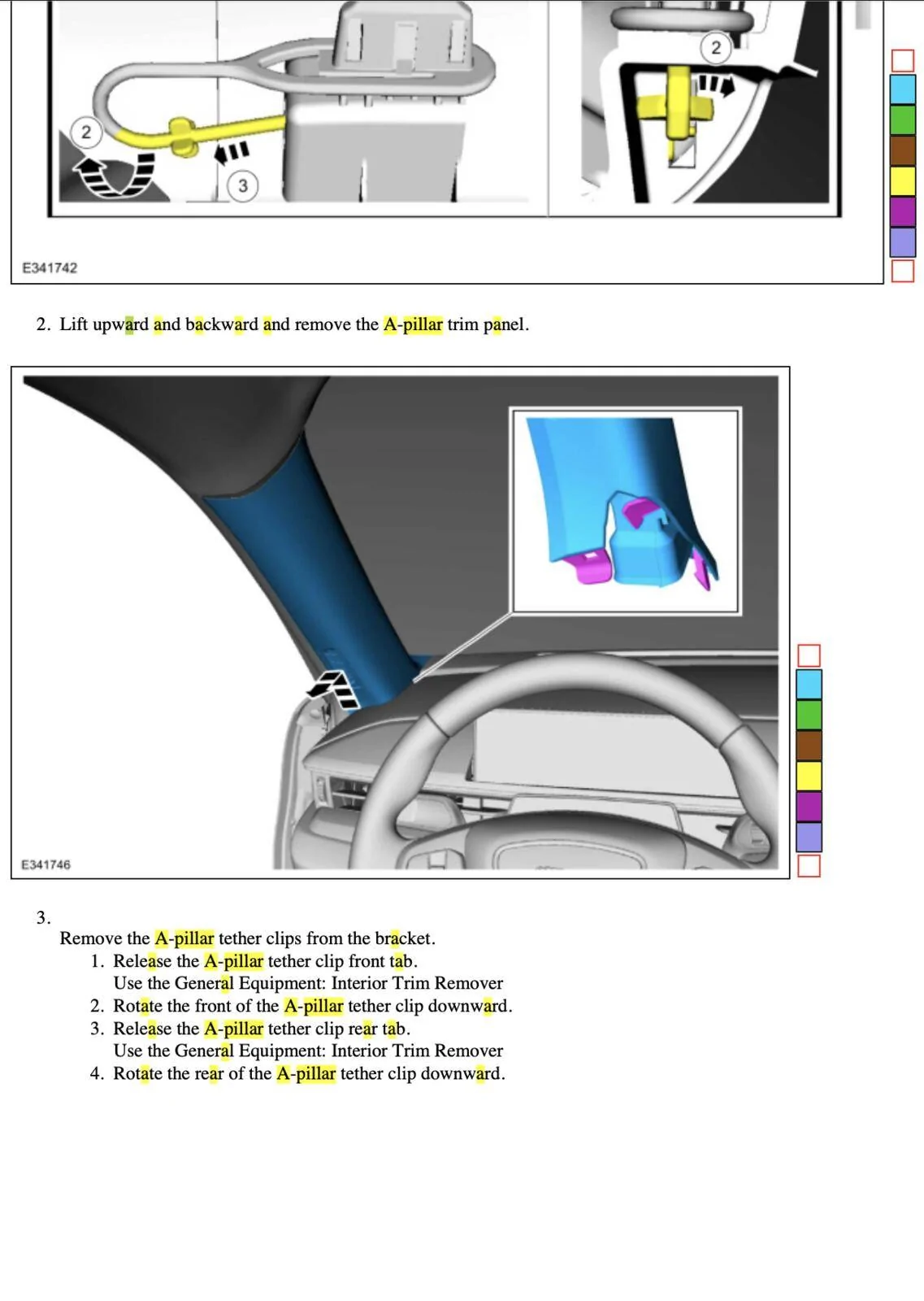

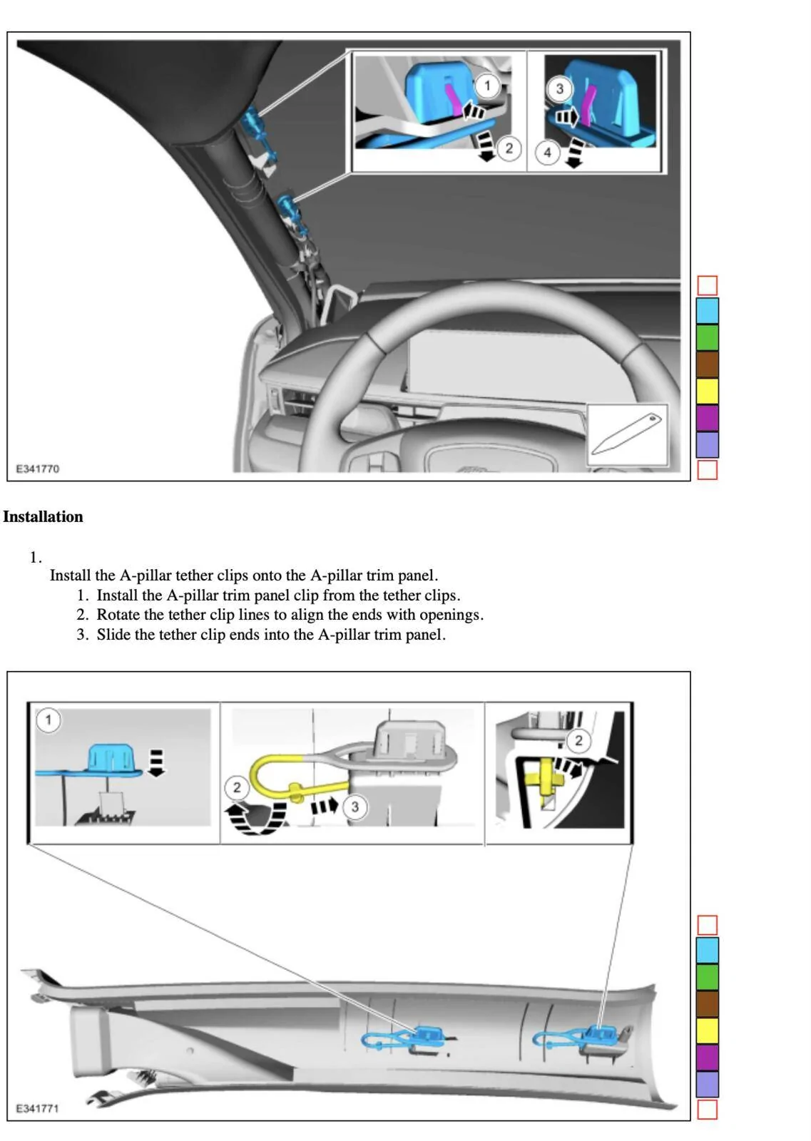

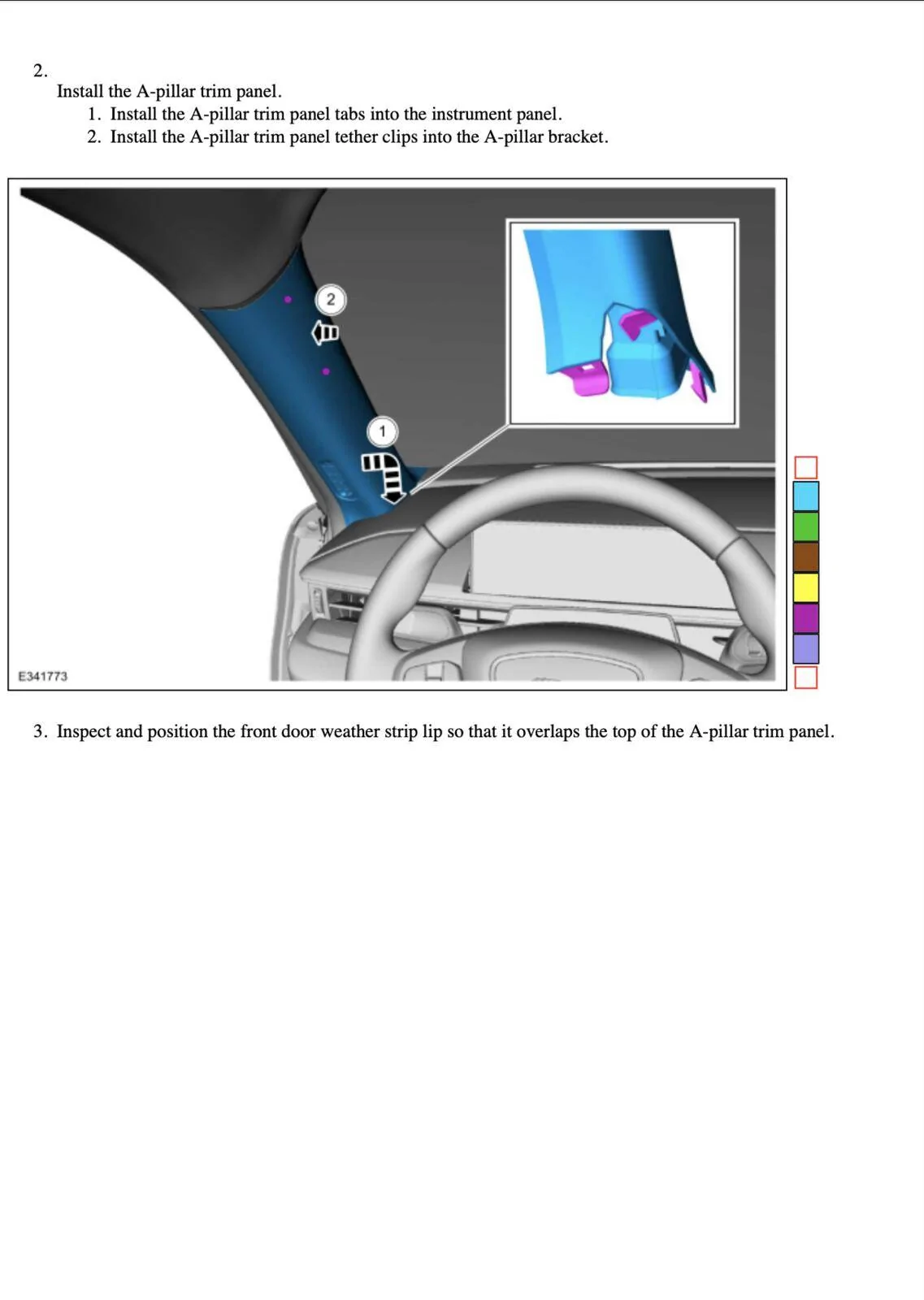

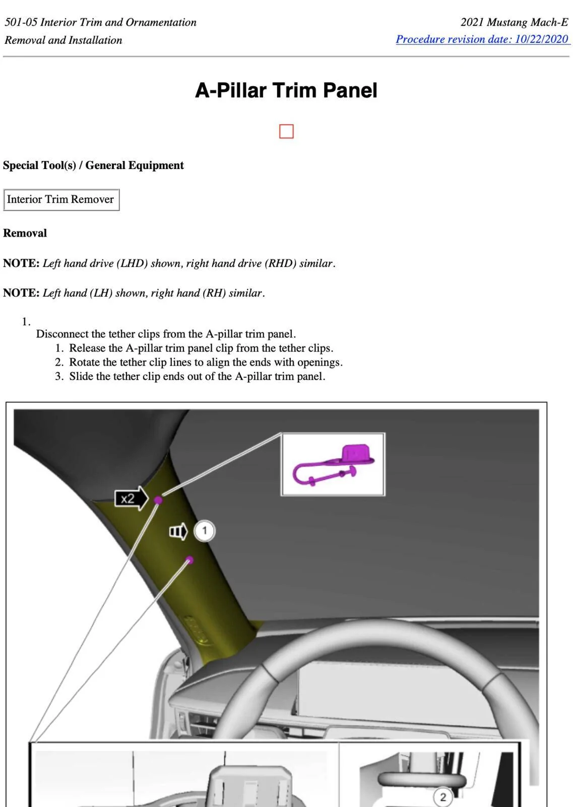

Yes, not too difficult at all. I have had them off on many other cars before. They are tricky getting back in at the bottom with those clips but you just need patience.
Thanks I was really struggling with this. When I read put the clips in first I thought it meant take the metal clips off and put them into the holes first ?.

I actually edited my post and removed when I said "not too difficult at all" because they can be a real PITA to install. I just helped another member install these a couple of months ago and it took longer for us to do this than it did to change out the front springs on his car. ?
