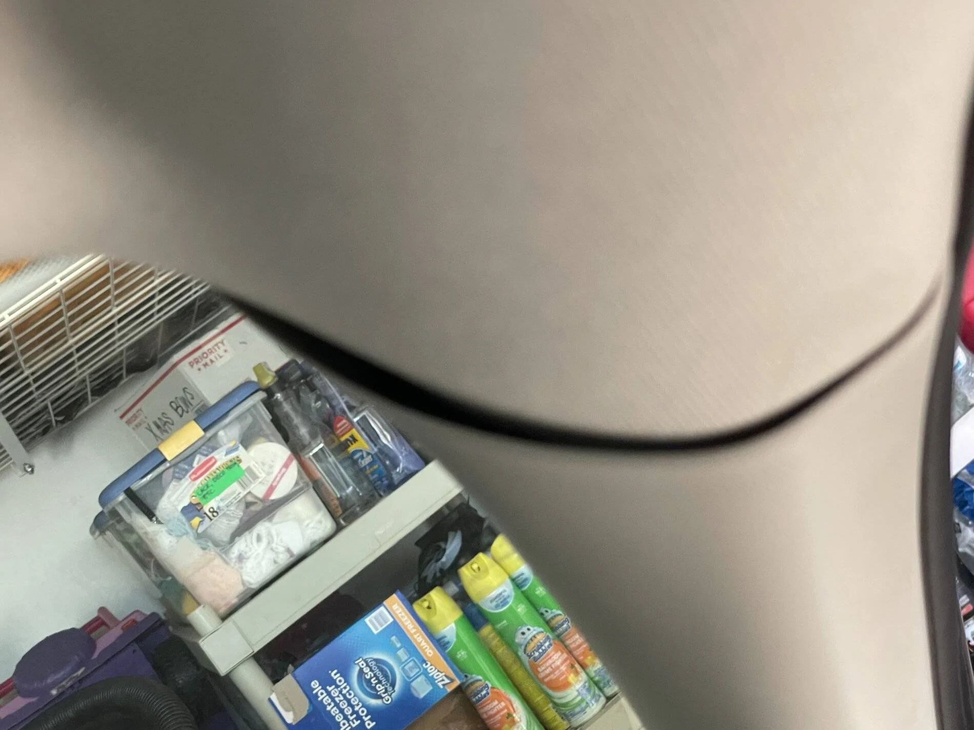

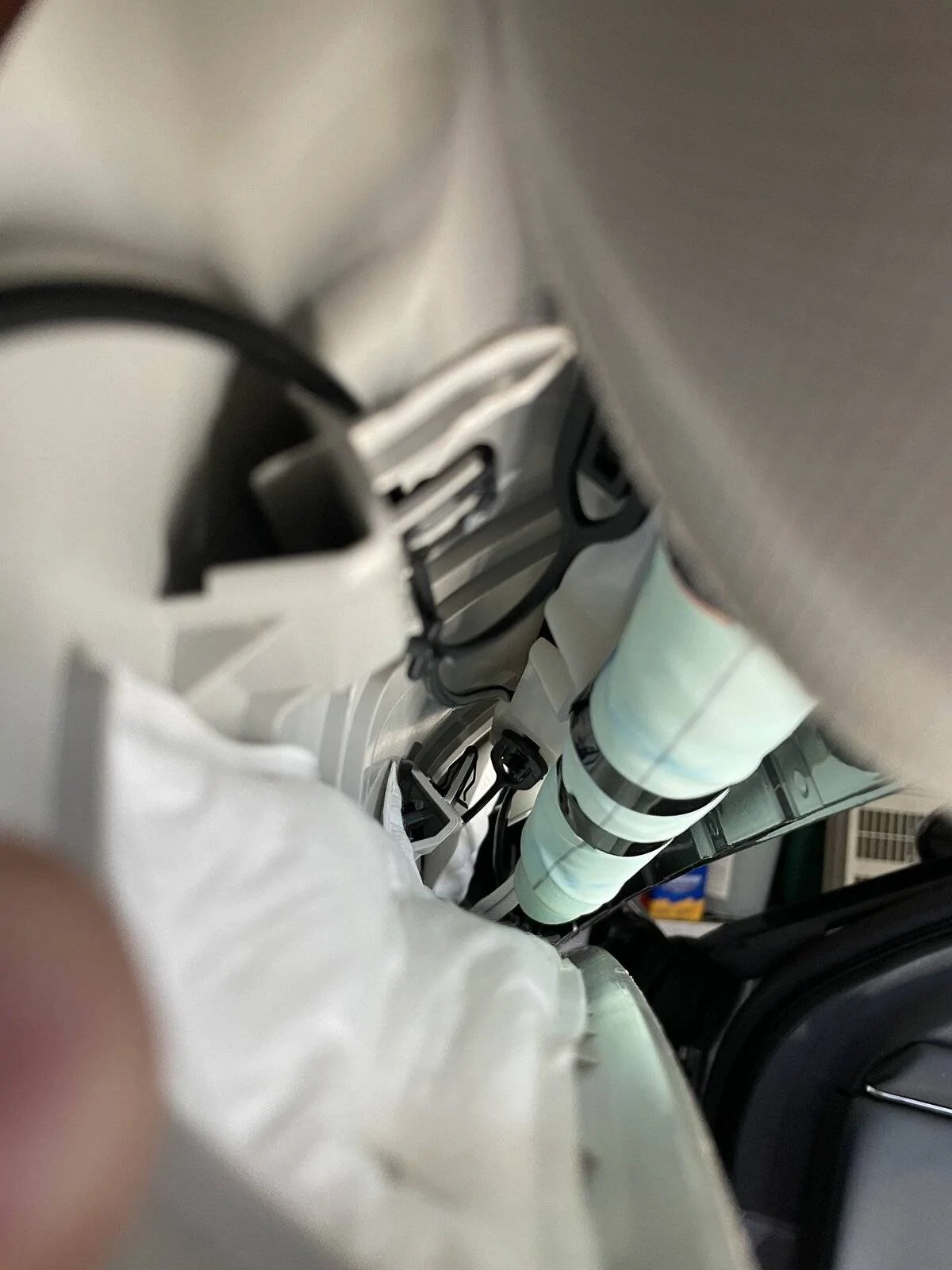

What in the world is the trick to get this dang A Pillar reattached!?!?!!
I only pulled off 2 clips thankfully, but I can’t for the life of time get them put back in.

Some what got it attached, but it’s not pulled snuggly like it should be. I’ve taken apart so many trims, and this one is a pain in the ass. The clips are flimsy as all hell and the attachment plates are just as flimsy.
Should had just pulled the seal and just dealt with trying to fish the wire behind.
It feels like the panel slid up a little, but I’ve pushed it down with a decent amount of force and it’s not even budged.

Make sure that the bottom of the trim, where the vent is, properly slid into the receptacle and that the trim piece along the right side (if on passenger side) is correctly aligned with the vertical trim piece as in my 3rd picture in the link I posted.
The newer A-Pillar trims are a PITA because they are 2 stage. During an airbag deployment the trim is supposed to release enough to allow the bag to fill the cabin without slingshotting the trim into someone's face. This makes those clips much more difficult to work with. Almost all modern cars that I've worked on are much more difficult now vs those of years past without A pillar airbags.

Take the clips off of the A pillar and attach them first to the trim, then attach the trim to the pillar.
See my comment on this issue here: https://www.macheforum.com/site/thr...a-dashcam-and-radar-detector.5542/post-262345
And the post here: https://www.macheforum.com/site/thr...-dashcam-and-radar-detector.5542/#post-157999
BTW there's only 2 clips and as I mentioned it's best to remove the trim entirely instead of just trying to get wires/whatever behind it.
Was still a little of a pain in the butt, but that did the trick, panel is now up and looking the way it should! Thanks!!
