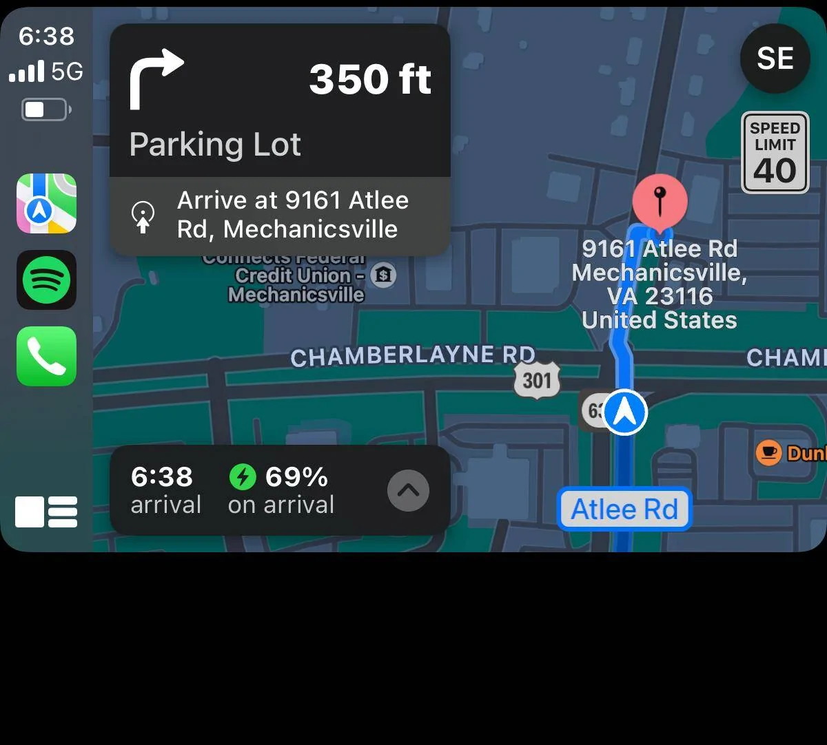

Updated to iOS 16 last night, found that CarPlay connected normally, but it lost connection to the Mach-e to get the battery level. Decided to repair to the car (deleted phone from car and deleted car from phone). Could not delete the iPhone from Sync until after I rebooted Sync (steering wheel, Volume Down + Next/Right Track Advance).
once I re-paire the phone, all worked swimmingly.
[EDIT] Issue Occurred again, you will notice that the arrival charge will begin climbing, and a few minutes later you will get the lost communications message. After that the arrival charge will keep climbing and Climbing..
[EDIT] Rebooted Sync to resolve loss of communications to current charge, not sure is it iPhone or Sync's issue. CarPlay Connects, Charge state comms is flaky.
notice it now shows charge on arrival.
Percent on arrival... love it.

It seems less than accurate.
Leaving the office it predicted a 75% arrival at home.
Part way home it adjusted to 74%. Makes sense, perhaps my miles per kwh was lower than estimated.
A couple miles or so from home it adjusted to 76%. Seemingly that makes sense, perhaps my miles per kwh was now higher than estimated.
The problem is the car was already at 75%.
I arrived home at 75% just as the estimate changed to 77%.

Had this happen to me twice on my drive from MA to NJ today. I left it for awhile hoping it would reconnect but never did. Found that if I ended the routing and restarted Maps would sync back up to my charge level.
Deleting PAAK and repairing seems like far too much work. I’ll wait for an iOS update to patch this problem.
