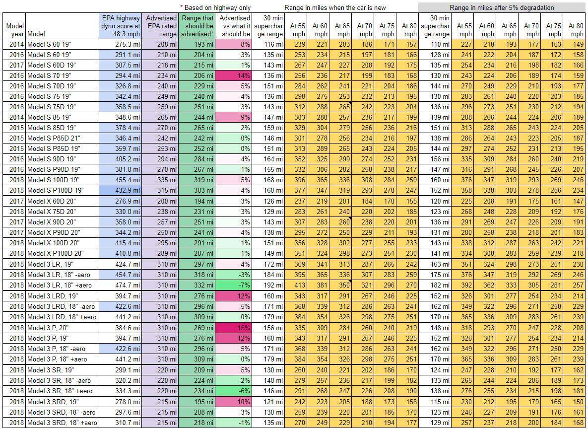

Looks like most of those are showing 18% less efficiency at 75 MPH vs 65 MPH. That's more consistent with what I've been reading. 40% sounded excessive.Look at the table below to see how you can increase range by slowing down. But if you absolutely have to drive at 75 mph even those few weeks a year that it is really cold than I guess BEV is not for you.
