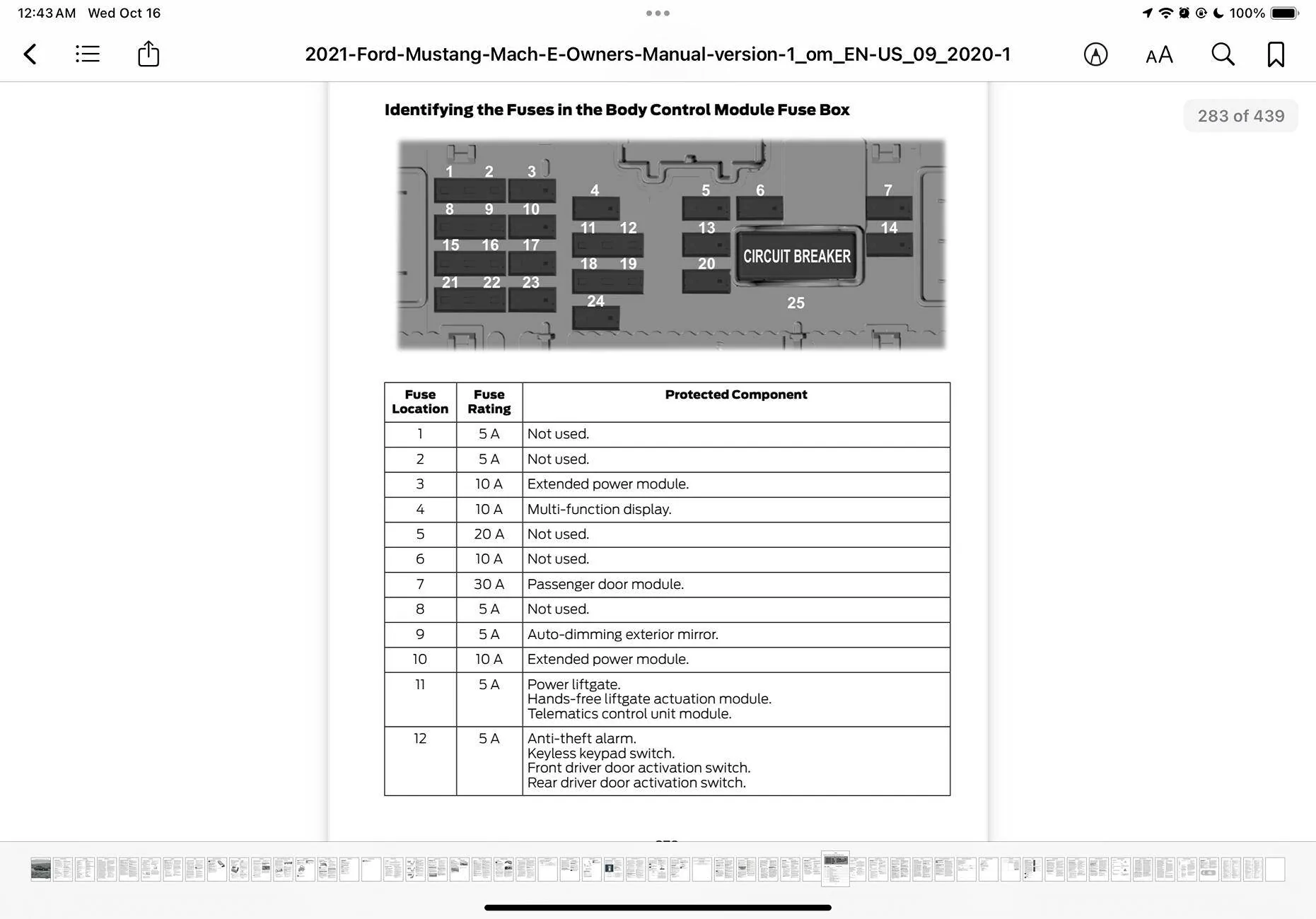

Does the button for the left rear door also not light up or work? If yes, blown fuse.in position #12 in the passenger footwell fuse box. This is a 5A Micro3 fuse, so there are two circuits on the fuse (11 and 12). ??
I’m embarrassed to say I didn’t even think to check the fuses as I was so fixated on the dealership actions. Unsure how it was blown while in the shop but that was it. Fixed the opening delay issue as well. The impacts I perceived on the passenger side must have been a mild case of confirmation bias.

Mine blew as well from the same service. That’s why I asked. I am also not sure how the heck they could have blown that fuse replacing a camera cable. ??

Actually, my fuse blew when I diy'ed the camera cable as well. It's likely that two of the pins in the A-pillar connector touch unexpectedly when you have to take it apart to change the Coax.
It is a 3 pin fuse (combo fuse), I swapped it with another fuse position that only used one side of the fuse.

LOL I didn’t even think to look and see if there was a Micro-3 that used only one side. I could have saved the $8.99 and tax on the fuse assortment (since the store didn’t have a 5A Micro-3 fuse packaged as a 3-pack). Gonna put my dead fuse in position 8 and save the good fuse from there. ????
I used the same one, just swapped the bad side of the combo to the unused side of the 8-9 position. I’m surprised by the lack of spare fuses for the Mach-E unless they’re buried in the other box below the frunk tub.

Had exact same issue when in for Front Camera Fault / 23-2155. Thanks for sharing, replacing Fuse 12 for the win.

Same here, they had it for five days then delivered it back like that. Fuse 12 for the win indeed.
