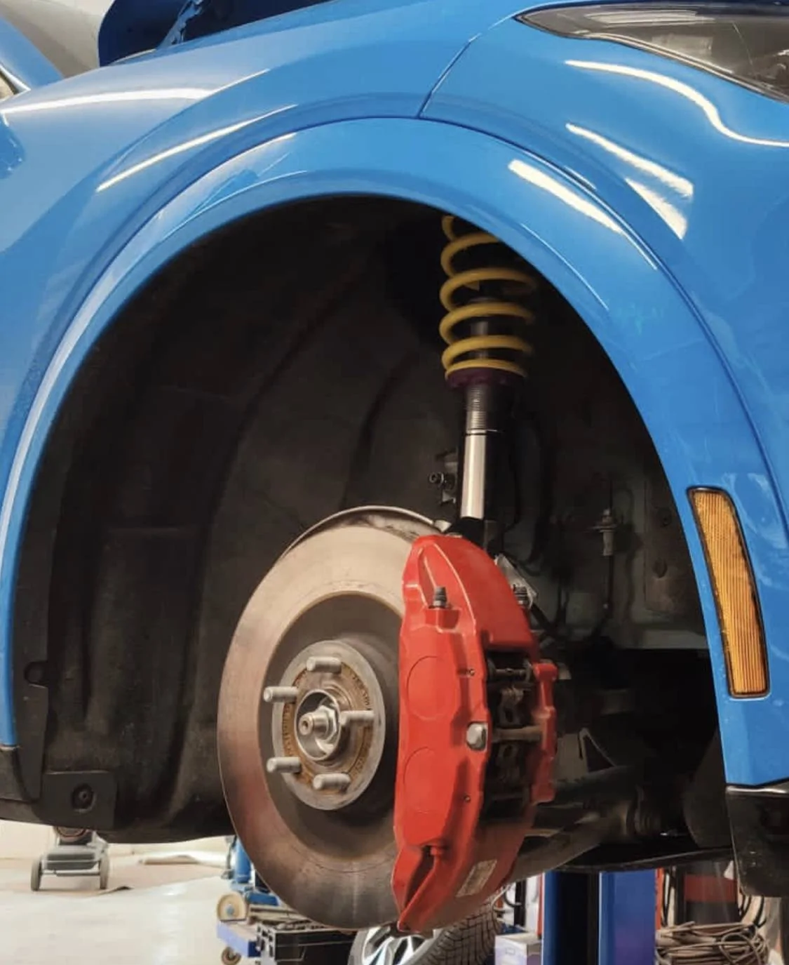

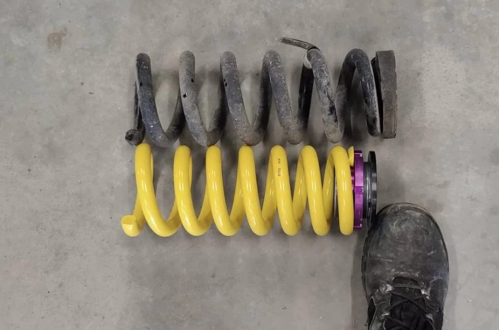

I mentioned this in the other thread;
For what it’s worth, I got the KW’s installed, and running them on defaults has helped with the pitching motion, a lot.
The problem with the car is ”over-suspended under-dampened”, meaning the car exhibits a firm posture with the slight increase of harshness, with the inability to control the mass resting on the springs.
It’s really hard to quantify the change, and the best I came up with is a container of liquid on the dash (handsanitizer in a clear bottle). Before the coilovers, the liquid was moving constantly along the length axis as the increased pitching suggests it would. After the install, the liquid is much calmer, often remaining stable on stretches of highways that were problematic before.
And as a subjective opinion, every aspect of the ride has improved. It still retains the same firmness, but now feels slightly more capable of absorbing the small bounces with increased grace.
And most importantly, I no longer get motion sickness.
What else would you like to know?
