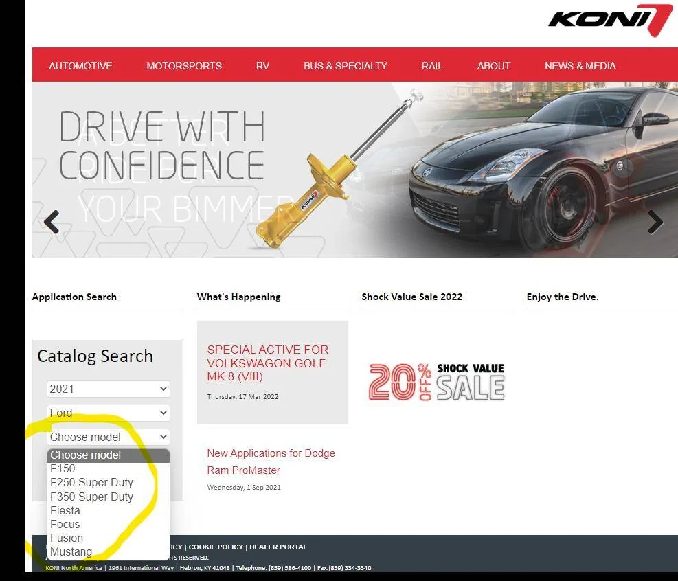

Now if you are looking for a true $1k solution, then keep an eye out for Bilstein (B6/B8s) or Koni FSDs (or Yellow if you some want adjustability). FSDs are the route I would take (and currently Koni offers them for everything up to an F450).
Is koni FSD available for the mustang mach-e? I wouldn't mind trying something like that
Doesn't look like it:
