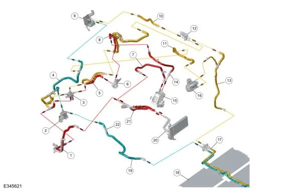

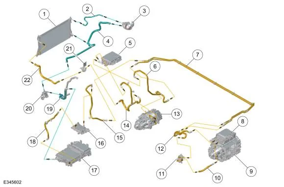

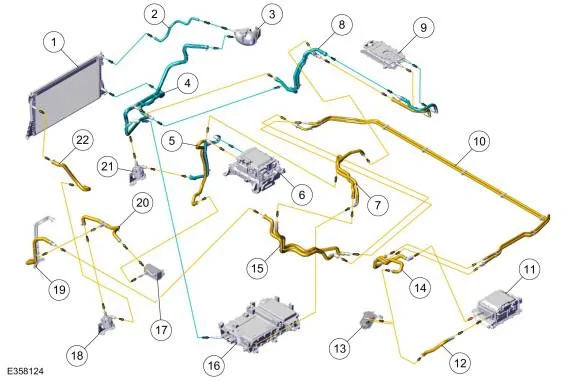

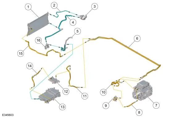

As far as I'm aware the motor loop and cabin/battery loop are not combined. This is bad info in the WSM and it isn't the first time I've seen it. Ford appears to mix ICE documents in the WSM along with stuff that was written then they appear to have made changes and forgotten all about changing the WSM.
Here are pictures of the cooling loops for each along with the picture of the coolant loop for the heater/battery.
I can give you component descriptions if interested.

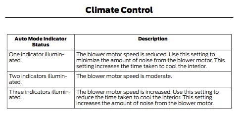

Auto has 3 modes to control how aggressive the fan will spin up. If it's too loud just put it on the first auto mode.

Thanks so much for posting. I love this stuff!
Munro states there are two diverting valves one 4 way and one 2 or 3 way. #3 on the heating plan is the 4 way, #12 on the heating loop is the two-three way. #12 appears to decide whether the battery gets cooling through the chiller or heating/mixing.
I also recall ford saying the system does recoup heat from what I thought was the motor/Inverters ( but maybe it was the battery, which these diagrams indicate) applies it to heating the cabin. again, I do not remember where I heard or saw that. I assume from these diagrams. I guess it's from the battery side.
I do not see any tie between the motor inverter loops and the cabin/battery loop.
The battery heating does absolutely come from the discharge of the cabin heater core (core return water). The fluid goes from the diverter valve, through a pump, through the PTC heater, through the heater core and finally to the diverter valve #3 or mixing piping (# 4) to the battery loop pump and to the battery. It mixes battery return water with warm heater core return water to flow again through the battery for heating.
