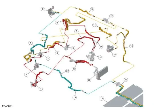

Here's the heating/cooling loops. Note it goes through the heater core first.
Ford Mustang Mach-E Little heat verified by data log imagen2.dll
#15 is the heater, $20 is the heater core, #3 is the diverter valve to allow the cabin heat loop and battery cooling loop to mix.

I really wish someone at FORD would share how the system works and the logic. Anyone have a system diagram from a Service Manual they can share?
