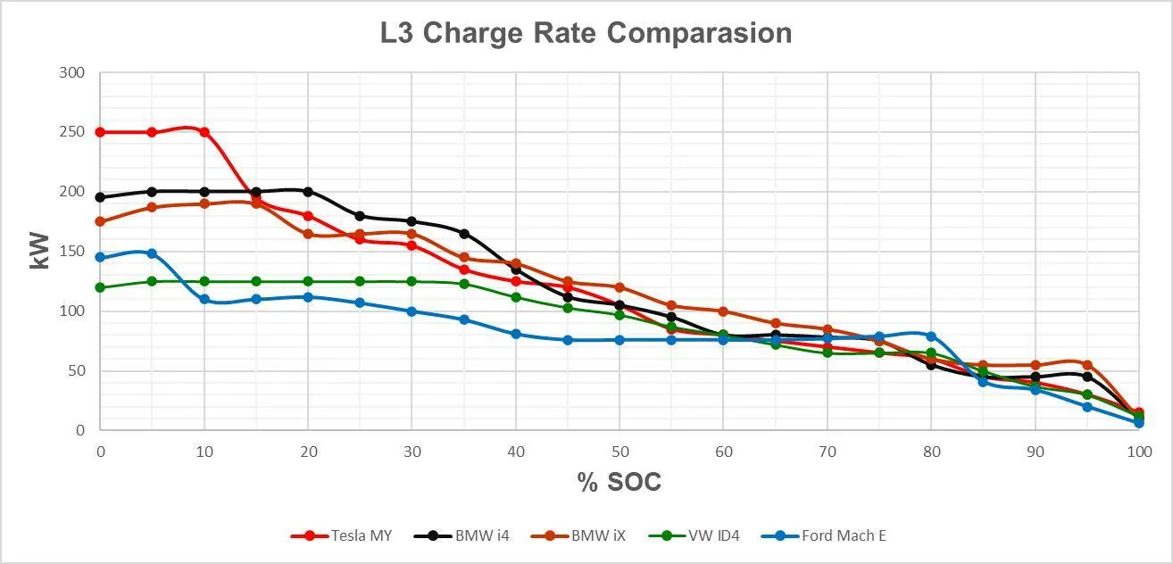

I'm not a battery expert like some on this forum, but I do know a little about Lithium-Ion batteries. As a cargo pilot, I am trained annually on different hazmat. I know the one thing you do not want is a thermal runaway in a battery. Once it starts in one cell, it will carry over to other cells and other batteries. So I understand limiting the power in recharging to prevent this.
To see how the Mach E compares to other vehicles, I plotted the Mach E against other 400V systems. I left out Porche and Audi since since they are 800V, and I wanted an apple-to-apple comparison. Disclaimer: I used charging curves I've found online (other than the MME) so I don't know the accuracy of the other vehicles. What I found was the Mach E was last (blue line). Taking into account not knowing the exact chemistry Ford uses in their batteries, I would say they still have room to increase the rate and stay safe doing it. Hopefully we'll get another OTA update to increase the rate this year.
That said, I love the car, and do not regret buying it. 99% of my driving is commuting to and from work. I would buy it all over again. However, on a really long trip in the winter, I would take my ICE F150. :p

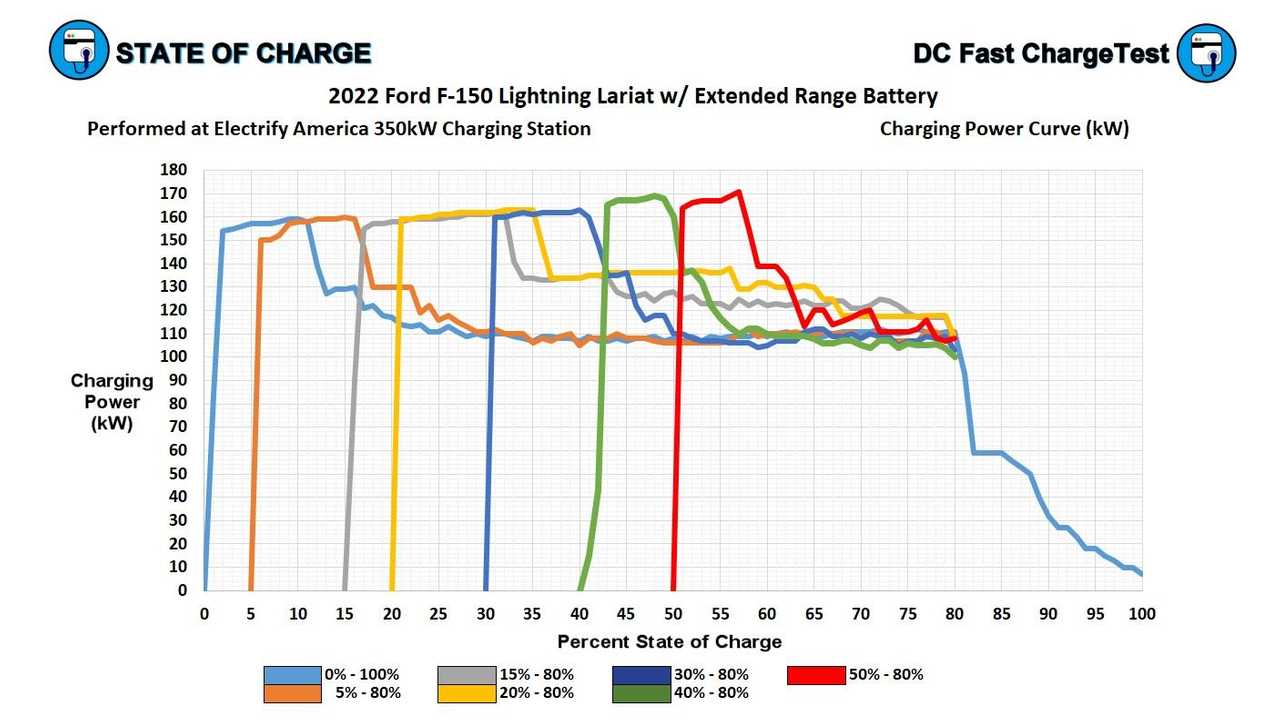

The MME and the Lightning share the same time-based “sprint” charging strategy. That is, they charge basically the same whether plugged in at 5% or 50% and everywhere in between.
The benefit of this strategy is that drivers can immediately take advantage of max charging speeds at a relatively high SoC. Getting 130+kW at 45% is glorious and it follows the same sprint profile as if it was at a lower SoC. Compare this strategy against a linear profile and you can see that you get the same twenty minutes 40-80% time as the Tesla Model Y.
I wish we had a flatter charge profile at a higher kW for a shorter time going 10% -> 80%. 30 mins should be the target for the MME which would make it more competitive in its category.
source Tom Moloughney, InsideEVs

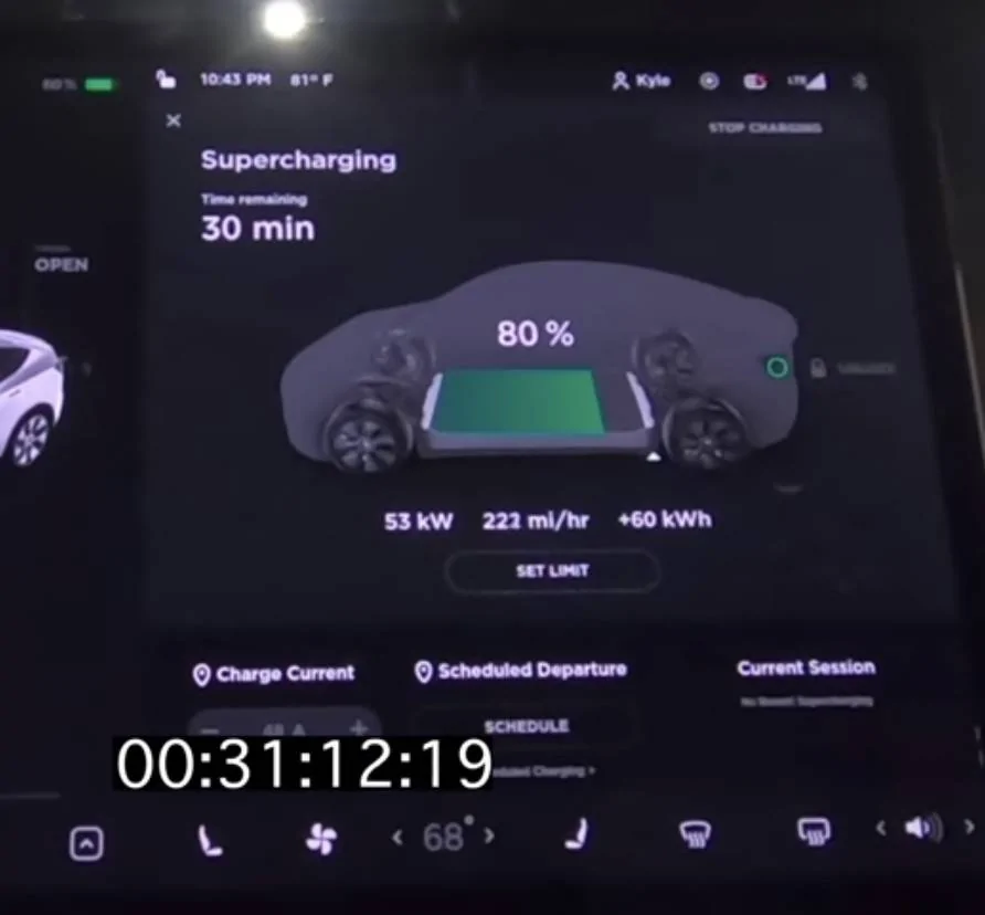

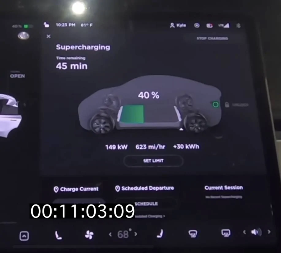

Source @OutofSpecKyle
40% to 80%

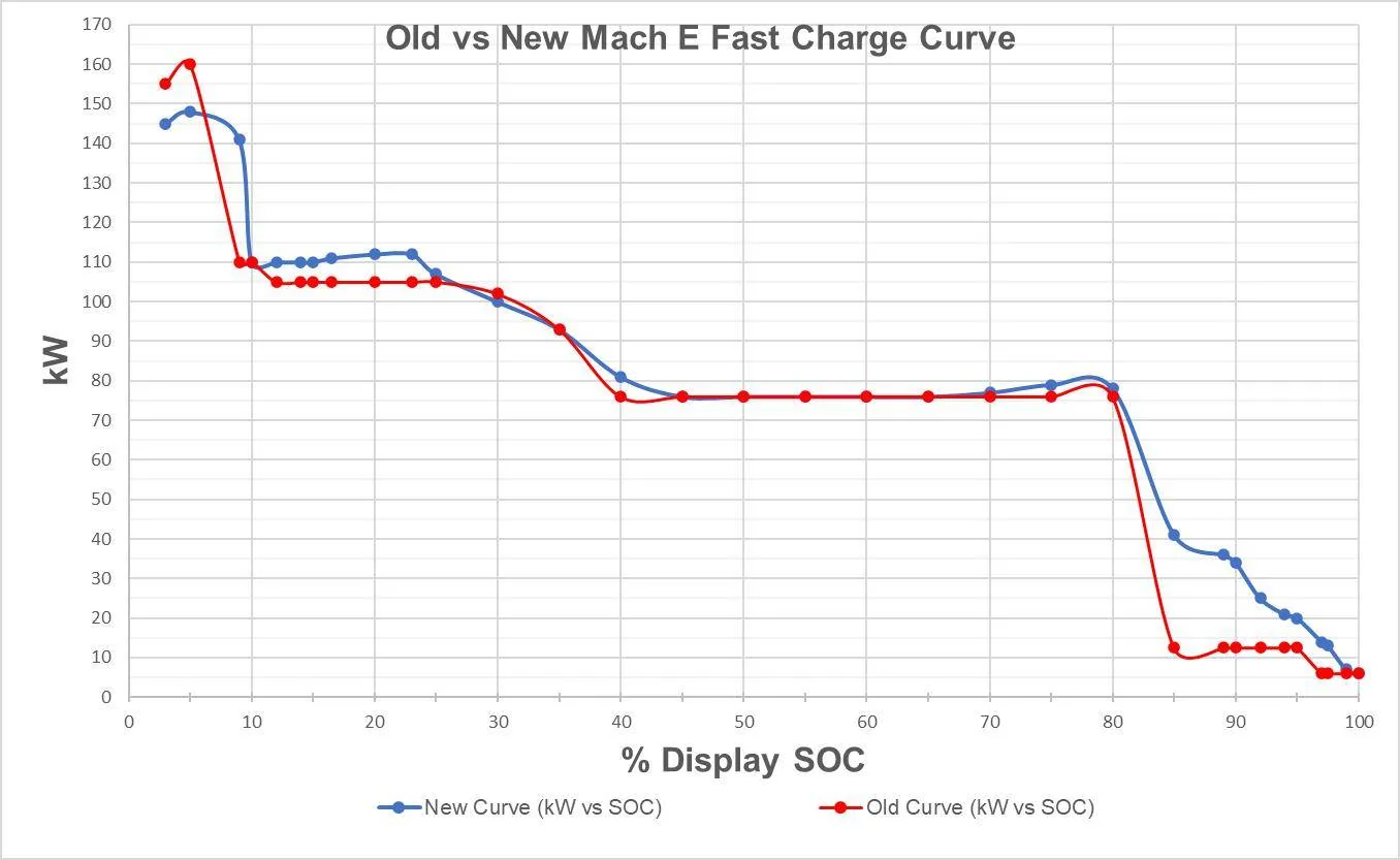

I have had my Mach E for about a month now. I have been using it for commuting to work, and have been charging mostly at home. I did a fast charge at the EA facility in Clarksville, IN just to make sure it worked, and my Ford 250 kWh worked as well. The rate was lower than I thought.
I live in Lousivlle, KY and I have a trip to St Louis I would like to take in the MME, and I was curious how much time to budget for charging stops. I plan on charging to 100% at home for this trip. The first stop from my house to the EA in Clarksville is about 20 miles. It took me about 8% to get there. I wanted to see how long it would take to get from about 92% to 95-97%. The next stop is the EA facility in Mt Vernon, IL. It is about 186 miles from Clarksville, IN on I-64, and no other L3 chargers are on I-64 along the way. I could detour if needed, but that is not optimum. The L3 in Jasper, IN is a 34 mile round trip detour and only 50kW, the one in Evansville is a 60 mi round trip detour.
So, I drove to car to get the car down as low a charge as I was comfortable with, and got it to 3% SOC on the display. I then settled in for a long charge all the way to 100%, and got my pencil ready to chart this. I know the Ford updated the charging rate last fall, but couldn't find any data, so I plotted my own. Conditions at th time was 48 deg F outside temperature, battery temperature started at 51.8 deg.
This first chart shows the new rate compared to the old rate that Inside EVs has posted. I overlayed the 2 to see how closely it matched up. It matches well until 80%, then is a big improvement to about 95%. The battery temperature at the end (100%) was 87.8 deg Fand outside temp was 46 deg.

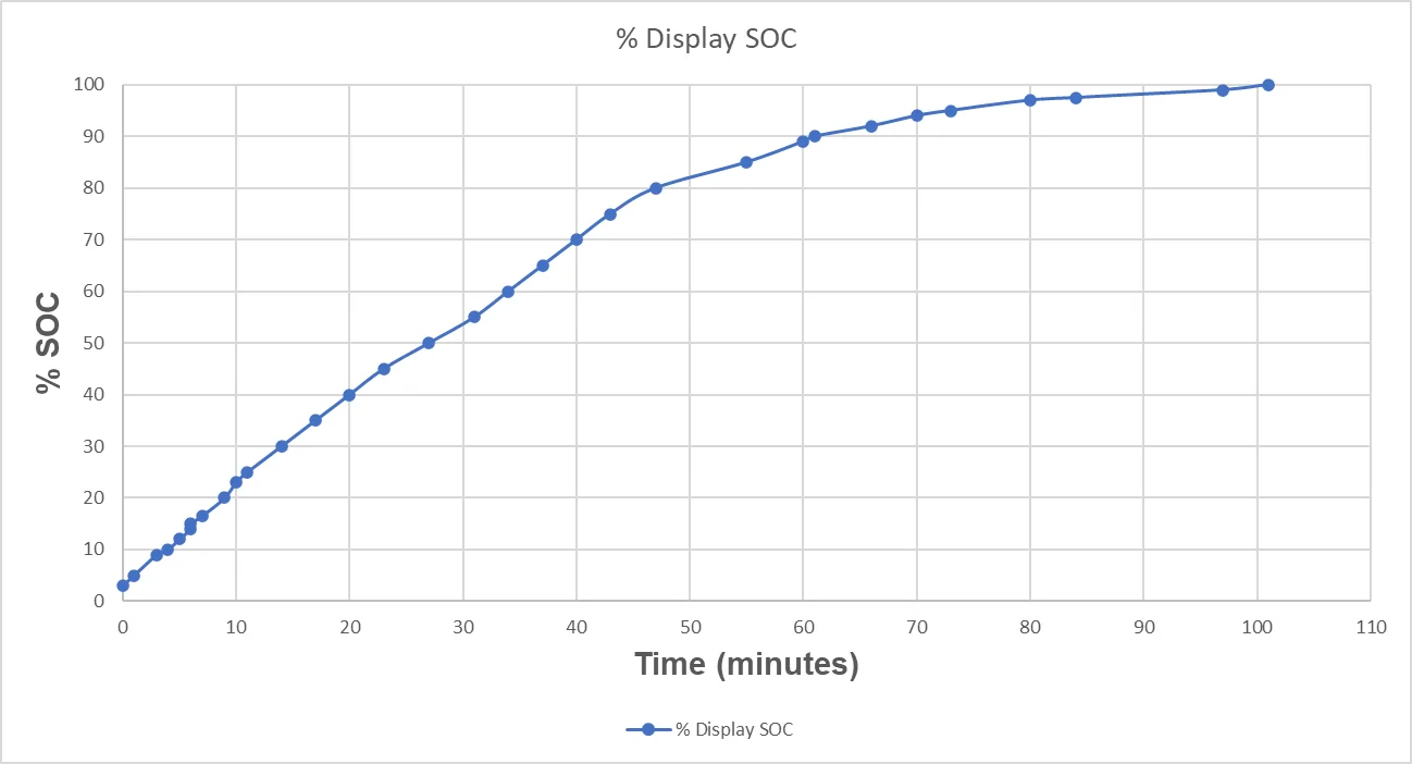

Overall, it took me 1 hour and 41 minutes to charge from 3% to 100%. Of course, the last 5% was the slowest. Here is a plot of the time it took from 3% to 100%. I've extrapulated charging from different points, say 20-80% and how much time it will take. Here is what I came up with. Maybe others who have done this can see if matches what they've seen. Of course, temperature can change these estimates.
  • 20%-80% - 38 minutes
  • 20%-85% - 46 minutes
  • 92%-95% - 7 minutes
  • 92% - 97% - 14 minutes (for that top off before my long leg to Mt Vernon)

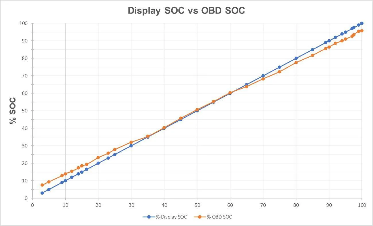

The last chart is interesting. I had my VLink OBD2 plugged in monitoring the charge, and observed when I first started, the display SOC was 3%, but the OBD said the car reported 7.48%. It reads higher than the displayed SOC below 35%. It matches from about 35% to 60%, but then it goes the other way. The displayed SOC is lower than what the OBD2 says it is from 60%-100%. So as others have said here, a displayed SOC of 100% is about 95-97% if you read it from the OBD.

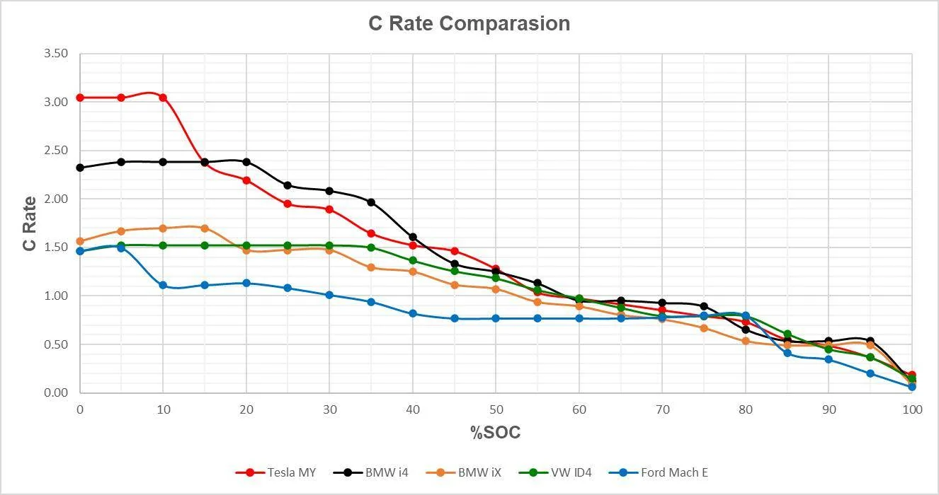

Now graph them by C rate, I think it will look even worse. C rate accounts for the relative size of the battery pack. Divide the kW rate by the kWh nominal of the pack. E.g. 80 kW / 99 kWh = 0.81C for the Mach-E.
asking for more than 1C charge rate is not a great ask if you want you pack to last as long as possible. An hour at high C rates is pretty tough on Li cells.... short bursts during WOT or regen are 'ok', but still hard on the cells.

As requested. You are correct, it is even worse.

Yeah our pack charges very slow for how big it is, one of the slowest C rates of modern EVs. Most of the other manufactures allow 1.5C or greater rates down low as you can see. I think Ford could easily make our charging curve more like the ID4, so about 150 kW sustained. But they are just ultra conservative, I think it's driven by an extreme fear of potential future warranty costs. I've mentioned this before, but I find it bizarre how they've focused so heavily on limiting the DC charge curve and ignored enforcing a daily charge limit of 90% or less or moderating cold pack regen levels, which also contribute to early pack degradation.
