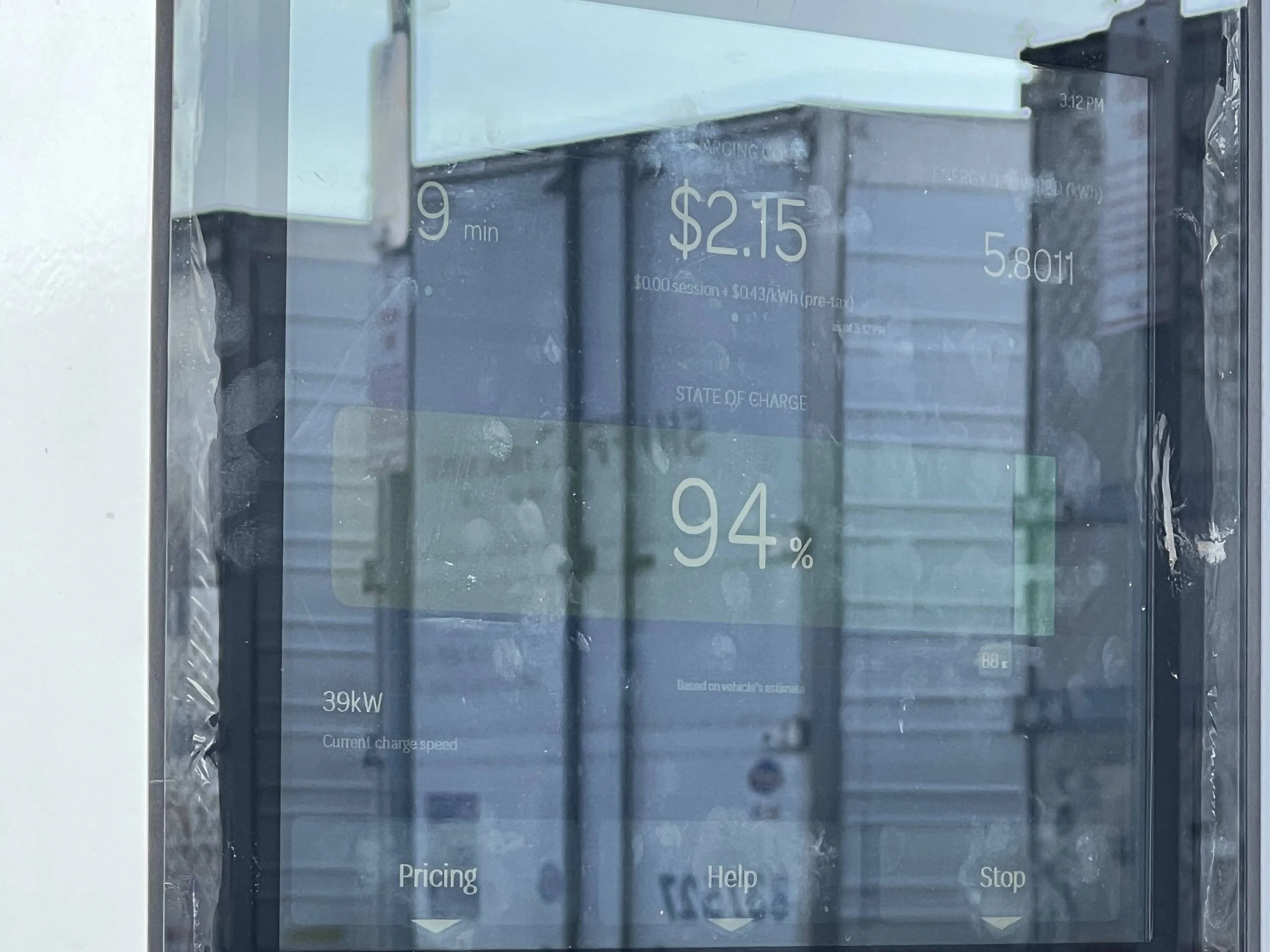

is it confirmed that the charge rate after 80% is 30kW now and not > 40kW?

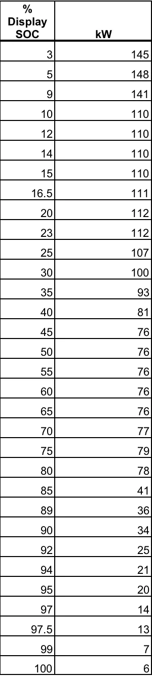

It depends on the day, outside temp, battery temp I think. Mine rate was lower, but as noted, some people are getting 40 kW. Here is my ray data. When I started, there was 1 other person charging. I was on an EA 350 kW charger. When I finished, all 6 chargers were in use.

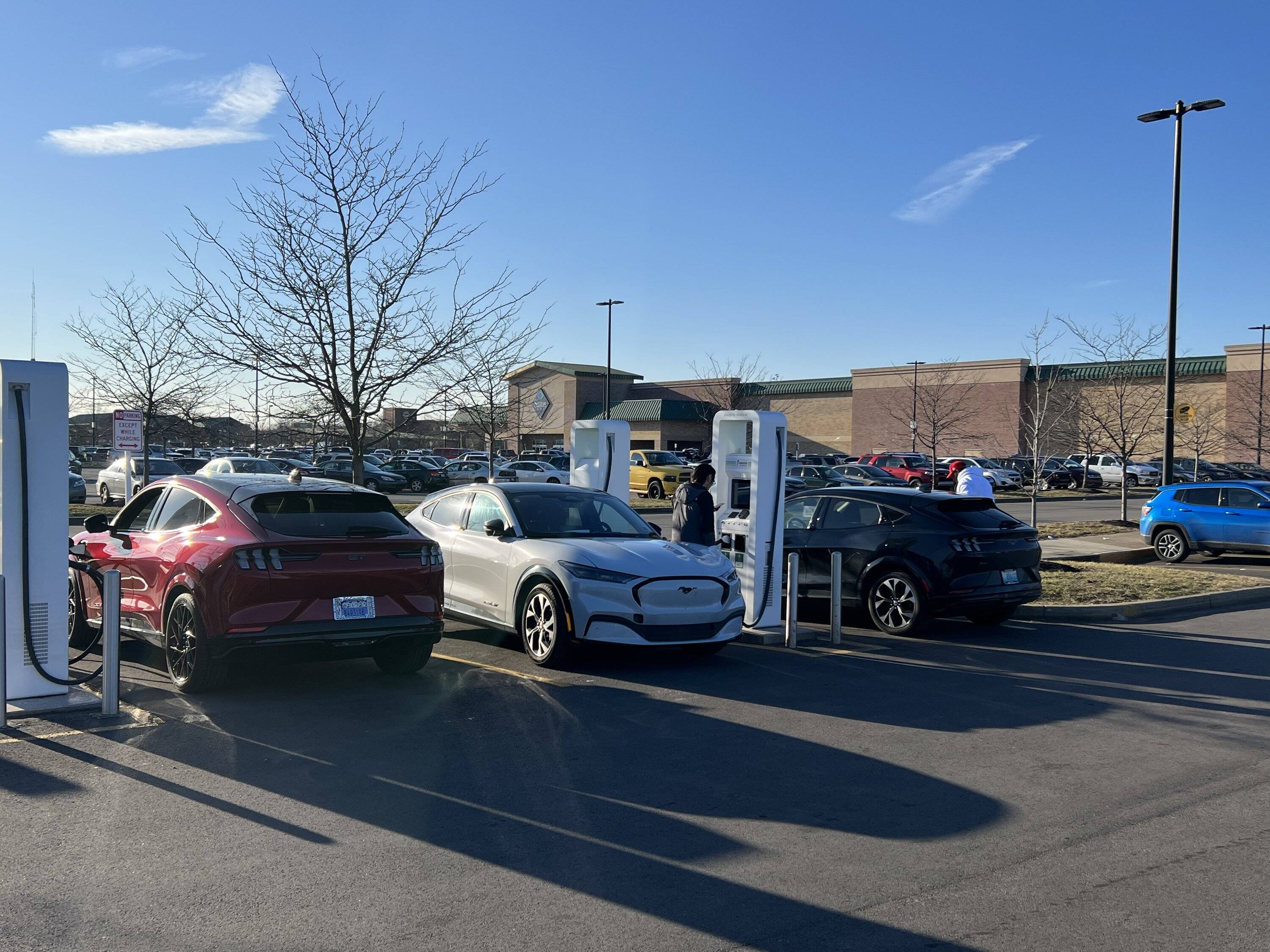

Also, we had 3 MME in row!

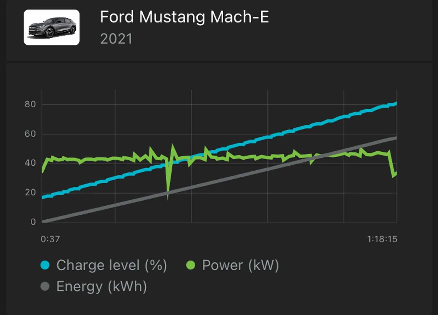

Was in October I do not DCFC or long distance travel much in the winter. Only update since is the heating system.

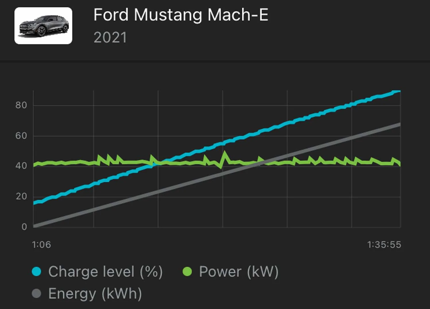

Edit: above was after the power up. I went in right away for the TSB and this is the curve after it
Ford Mustang Mach-E Mach E Fast Charging Rate May 2022
Appears the power up down graded the TSB

nice data sheet! I bet that if there was another column for time, you’d see the peak charge rate last for 2 mins and that the row for 80kW/40% SoC would line up at the 20 minute mark.
The MME ER gets its best charging for twenty minutes but it’s at a relatively low kW compared to its competitors. It’s disappointing to me that since 2020, Ford hasn’t improved the 10%-80% charging time.

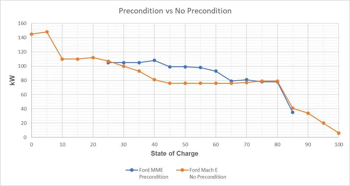

I took a trip to Cincinatti this weekend and needed to fast charge. I saw @Mach-Lee's post about battery preconditioning and wanted to see if I had this feature. I have a 23, with no OTA updates, Sync Ver 22280 or 10/7/22 and my car was built on 11/9/22. It turns out I do have it. I was able to warm the battery up to 80 deg F before charging.
I did not do this the last time I fast charged, and I obtained some interesting results. I started the charge at 23%. The first charger I used only got to 44kW, so I moved to another charger, and got over a 100 kW. This charge started at 25%. The last time when it was 40 deg out, with no preconditioning, the rate from 40-80% was about 76 kW. This time, from 40-60% I was at 100 kW, and then at 80 kW until 80%. From there it ramped down to about 40 kW. Here is a graph showing battery preconditioning vs no preconditioning. I'll post more later. The reason I went to Cincy was to go Micro center to build a new computer since I was running a Gen 1 i7 from 2009!. My new build is working, but I haven't moved everything over yet.

Did you use the Ford nav to tell the car you were heading to a DCFC session?

Yes, you have to use the Ford Nav and pick a charger from the CHARGERS tab. Waze, Apple maps, Google maps, etc won't work.

From what I understand it is not physics based but time based at the beginning and then a random wall at 80%. It drops faster at 80% if you have more points.
If you take your blue and shift the beginning to 5 - 10% they match pretty well.
