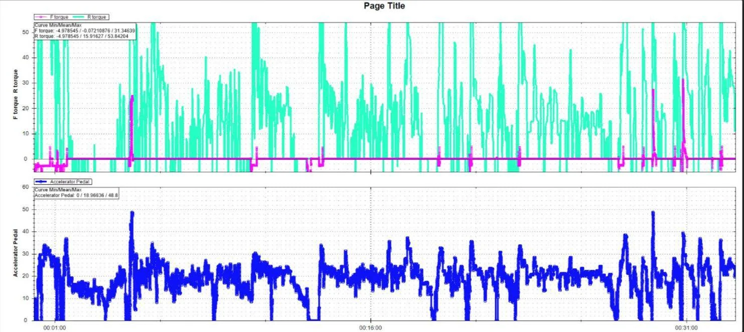

except tesla doesn't use a normal PMSM motor, they run them in PMSM at low speeds and switch to SRM at high speeds.
FYI on the 3/Y, it's not speed dependent but more so power (as needed) and/or traction that will dictate when the front induction motor is activated. Below is a graph on a datalog on did last winter showing when the front induction motor activates. On this 33 minute drive, it only activated about 15 times once the accelerator was at about 30%. Not shown here is when the front motor activates when the rear end detects slippage. The 3/Y dual motor is 100% RWD (permanent rear magnet) regardless of speed.
Ford Mustang Mach-E Mach E GT 70+ Acceleration Issue - Video 1632751549029

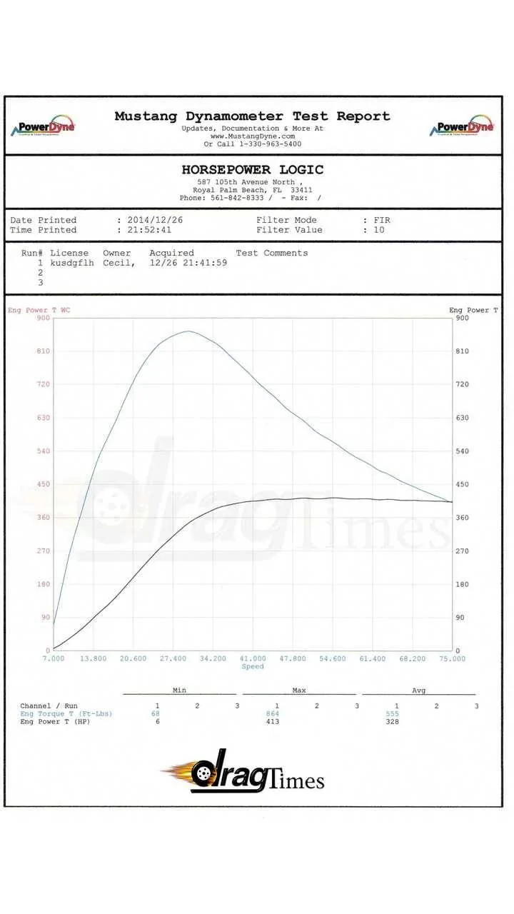

Flux weakening also does LOWER the power and efficiency. You're talking mechanical power, i'm talking electrical power. Flux weakening extends the constant power region but that's constant electrical power, the efficiency starts to fall off, and near the top of the rpm range there is nothing left for torque or power. The back EMF is just too high to be able to dump more current into the motor.
I feel like a picture is worth 1000 words.
Tesla P85 dyno. Horsepower is almost completely flat:
Ford Mustang Mach-E Mach E GT 70+ Acceleration Issue - Video D49F2AA7-3801-4742-8BCE-1BF2DFA2BB25
