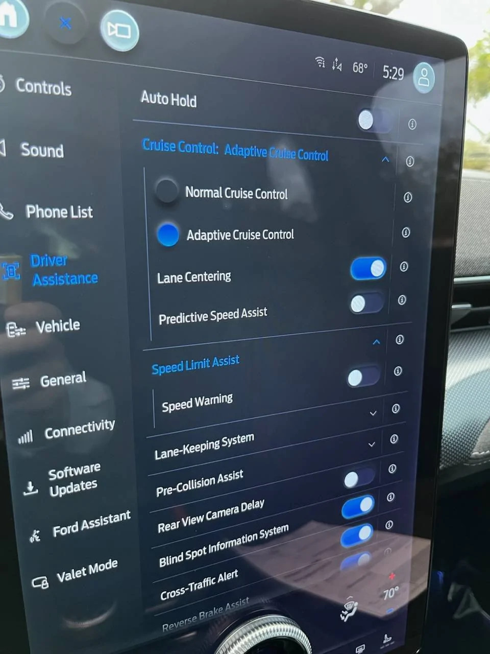

I think Ford got the message.
It doesn’t look like this is a feature any more for 2023.5 cars. Got a GTPE loaner today while my 2021 is in for the recall. This is what the driver assist menu looks like-

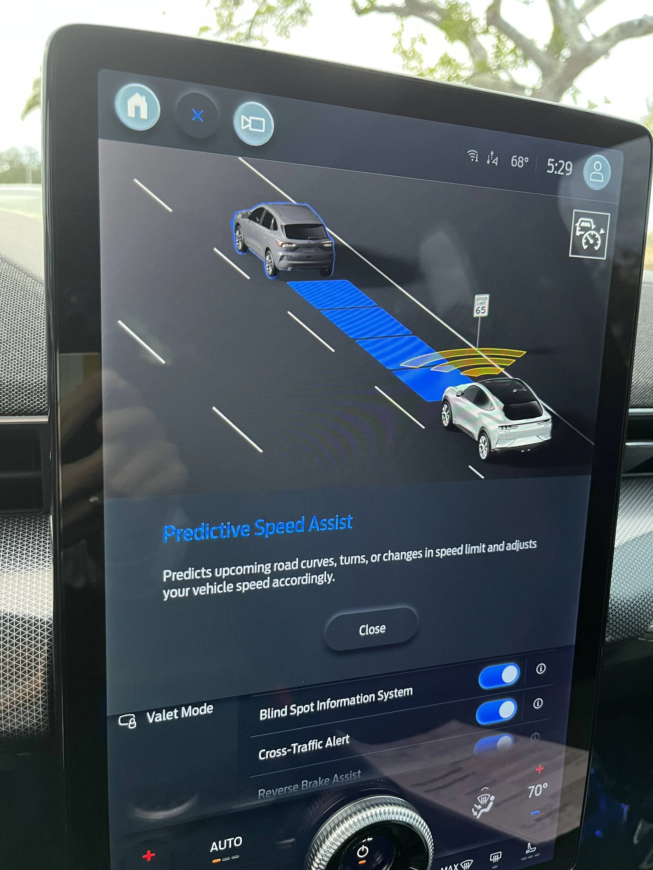

Predictive speed assist is something totally different now too-
Ford Mustang Mach-E Need help getting answers! Possible Unintentional Acceleration issue. IMG_9690
Not sure if the “changes in speed limits” will make people go faster again though. But the curves and turns seems new.
