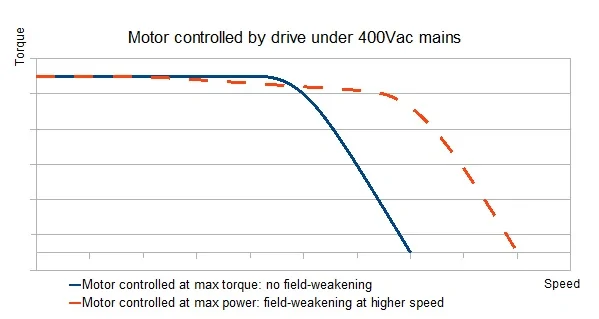

No. Flux weakening doesn’t “cause” high speed loss of power despite that article that was posted on the drive. It’s used to keep power at the unit’s max, and it starts at like 30-40 mph.
This has been beaten to death.
Yes it does, it just extends the point at which the torque loss occurs. It still happens, and its a sharp drop off.
Tesla and other manufactures run a second motor that isn't a PMSM so they are better able to transition power over at high speeds. Porsche has 800V batteries so they can push higher drive voltages to overcome the back EMF. Everything I've seen with my car and others here just look like the torque drop off of a bldc motor.
