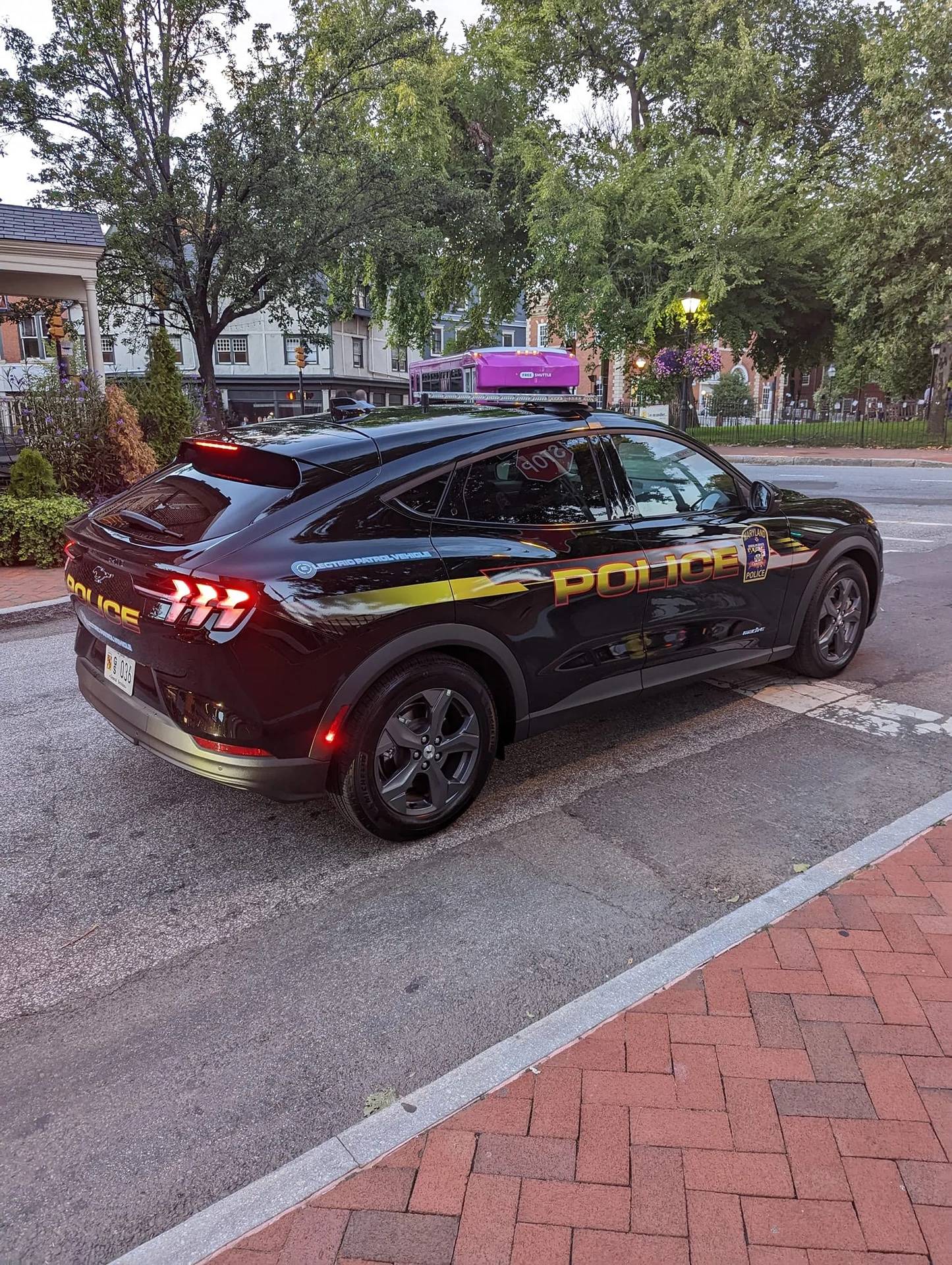

Maryland State Police Maryland Capitol Police is trying out the Mach E:
Ford Mustang Mach-E Mach-E Police Cars MSP Mach E
Looks like a basic Select (Mach E).

That’s not the Maryland state police.

Sorry, emblem says Maryland Capitol Police.
