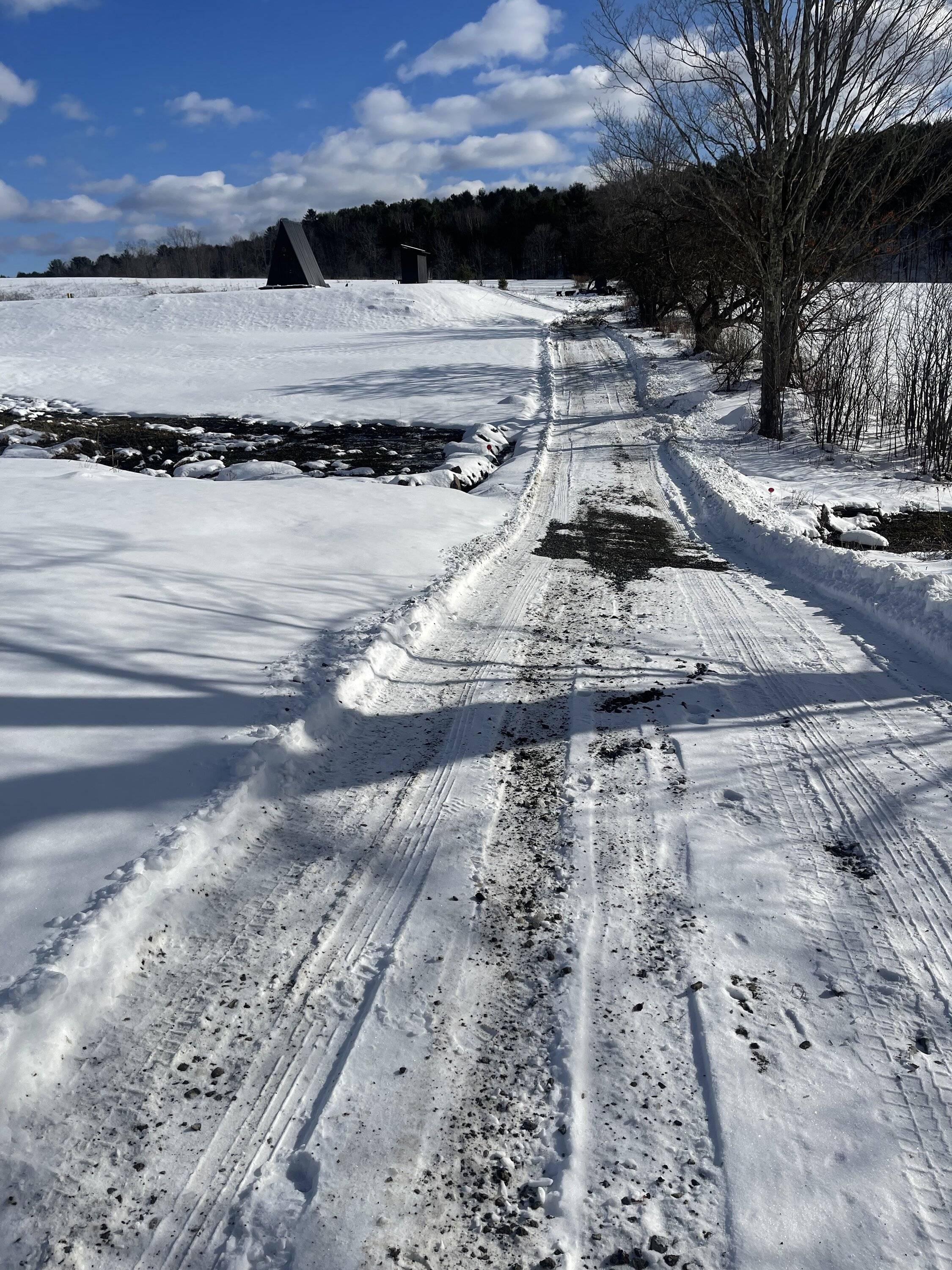

Was stuck all night. In the morning I had to call a contractor i know who helped me build my cabin to come try and save me. We dug it out pushed and pulled - and connected a chain to the front tow area and yanked and the car came loose.
I probably will be buying the aftermarket tow kit for the back of the car. I would never use it to have the car towed long term, but as a place I can attach chains to, to get pulled out of bad spots I don't see that being too much of a problem.
Tow hitches are not rated for recovery and should never be used as such. It can easily take 10,000 lbs of force to pull a stuck vehicle out of snow. That will rip the hitch right off the Mach-E.
I suggest you get some driveway markers and mark the boundaries of your driveway in the fall before it snows. On curves it's especially easy to go off the road without markers to guide you.

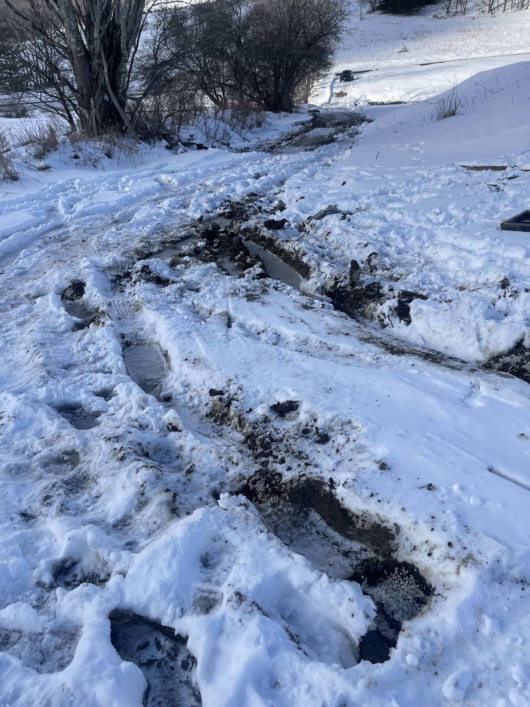

I drove my mach-e to my off-grid cabin out of the city. The person who was supposed to plow my gravel road didn't yet but the car is AWD so I thought I wouldn't have a problem. The driveway is about 200 ft with a very slight incline. Once i started driving in I realized it was more snow then I originally thought but wasn't sliding and making a slow steady pace up. I made it all the way to the top then when i made the turn to pull up right next to my cabin I fell into either a ditch or just tire tracks prove previous drives up when there was no snow. With the snow I didn't realize/notice the low spot.
Car is slanted. Back left tire just keeps spinning. Digging itself a bigger hole. All other tires don't move. Cant go forward or reverse.
With 100% of the cars I drove before this would be an easy fix. Someone pulls me out from behind. Can't happen with the Mach-E. Someone would have to go around my car, potentially going in the same ditch. Then come up in front and pull me forward through the ditch.
LET ME KNOW IF YOU HAVE SUGGESTIONS
*fyi yes i regret the decision to drive up. This car is certainly not my old ford explorer.

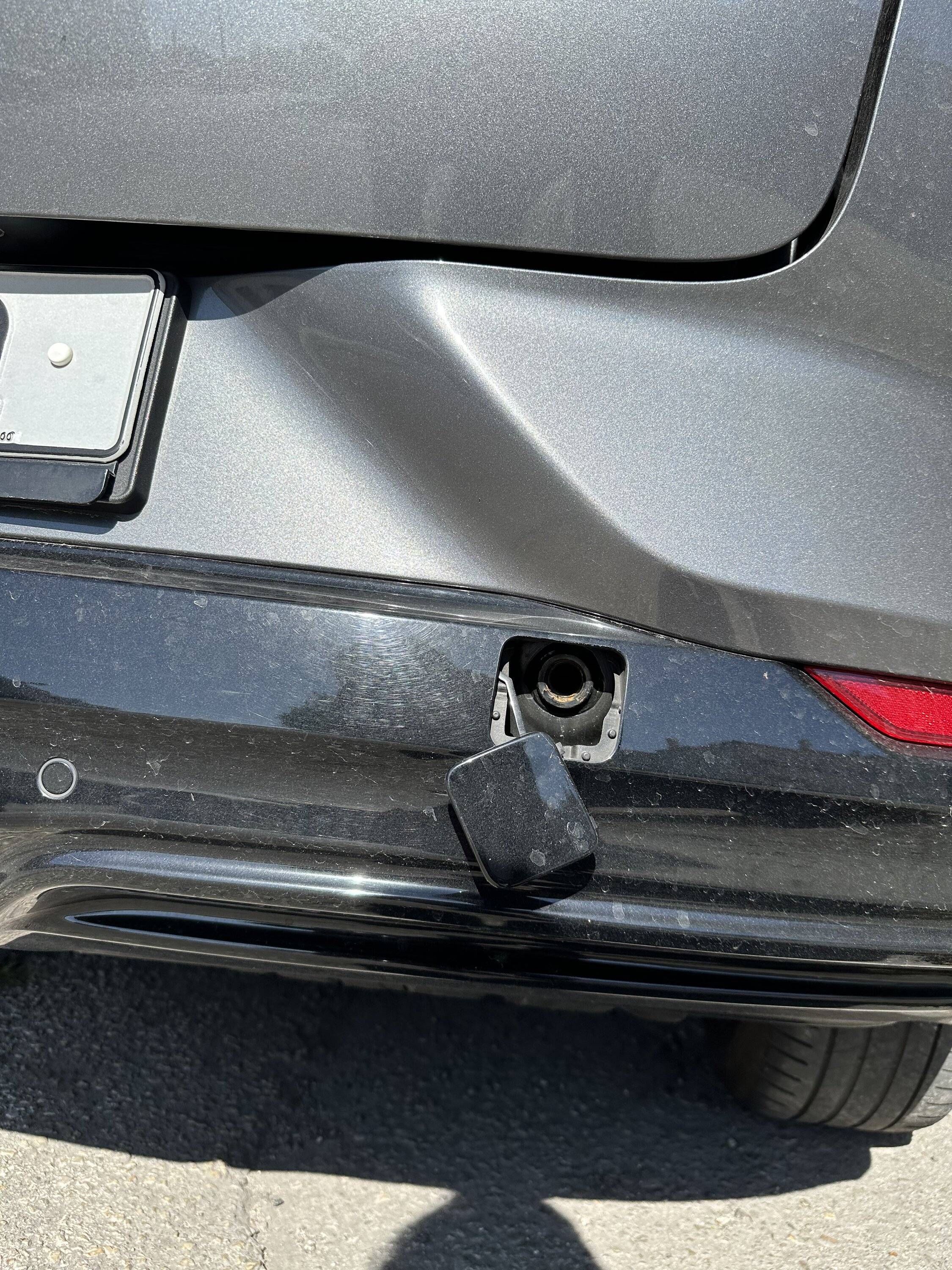

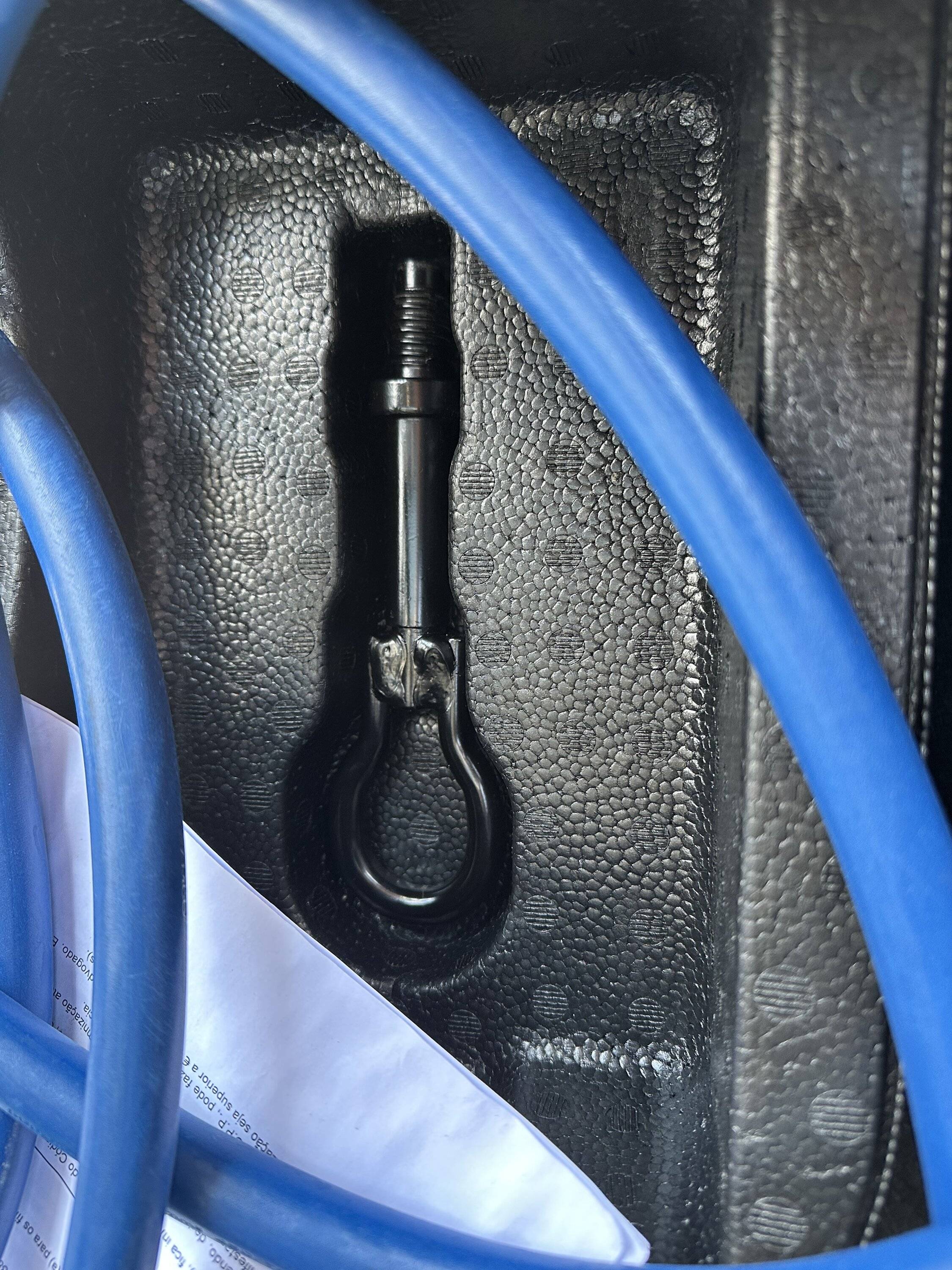

Why you guys are saying can’t be pulled from behind ? Didn’t understand
I already got my tolwed from behind
13,022
17,564

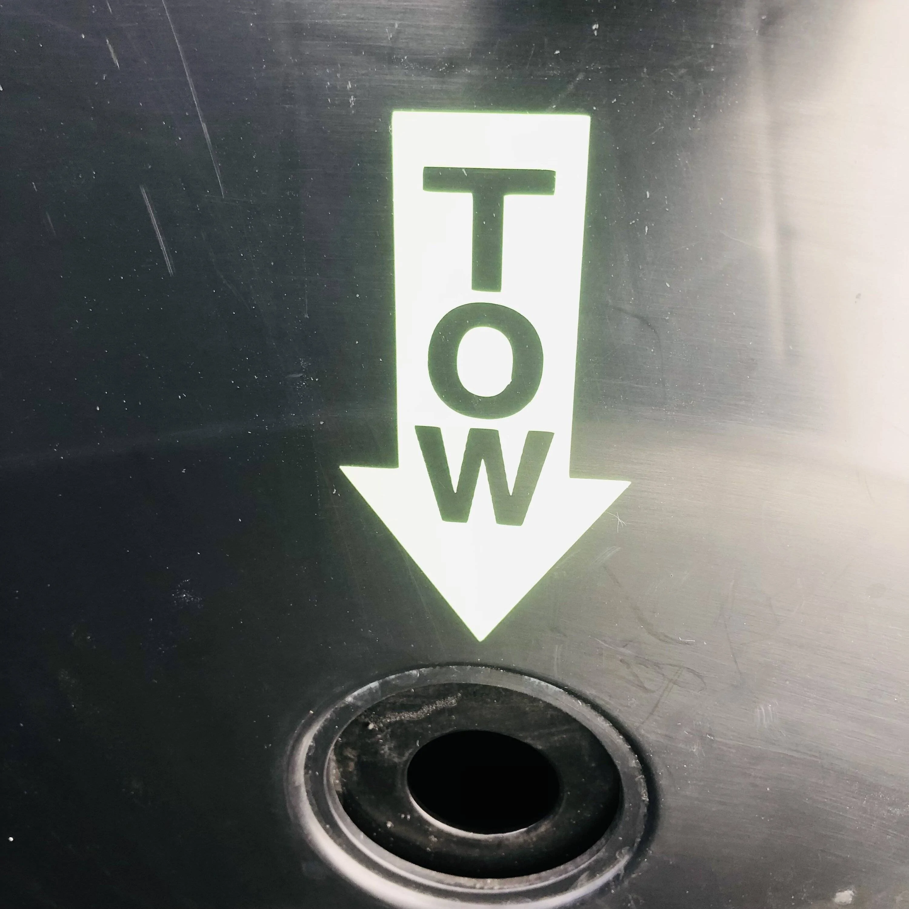

There are no factory tow points at the back of the MME. Any towing from behind *might* damage the car. The only factory-approved tow points on the North American MME are under the front end. ??

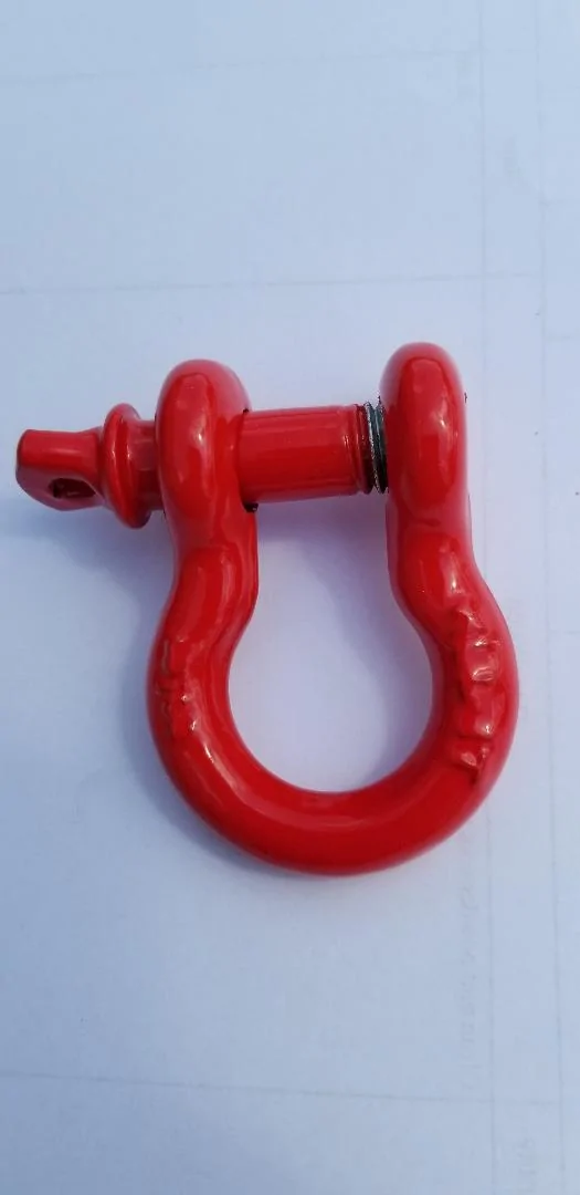

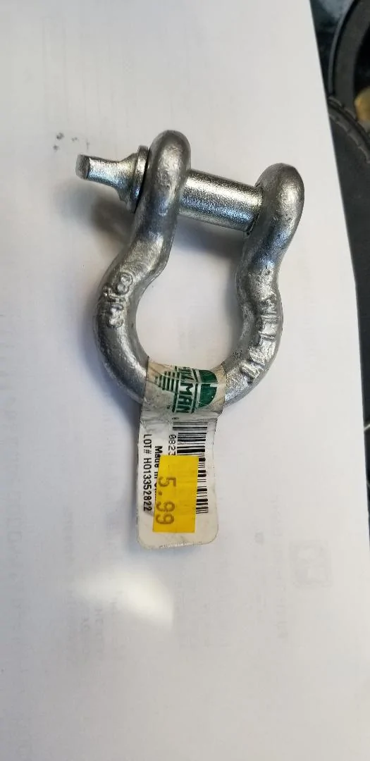

...unless we put one in :cool:
...unless we add a 1-ton shackle to a certain imported Euro Ford Mach E tow bar ;)
Ford Mustang Mach-E Mach-E stuck (front in) in a ditch Rear tow 1-ton shackle, price $5.99 + tax
Ford Mustang Mach-E Mach-E stuck (front in) in a ditch Rear tow shackle, powder-coated Racer Red, naturally
Ford Mustang Mach-E Mach-E stuck (front in) in a ditch Rear tow shackle, mounted onto the Ford tow hitch's safety strap mounting point

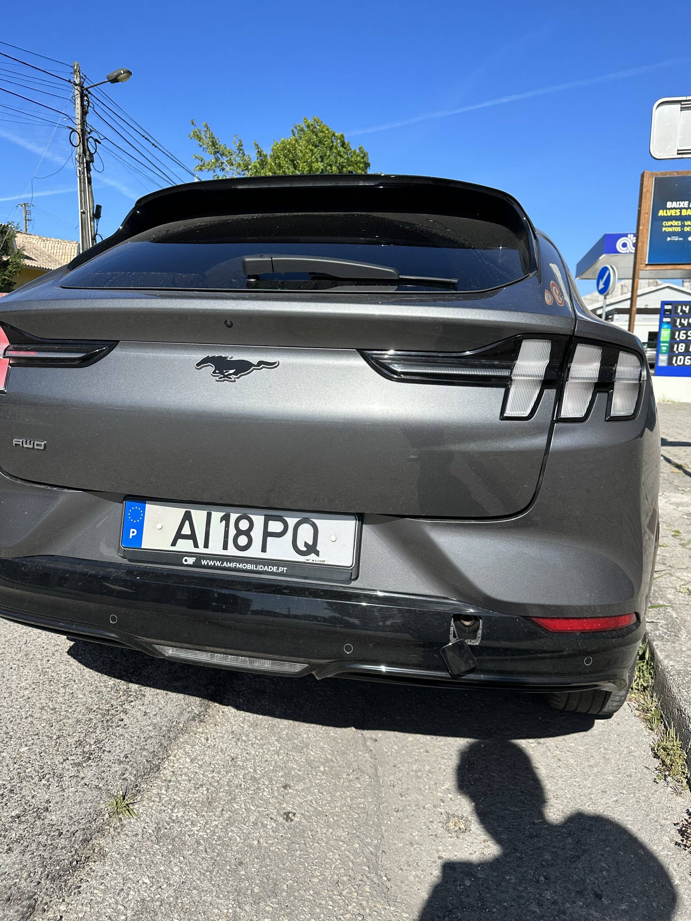

Owww didn’t know that.
the European version have a tow factory point behind too!
I live in portugal. Will send pictures soon
