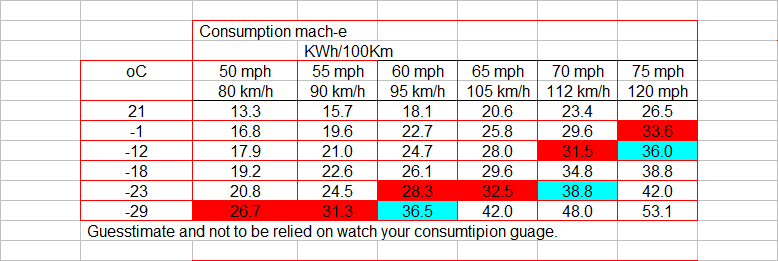

Still have not provided mileage and route to get input into the best way to do that from people in the know here much better than I. As noted your travel charger plugs into anything you can find so it is at the hotel with an extension cord and you need to figure it out. Sounds like big time commutes therefore the gas must have been killing you. I always flew home faster than there ;).
EPA range is questionable for some. WLTP is higher than the EPA range. Take it from there.
Here is mine for comparison it is off a bit I think (conservative) but do not care as I have worked out my long travel plans and they are conservative. I do not mind kicking back and charging for a bit. I drive in the high 90% highway. Todays temp 55F range was higher when warmer. It is what it is and was fully documented and researched prior to us buying. The 12% buffer and 80% DCFC cliff did not help for our 100 KWh both revised after my order but I bought it anyway and understood the range I was buying. 310/0.85/1.6 = 230 miles. You want more slow it down to 50-55 mph and see what you get.

Also note that as the weather turns colder, or the roads are wet or windy, that will shrink. You might be able to make it fine in the summer, but some winter days could be a bit dicey.
I was getting 19 to 22 KW/hr in the summer at the 20C range saw 31 at -15C this past winter. If the air is denser the drag is more and nothing likes the cold. Red is a no go for my charger spacing and only 80% charge. Blue is 90% I would love ford to shift the cliff to 90% ?‍♂ for the blue moon when that happens. Really can not see me just flighting down ? the highway at 55 mph but who knows. Based on below you know where my speed is sitting. I have not tested the cold to any conclusions to date.
Prior to purchase table based on dyna test results (0.7) and not EPA.
