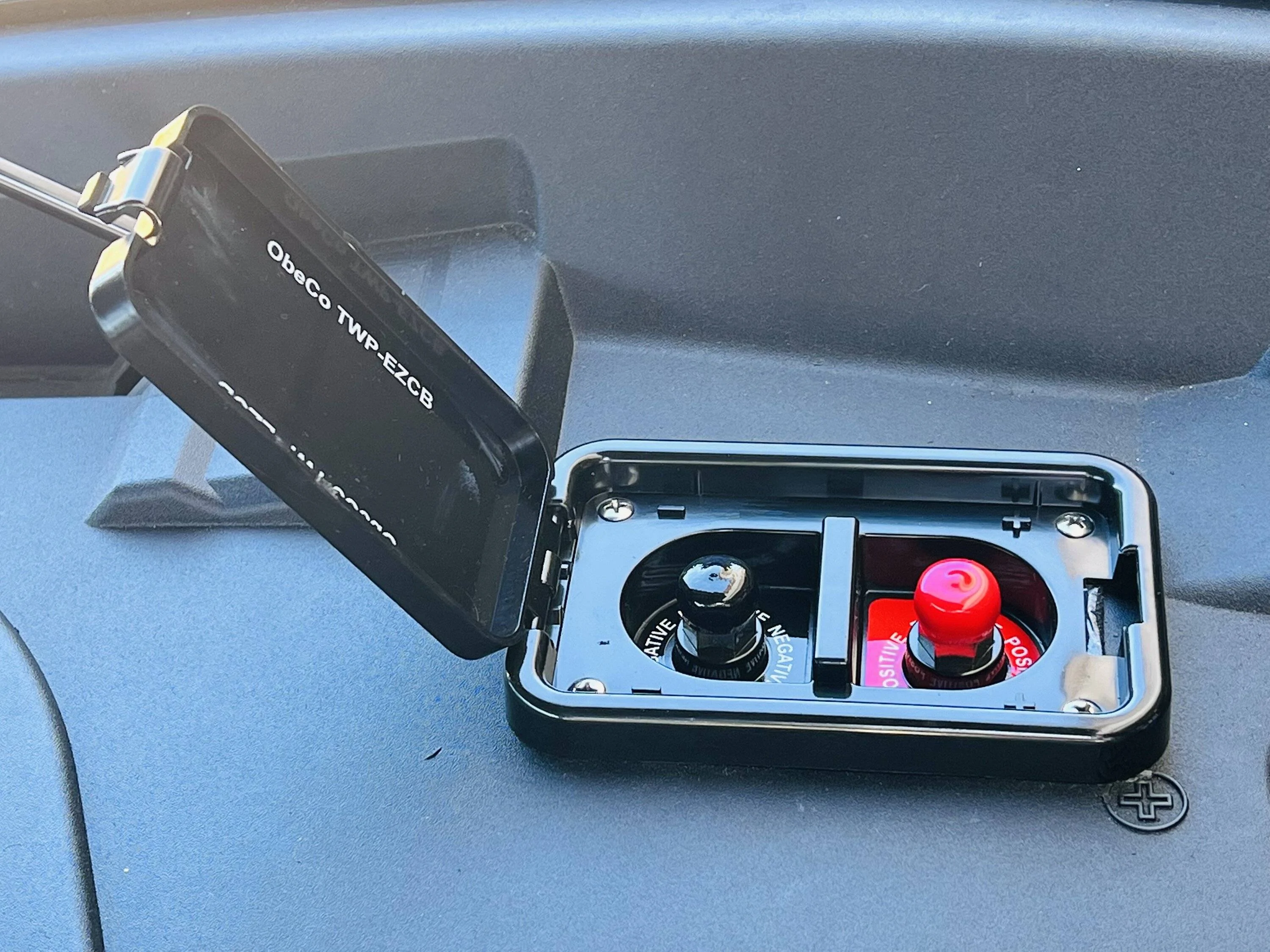

Oh man, run from that dealer and don't ever return. The IPMA update needs about 6 MME AGM batts worth of power to complete, ~120ah of energy. Consecutive updates don't turn on power long enough between them to get any meaningful charge. I have a 220ah LFP I set in the frunk for updates connected up via 10ga little jumpers to my 40a anderson I put in for that purpose. With the batt secured after a few short trips it will fully charge it back up.

Techs really, really, (really) do not like having to take the left side and back cover panels off the car to get to the jump points to connect up their powersupply. So a lot of them try to cheat and not use a powersupply at all, and then have programming failures when the little 12V battery drops to around 10.0 volts during the programming run. ....and all they had to do was follow instructions.....and use a powersupply.
Yep. Ford didn’t need to go this far:
Ford Mustang Mach-E Missing functions on recently bought mach e. IMG_3373
But they could have easily made a door in that left panel above the positive jump point and ground point. ?‍♂?

The BMS is attached to the negative cable that grounds to the chassis. One is not supposed to connect directly to the negative terminal of the battery because it bypasses the BMS. The conveniently located negative jump point is the Ford-approved terminal for that. You are correct that the positive jump point doesn’t matter. ??

The ford 12v BMS is mostly useless (for me, entirely useless). Besides, when connected to a charger, the DC/DC turns on voltage to 15v during the charge session. Post charging the BMS resets.

When my Lightning was receiving an entire day of updates, tech connected power supply to battery. Updates started failing after a while, because while the battery was fully charged, the system can't see that, so the module updates failed. Two members here correctly diagnosed the issue watching FDRS and the picture my salesperson sent me. Cable was moved to negative jump post, and updates completed.

That's strange, I've connected up my 280ah LFP batt directly to batts in both of my fords and ran a days worth of updates with no issue. I keep a LFP in my F150 and its resting voltage is 13.3v. I've done extensive testing to determine the logic of the worthless BMS and have found how to keep 12v generation alive. The PB F150 has the same 12v logic of the BEVs with identical charging system in that it uses the 220a DC/DC to power the 12v system. In order to keep 12v generation alive while the key is on, the keyfob must be in the vehicle and the HVAC blower motor must be set to position 5 or higher (and the doors closed).
