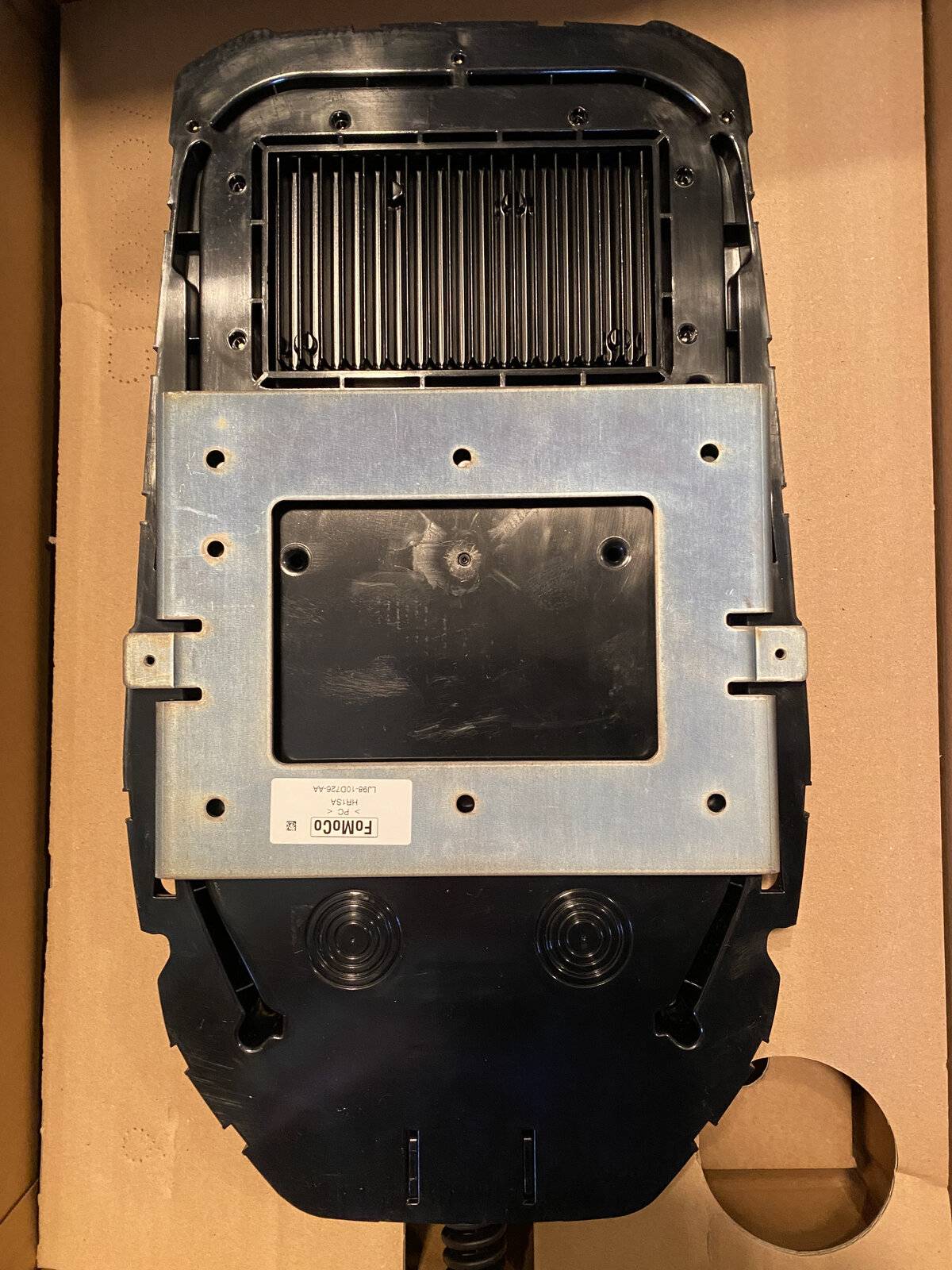

Thank you @SAVAGE and @TheVirtualTim!!!
SAVAGE since yours isn't mounted yet, would you mind measuring the metal plate for us? (It's outer dimensions and the inner rectangle, as well.)
Were there any other points of interest in the manual?
I'd really like to see a photo of the specifications page where it shows the operating temperature range.
I'm happy to see that it works down to 16/20A as well as 40/50A settings. This gives me much more flexibility for my garage's current circuitry than just the 48/60A default.
Also, it looks a bit smaller than I'd originally thought (that's a good thing).
I know some people were looking for confirmation that a bottom knockout is available for bottom feeding the supply conduit.

SAVAGE
SAVAGE
Jefferson
316
Iowa
MME
Ford Mustang Mach-E My Ford Connected Charge Station arrived! 1612361666362
Here is my feeble attempt at showing the size of the mounting bracket. Later today I will attempt to scan the manuals and post them on here.
