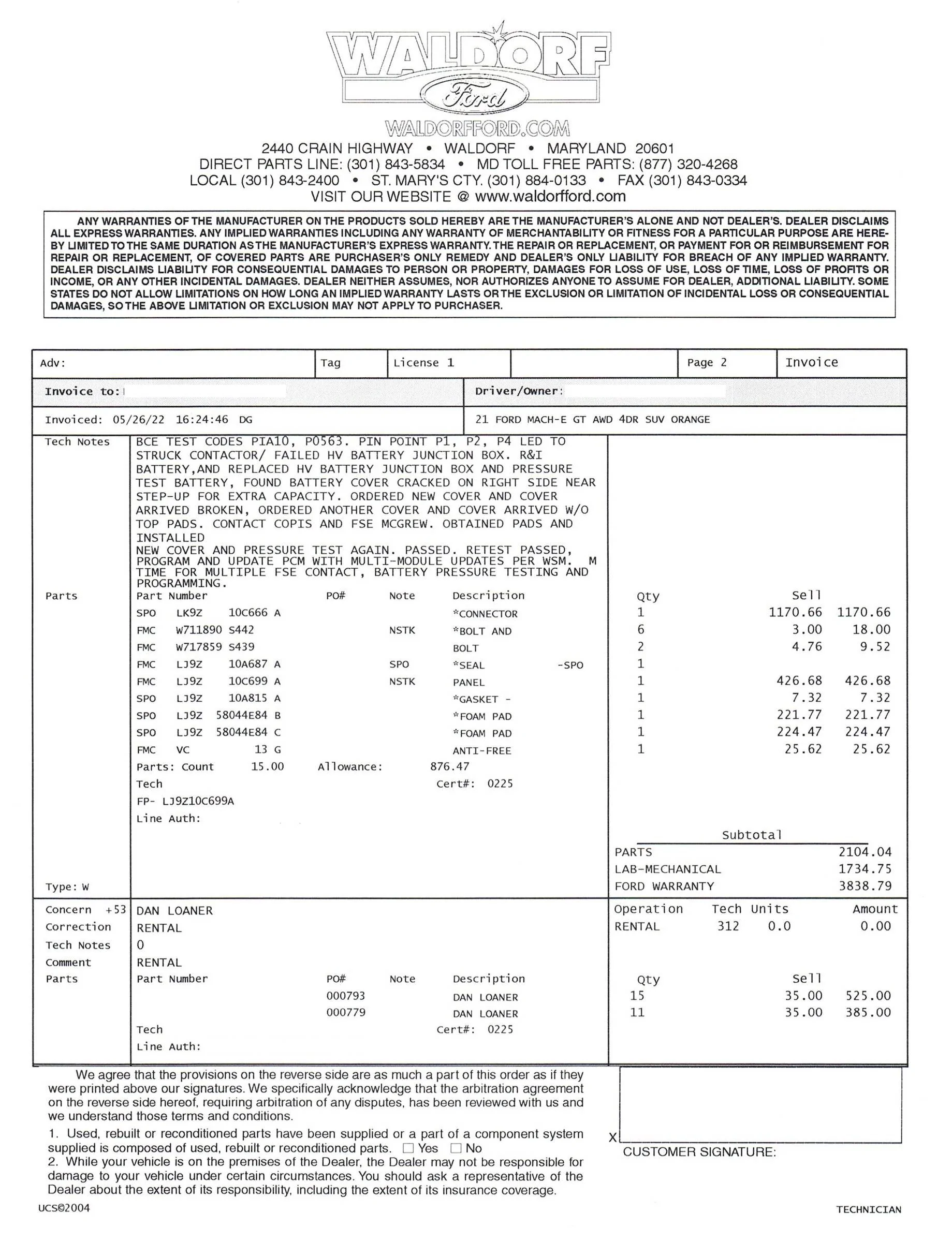

Got the answer from my dealer: the left-side pads are part number LJ9Z-58044E84-C. Not sure if the last-letter difference is just a revision, or if they're truly separate parts, but both -B and -C comprise the full set.
-B is the full set, -C is a subset. Use the number I gave. Looks like they need to fire their parts guy cause he can't read. ?

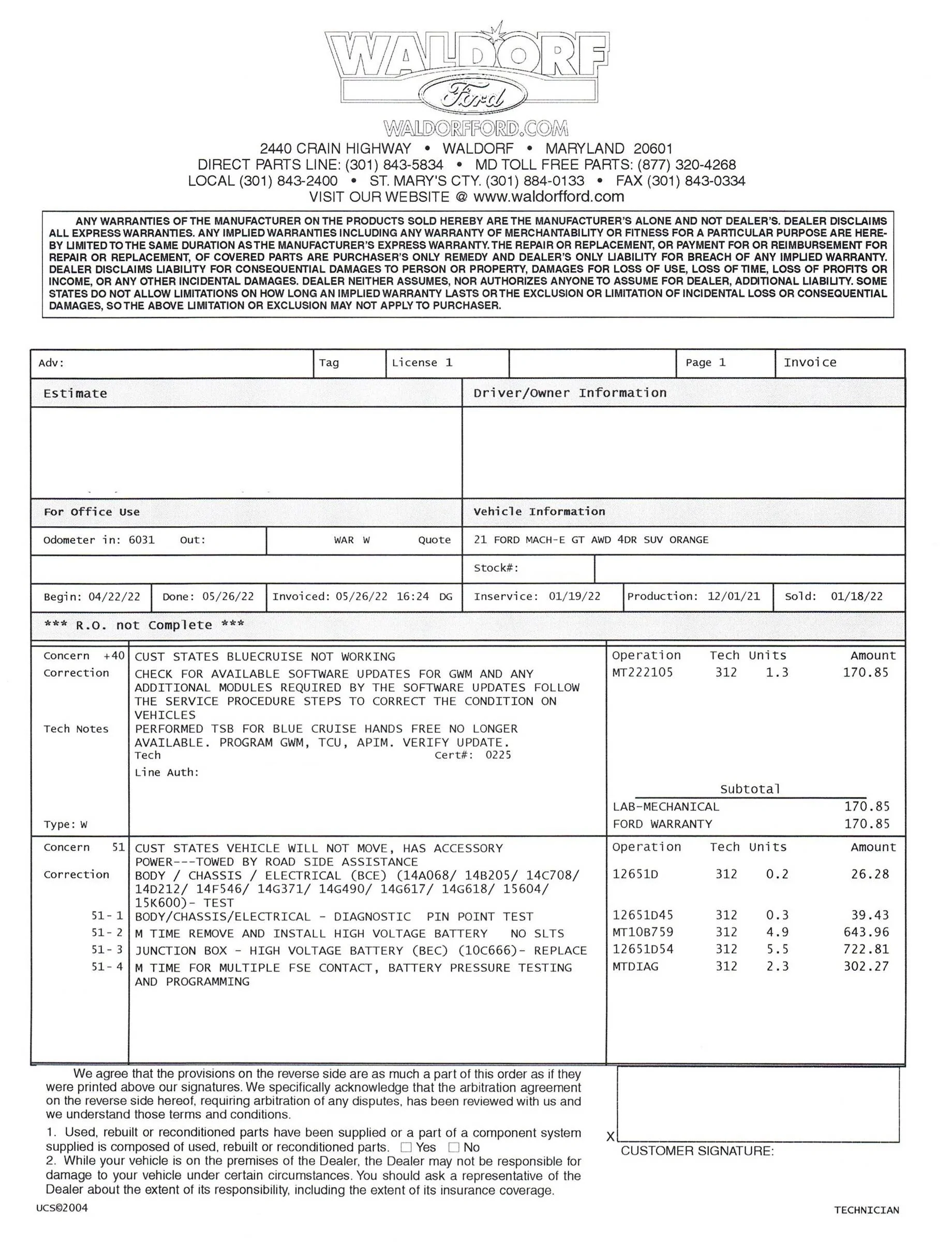

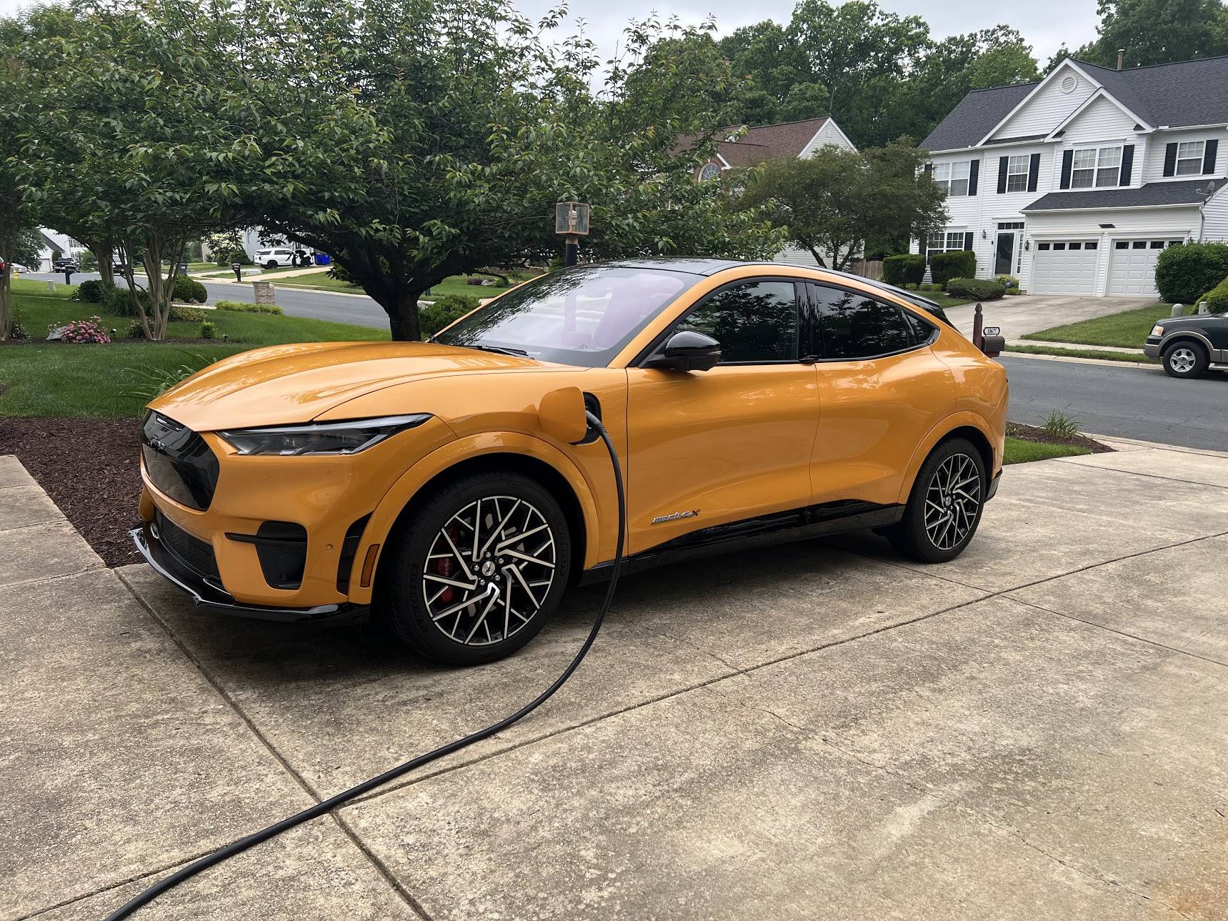

SHE'S HOME!
Battery cover re-installed last night, pressure-tested and powered up. Today was spent on software module updates. Ready for pickup at 3PM today.
She's back where she belongs!
Ford Mustang Mach-E My "Stop Safely Now" Saga IMG_3231
Ford Mustang Mach-E My "Stop Safely Now" Saga IMG_3232

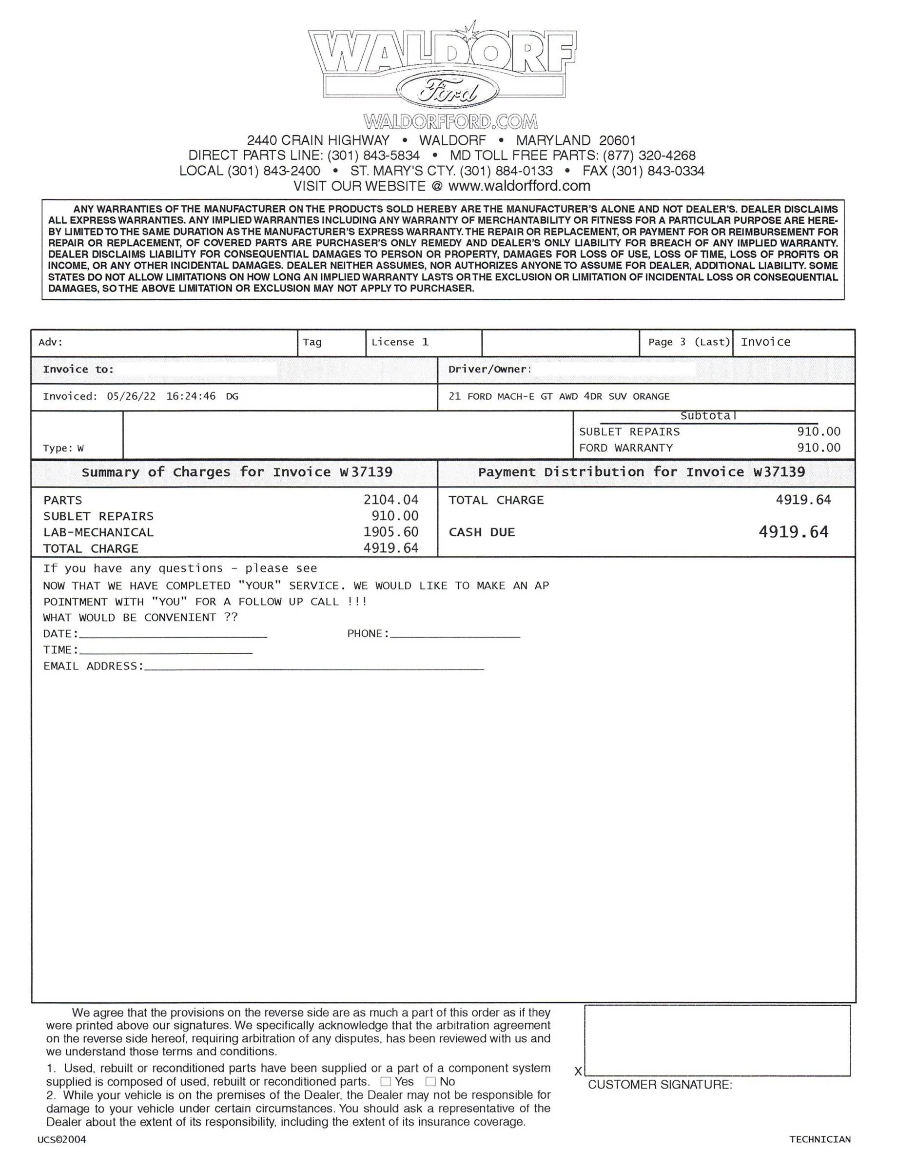

Cost breakdown:
Stop Safely Now: $2,104.04 parts, $1,734.75 labor, $3,838.79 total (charged to factory warranty).
Loaner: $35.00 per day for 26 days = $910.00.
BlueCruise TSB: $170.85 labor (charged to factory warranty).
Total cost for service: $4,919.64 (total cost to me: $0.00).

Repair order:
Ford Mustang Mach-E My "Stop Safely Now" Saga RO_Redacted_001
Ford Mustang Mach-E My "Stop Safely Now" Saga RO_Redacted_002
Ford Mustang Mach-E My "Stop Safely Now" Saga RO_Redacted_003
