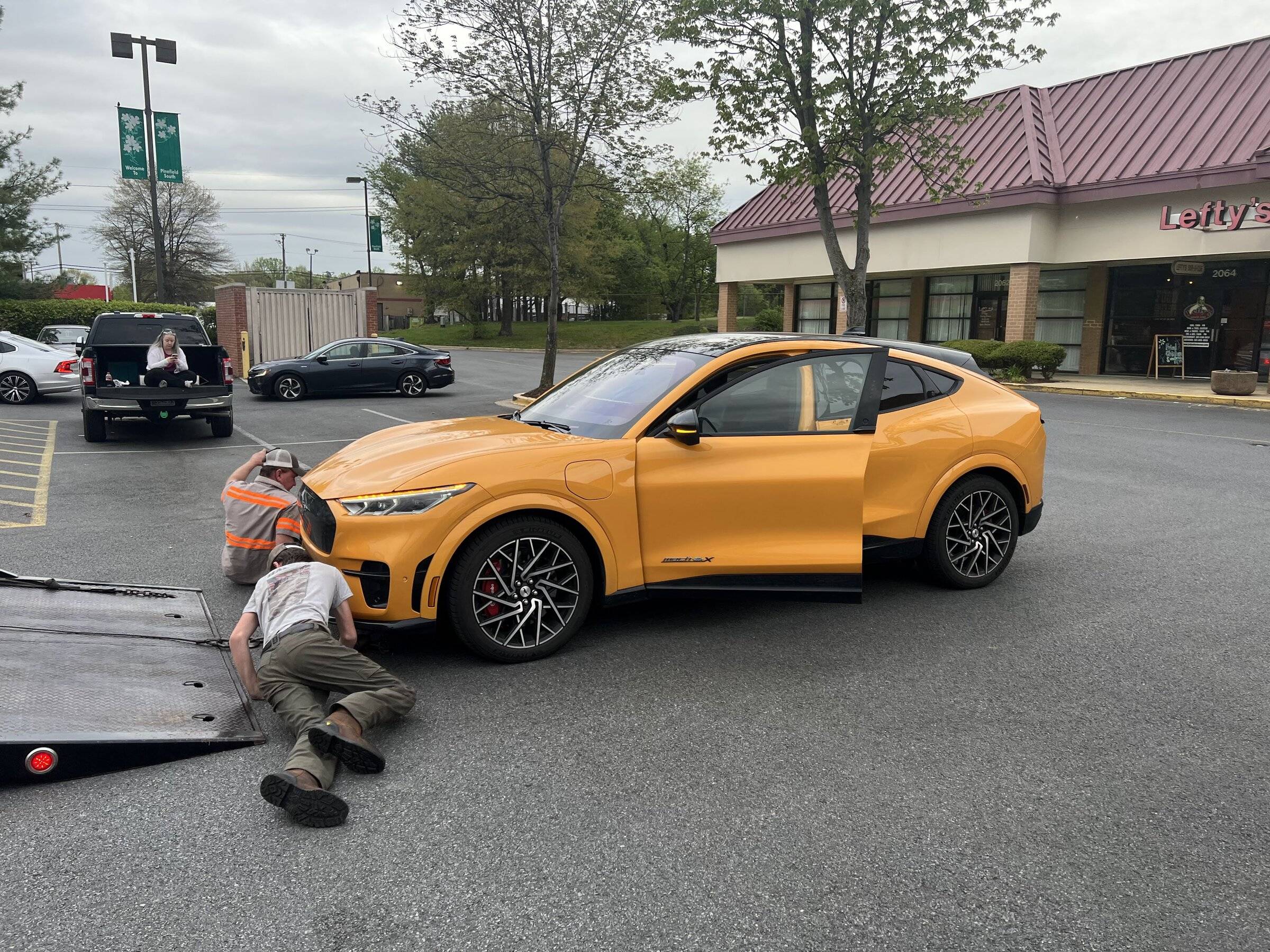

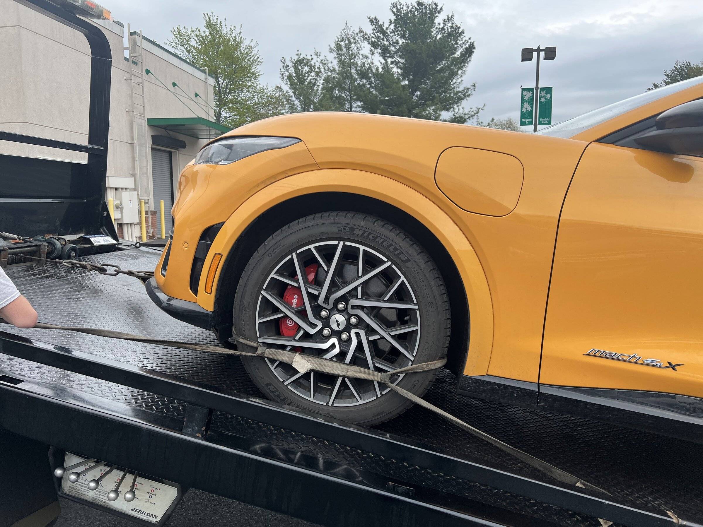

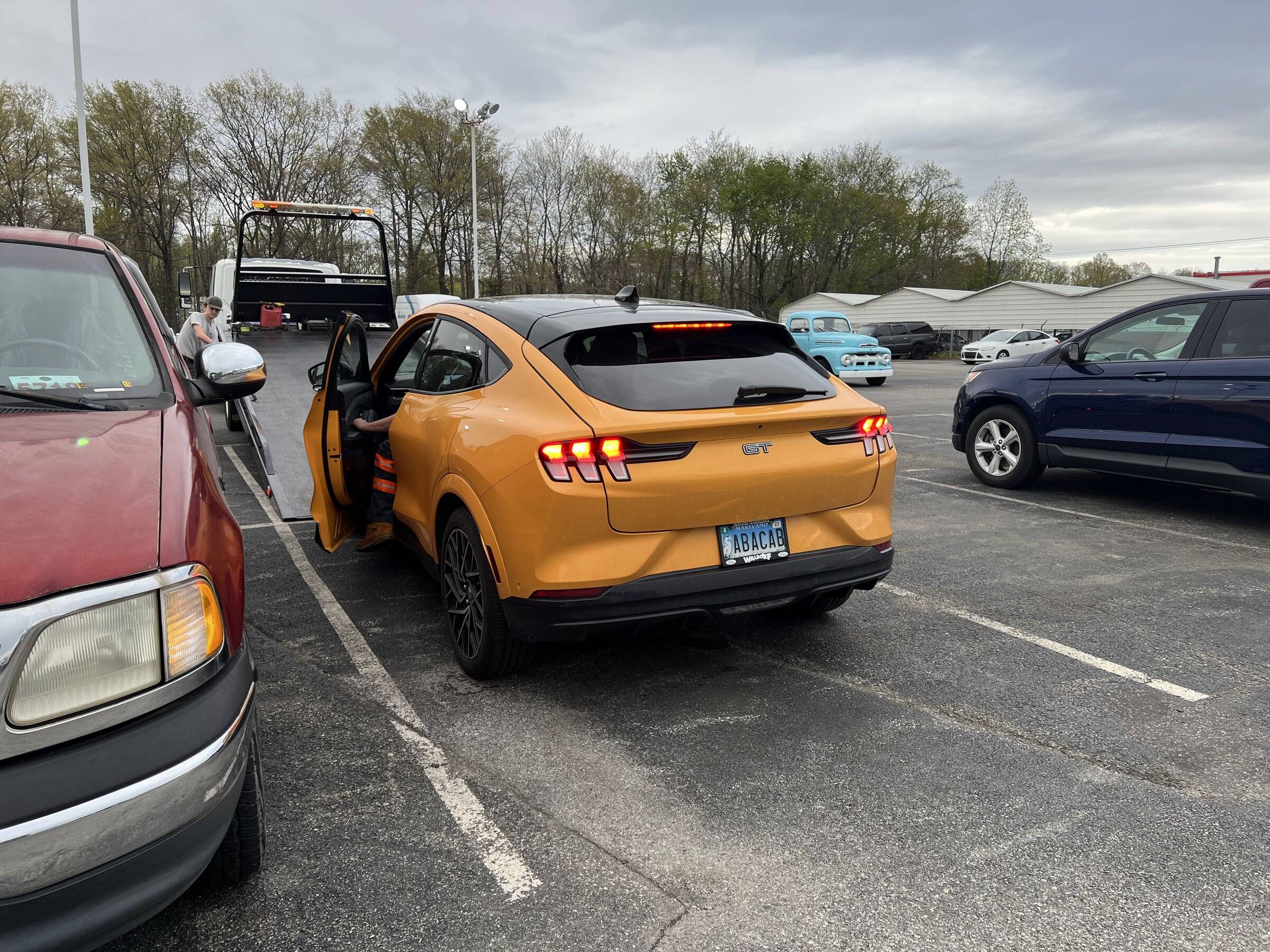

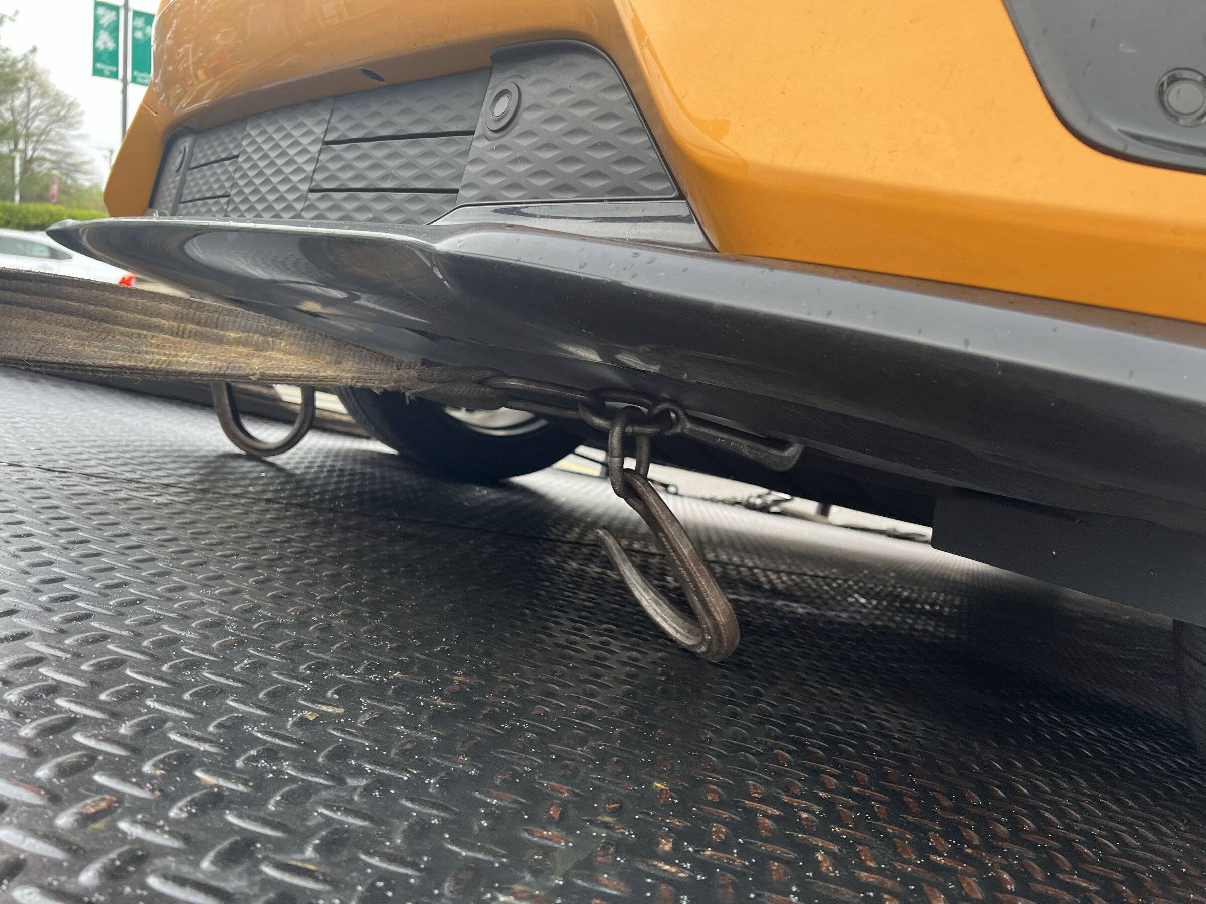

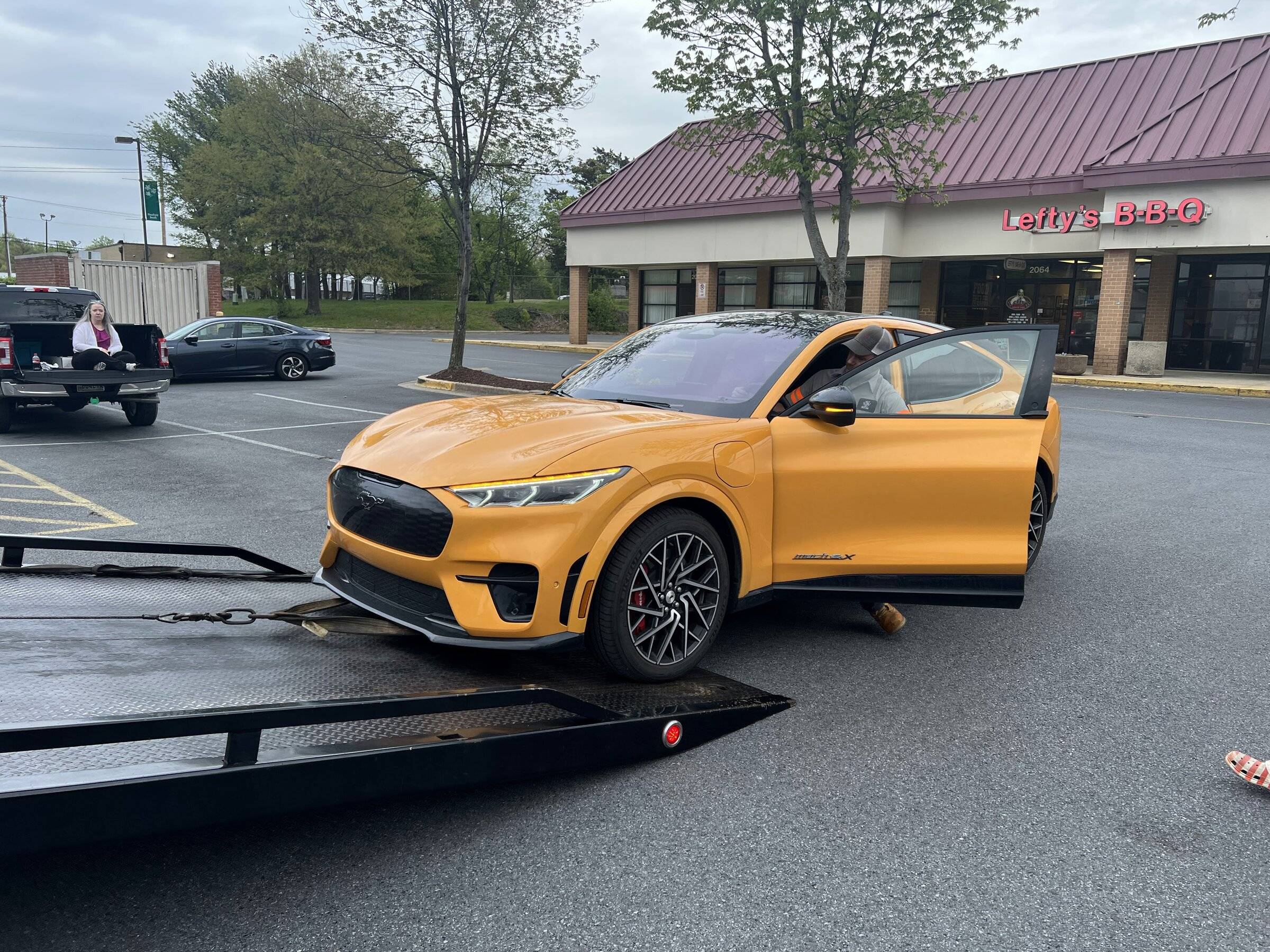

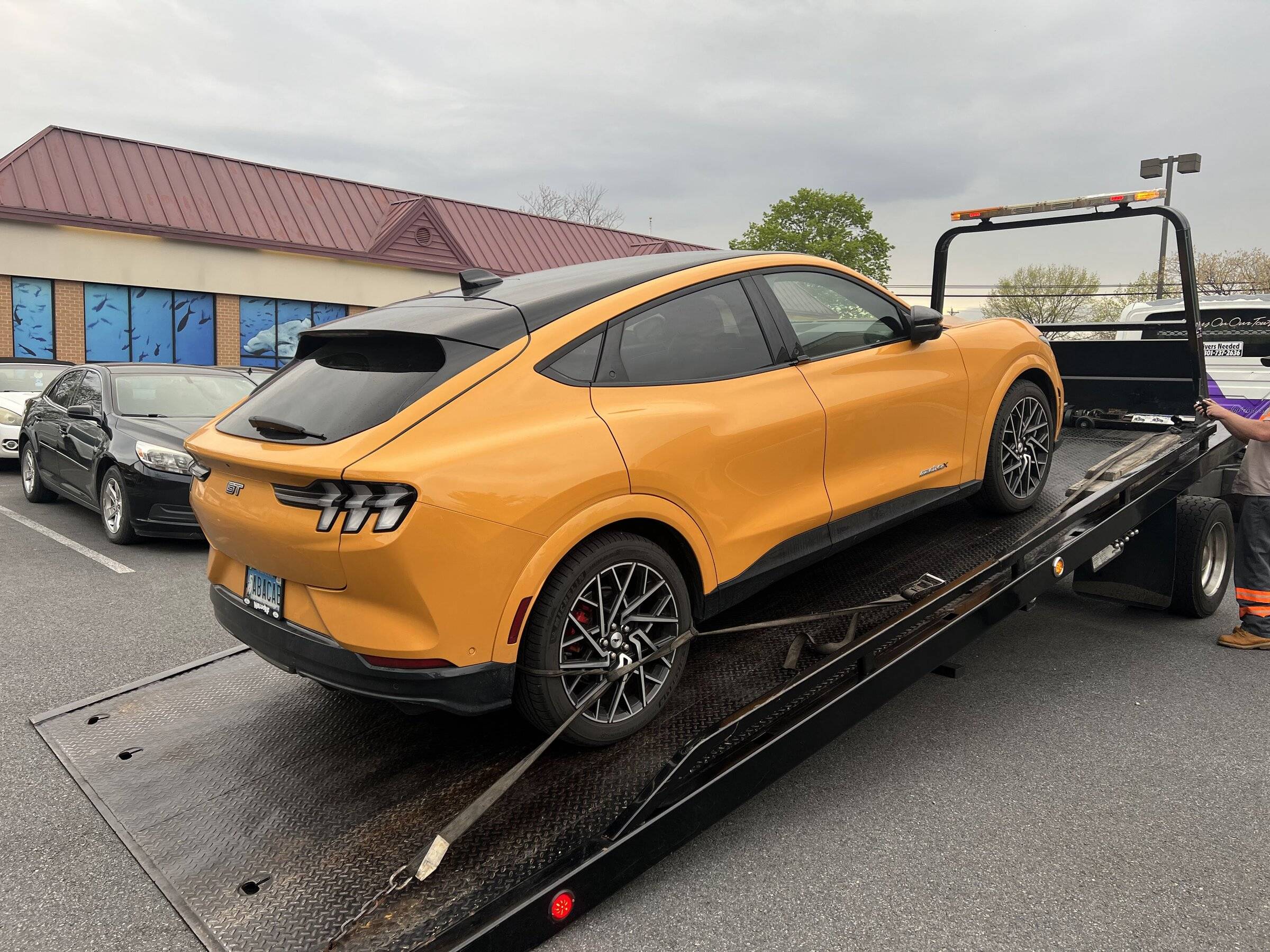

Stopped on the way home from work to do some shopping, came out to leave to find the "Stop Safely Now" error. Repeated attempts to re-start were unsuccessful. I waited 30 minutes to no avail. Called Ford's Emergency Roadside Assistance, and the first truck arrived after 30 minutes. Driver stated that because I was in a parking spot, he would need to charge an additional $100 "fee" to load. I refused and called Ford again, who dispatched another company. I had to wait an hour, but they arrived and quickly and easily backed the car into a spot where they could load. (Note I was able to get the car into Neutral using the center screen, as my 12V battery still had capacity.)
The tow driver had never loaded a Mach-E, so I was glad I'd downloaded the Towing Point PDF found on this forum. He quickly and easily got the car onto the flatbed, drama-free.
Watching her roll away from the passenger seat of my wife's F-150...
Offloaded at my local Ford dealer, luckily only a five-minute drive away.

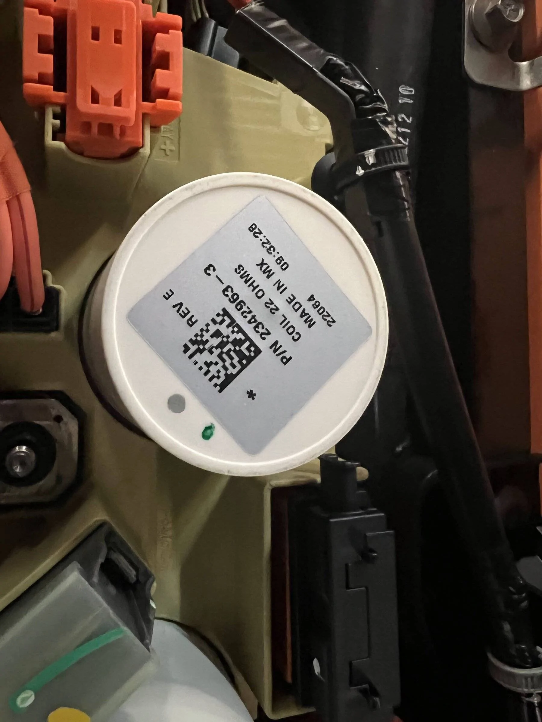

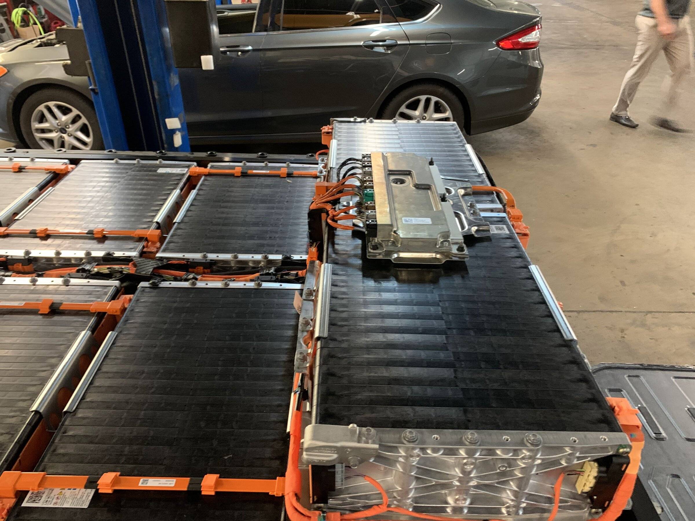

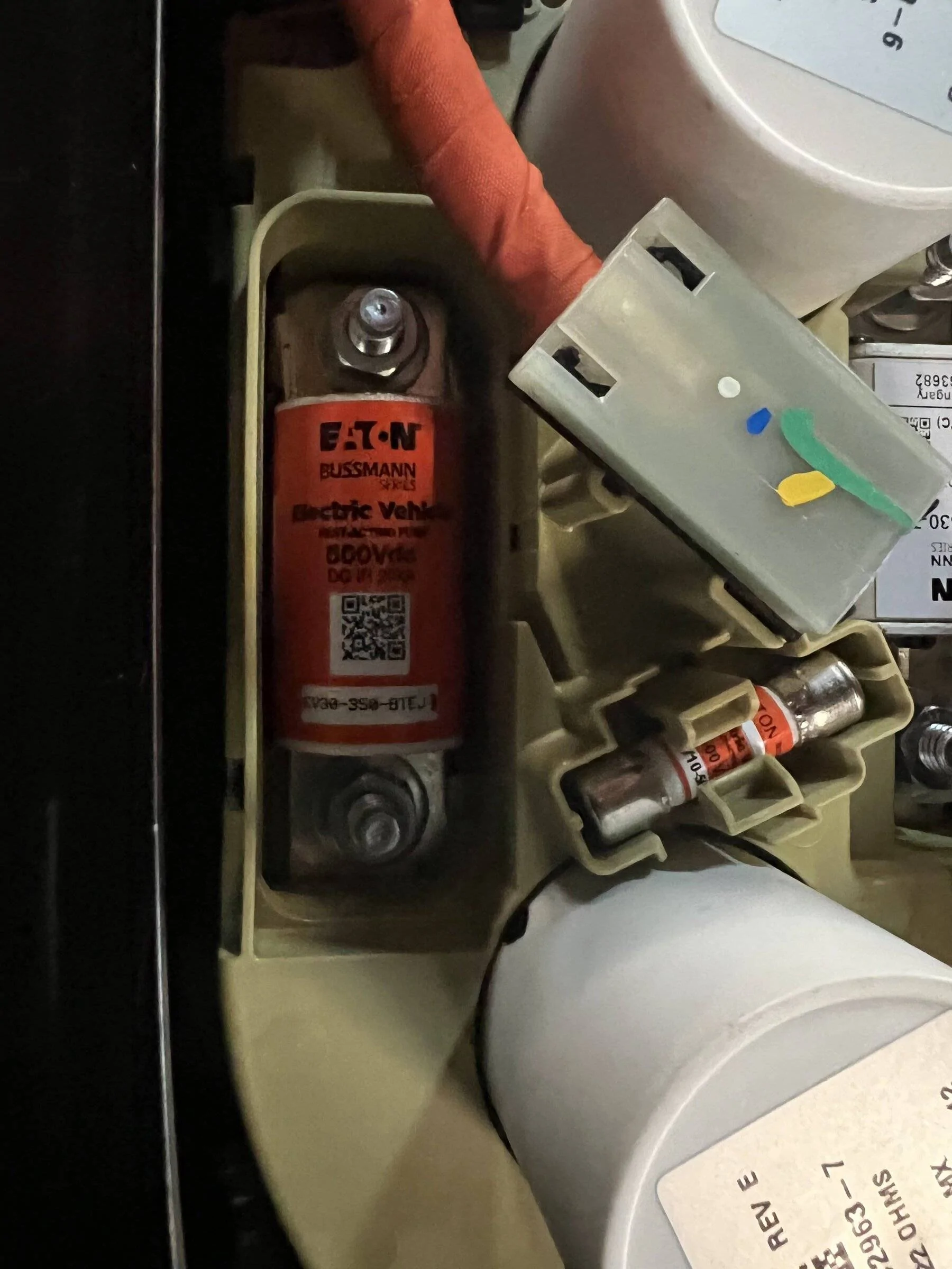

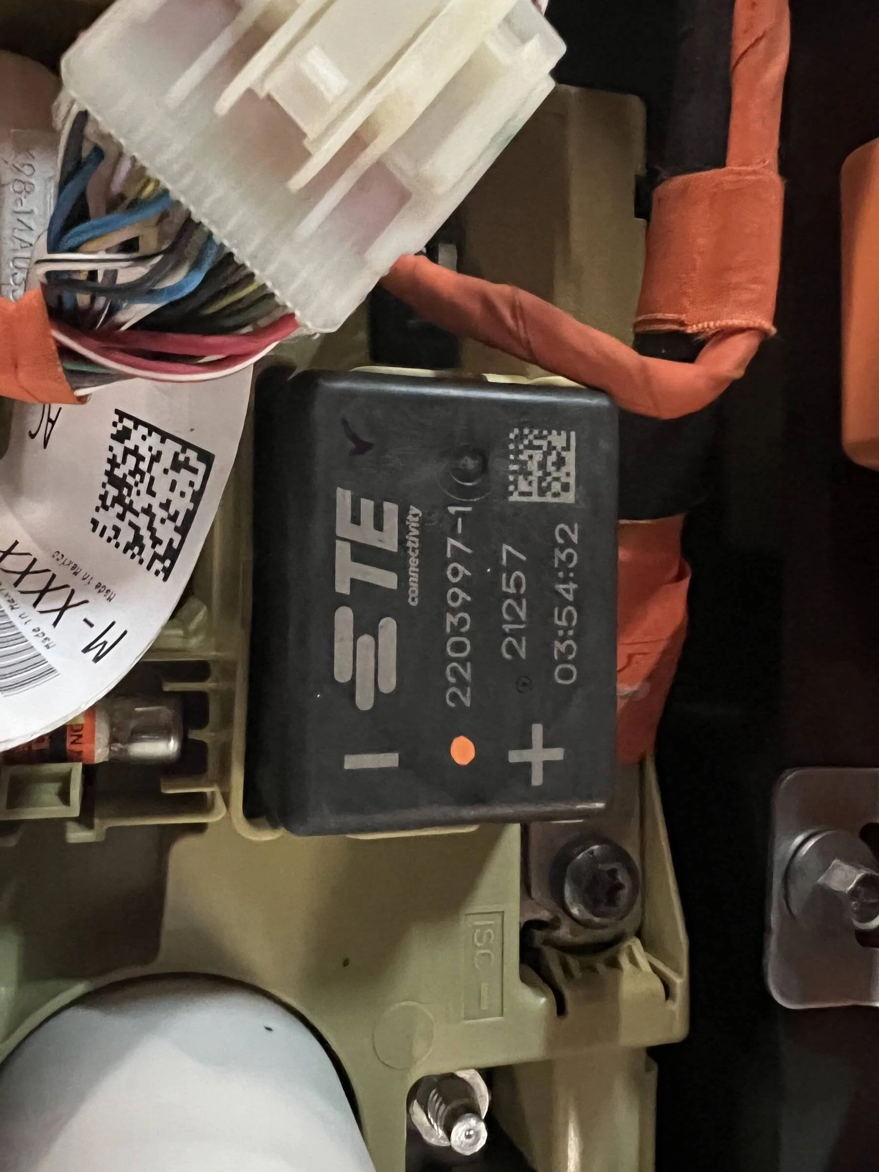

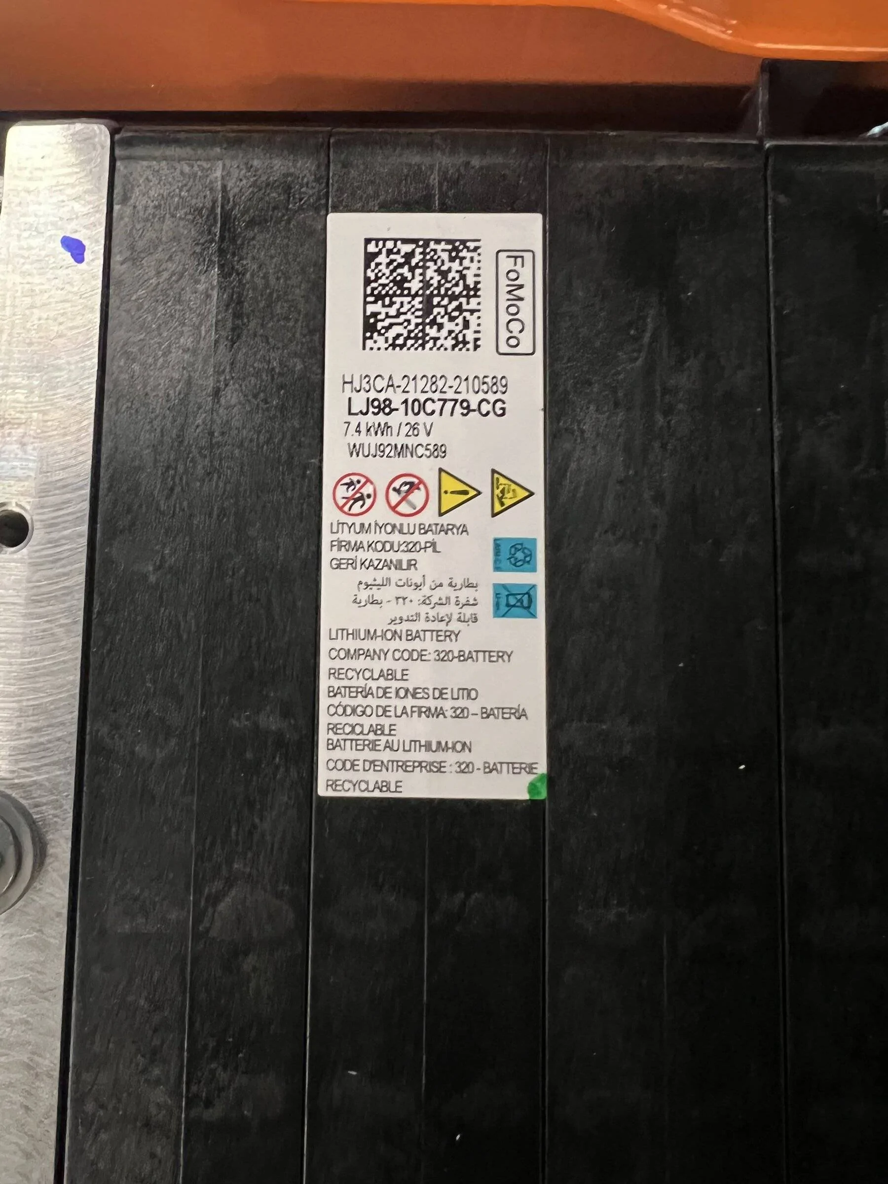

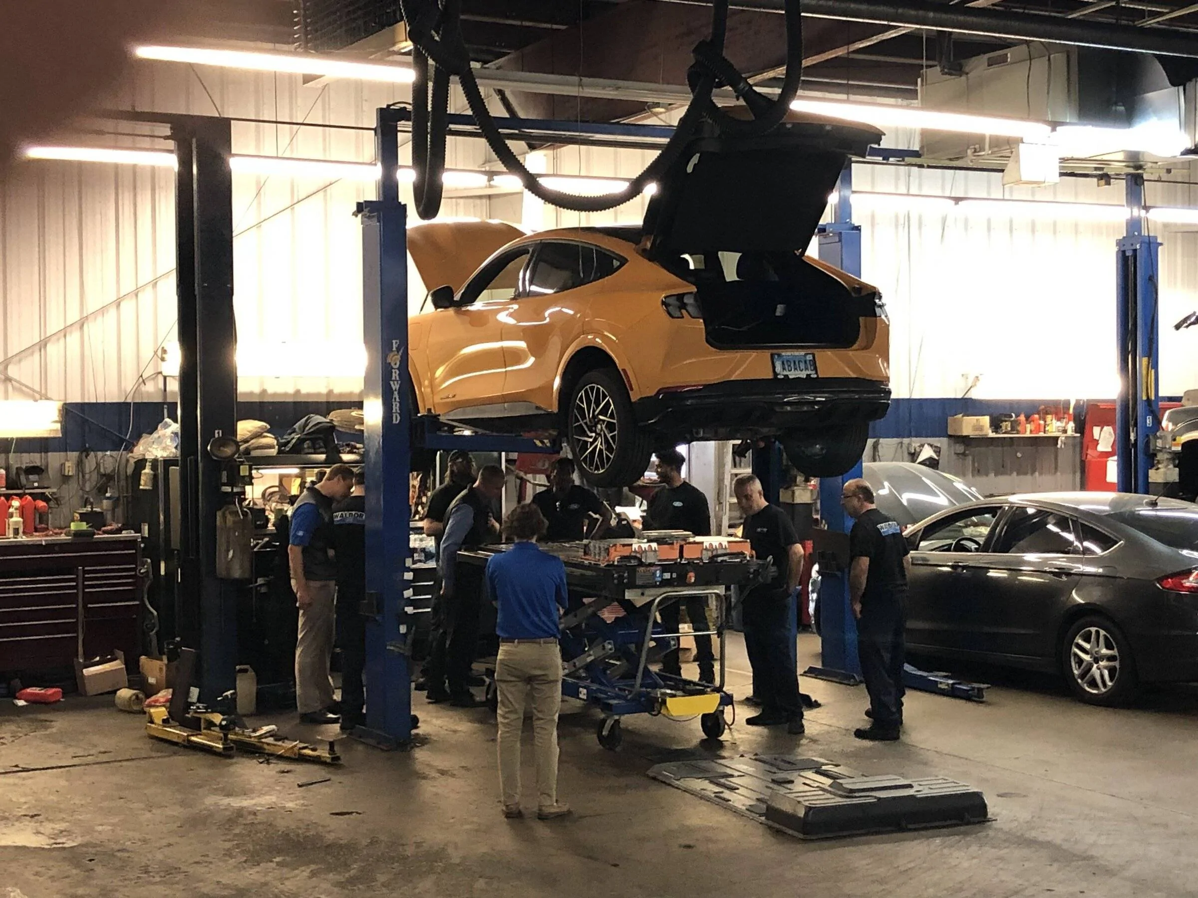

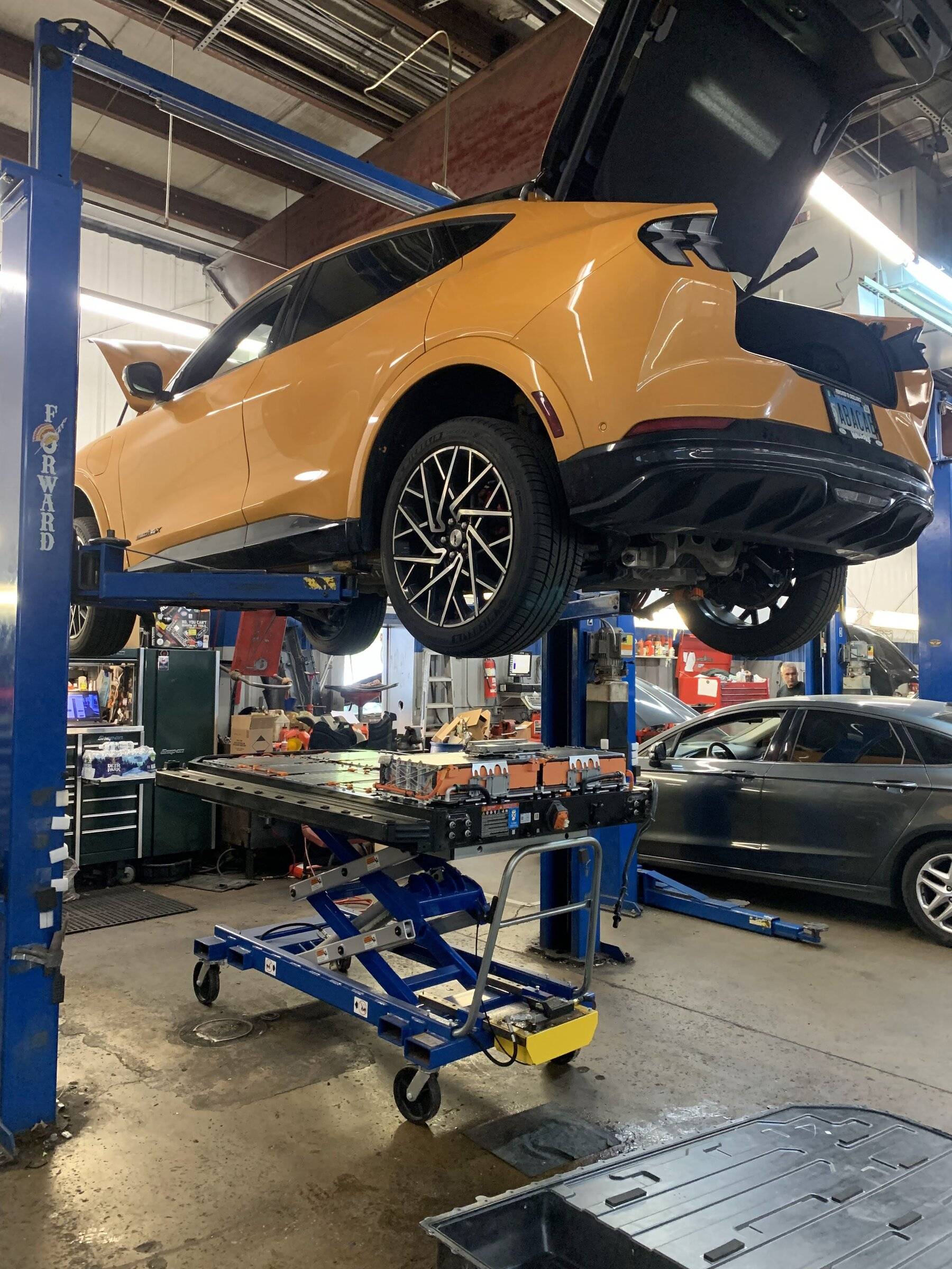

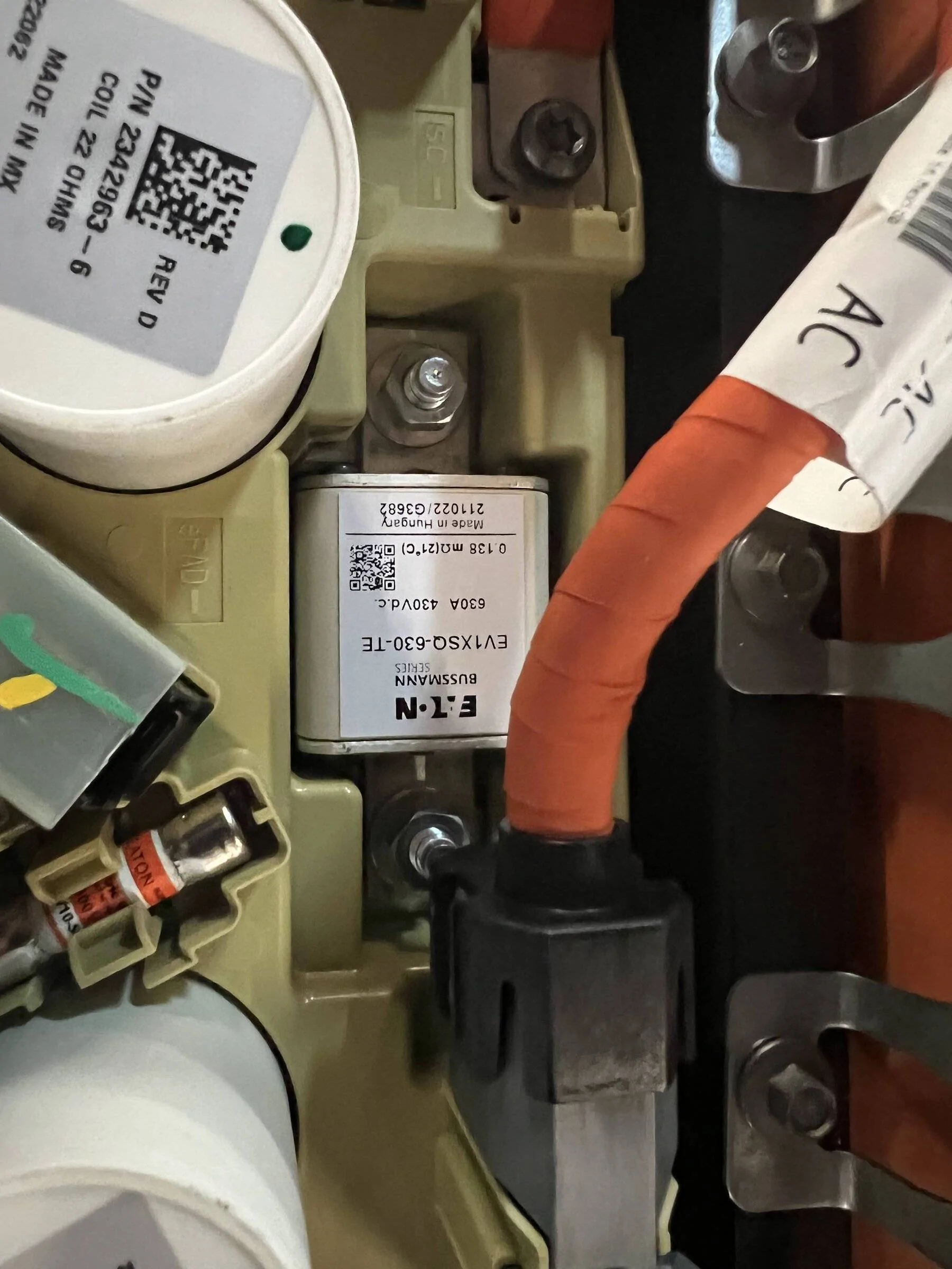

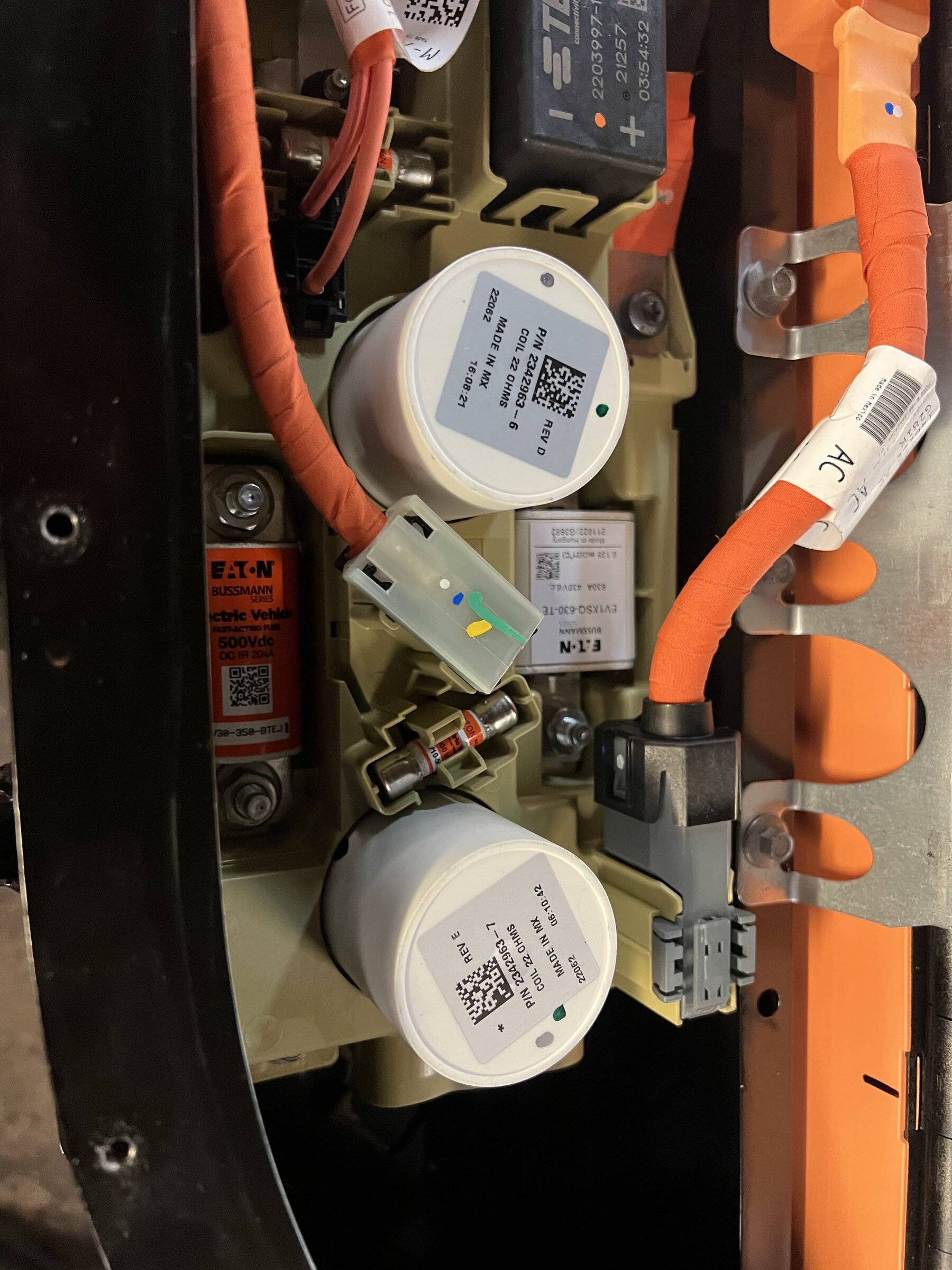

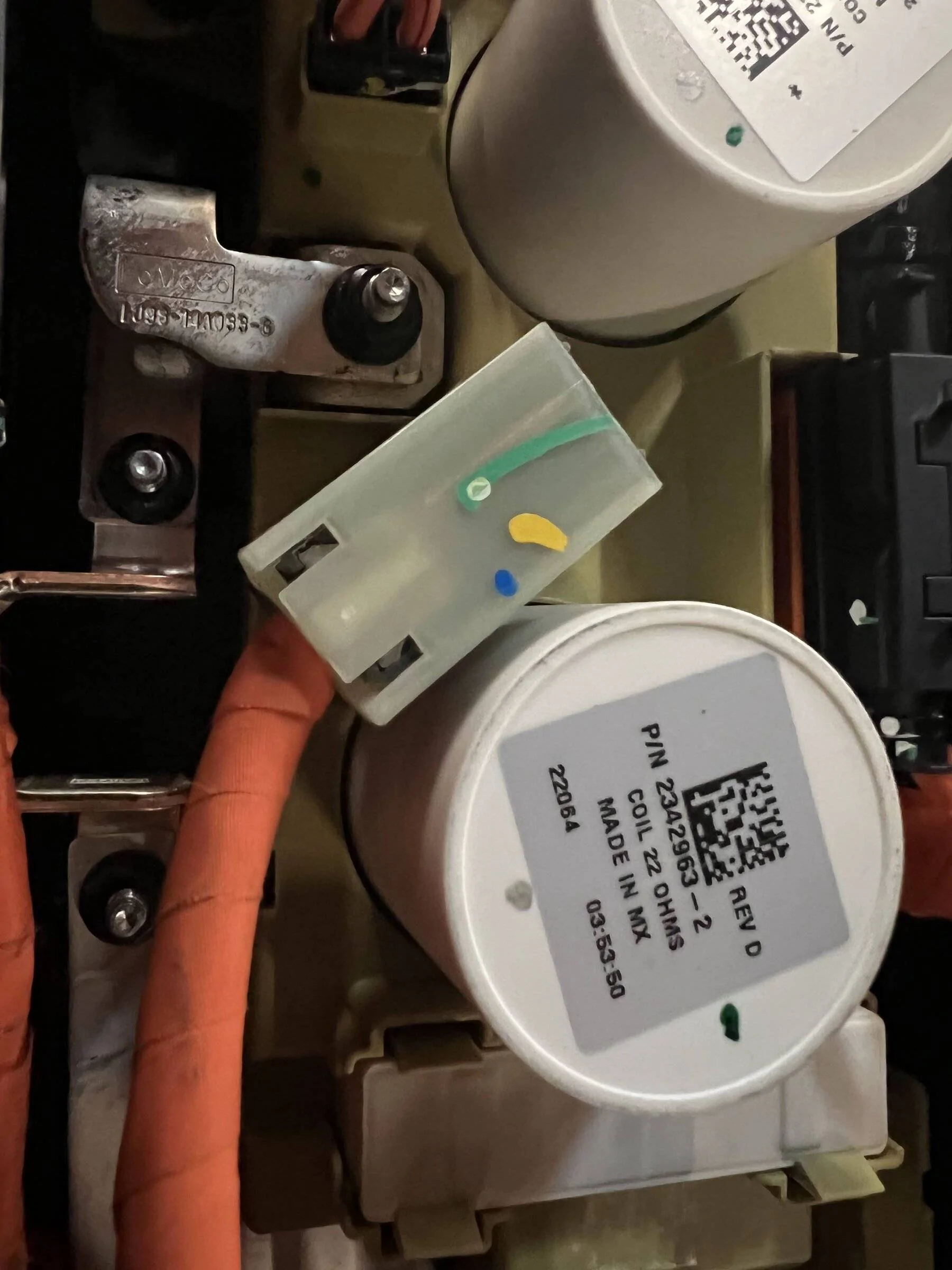

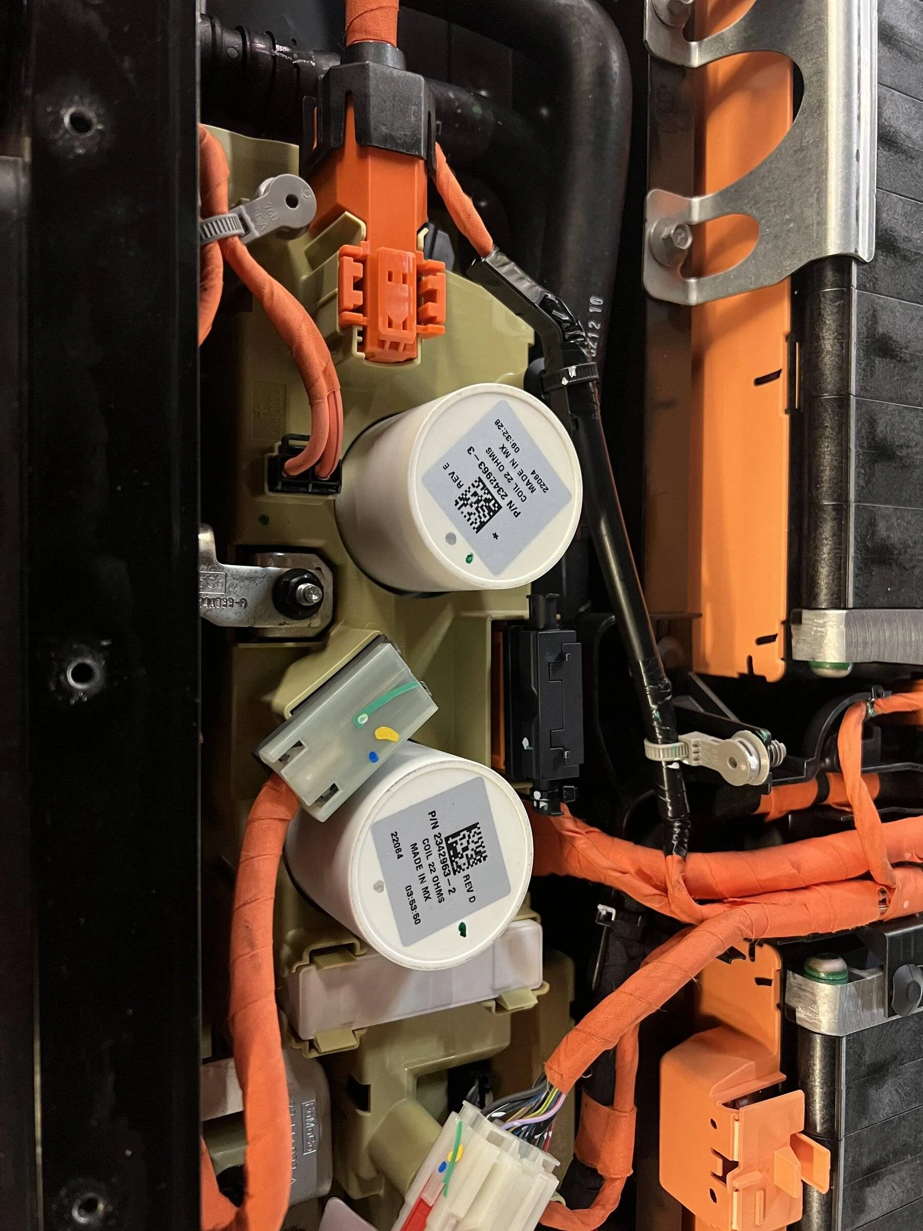

In-progress pictures sent by my service manager and tech. Notably, mine is the first Mach-E whose battery has been removed, hence the great interest from the entire service department!
Thursday, May 5:

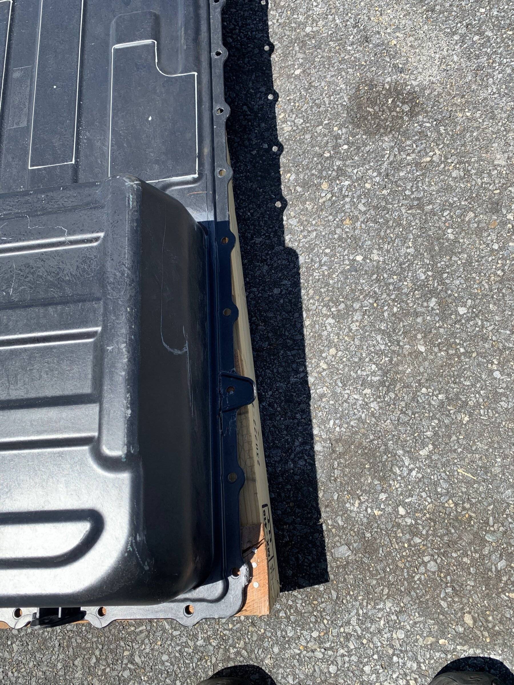

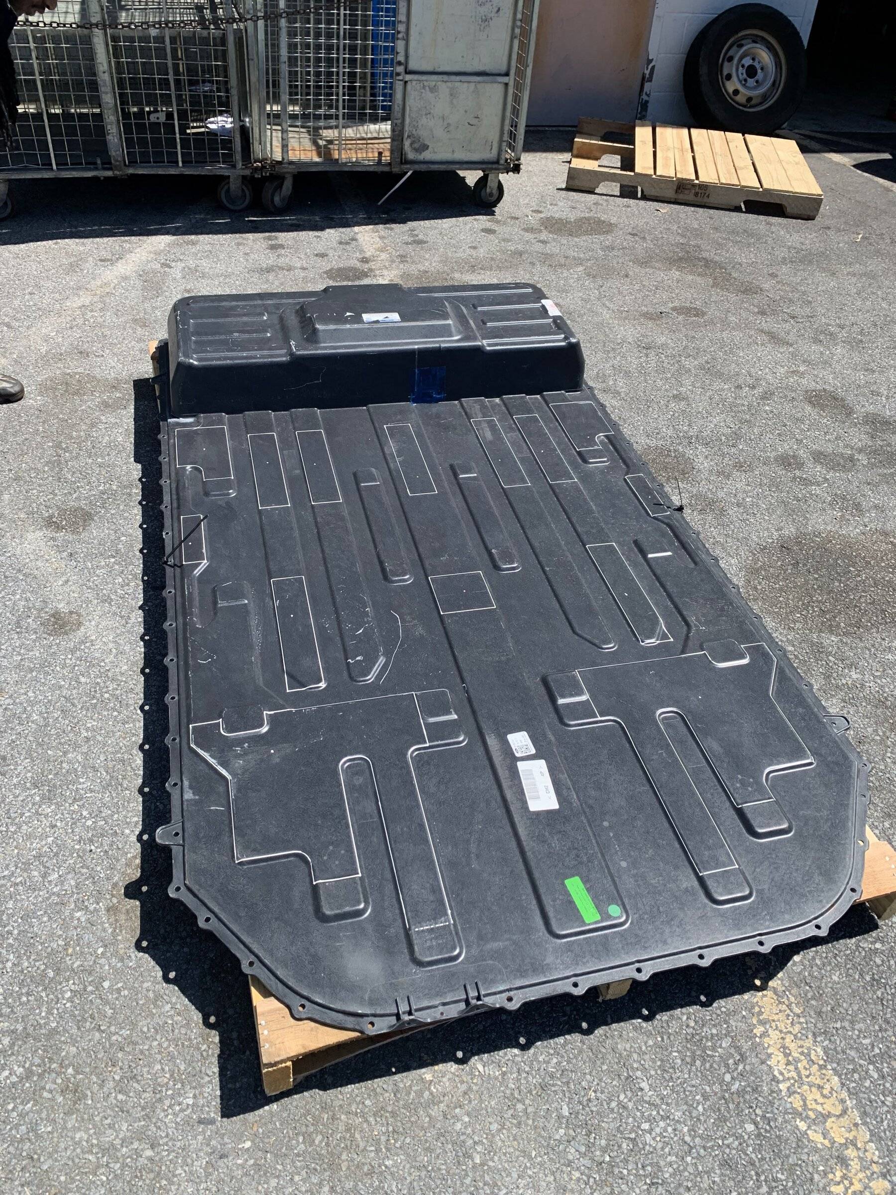

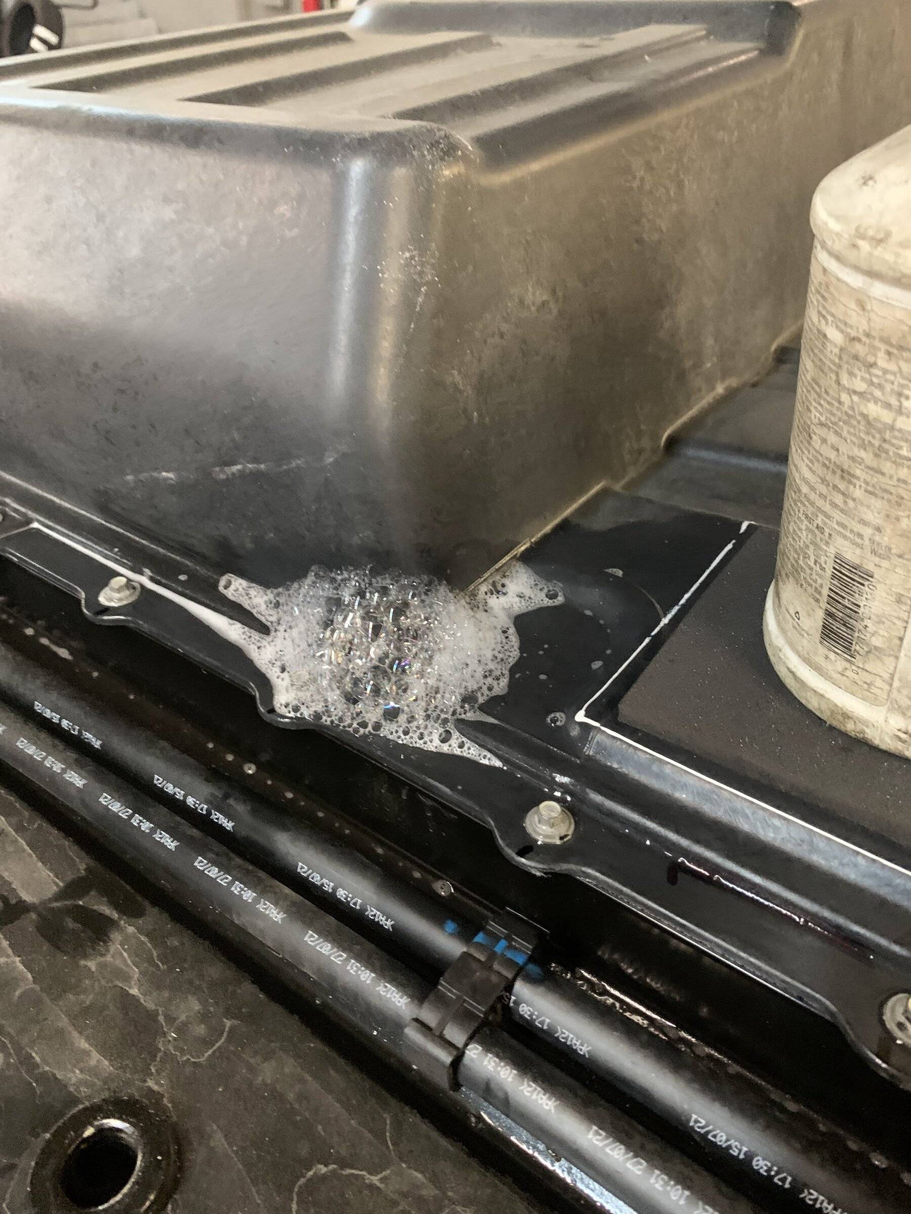

Good news, bad news. Good news: HVBJB replacement complete with no issues. Bad news: pressure testing of the reassembled battery failed. Small crack found where the battery cover rises up to cover the array under the rear seat. Great quote from my tech: "Apparently these things are made of eggshells!"

Visited dealer to inspect cracked battery cover and to sign an extension of the loaner agreement. New battery cover ordered, ETA 3-5 days. As my service manager and tech watched me carefully photograph every item with a part number, they muttered, "You are SUCH an engineer!" Guilty as charged!

My dealer received an intact battery cover, which came equipped with the foam blocks on the bottom (facing the battery internals), but NOT on the top, even though the parts catalog says it does, and there is no separate part number call-out for the top foam blocks. Tech is working with the Parts Hotline and a Field Service Engineer to get the blocks ordered. He was at least able to re-assemble the battery and start the leak test. Fingers crossed!
