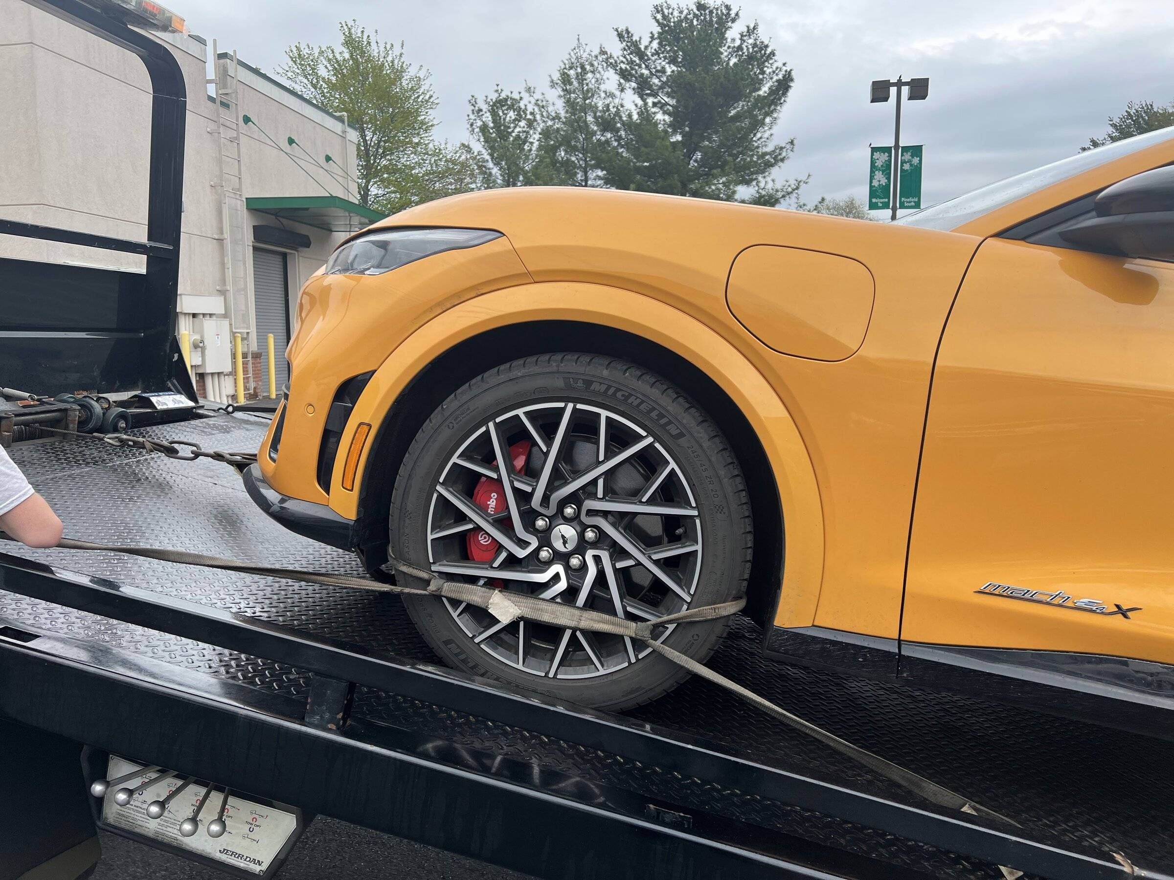

UMM Interjection here as i did not want to read the entire thread. I would question and double check where the wrecker hooked it. I had mine towed in for same issue so welcome to the club, but the If I am not mistaken the tow point is behind the front axle. I might be wrong but the placement of the tow hooks worries me...
Just my 2.5 cents.
The tow points are in front of the front axle, which looks correct in the pictures. You may want to double check yours for damage if they grabbed it from behind the axle.
LOL I was just actually looking it up and mine was hooked up wrong. Damnit. Well my car went down twice for the same thing so maybe that is why it went down the second time.
Apologies all. You may continue..

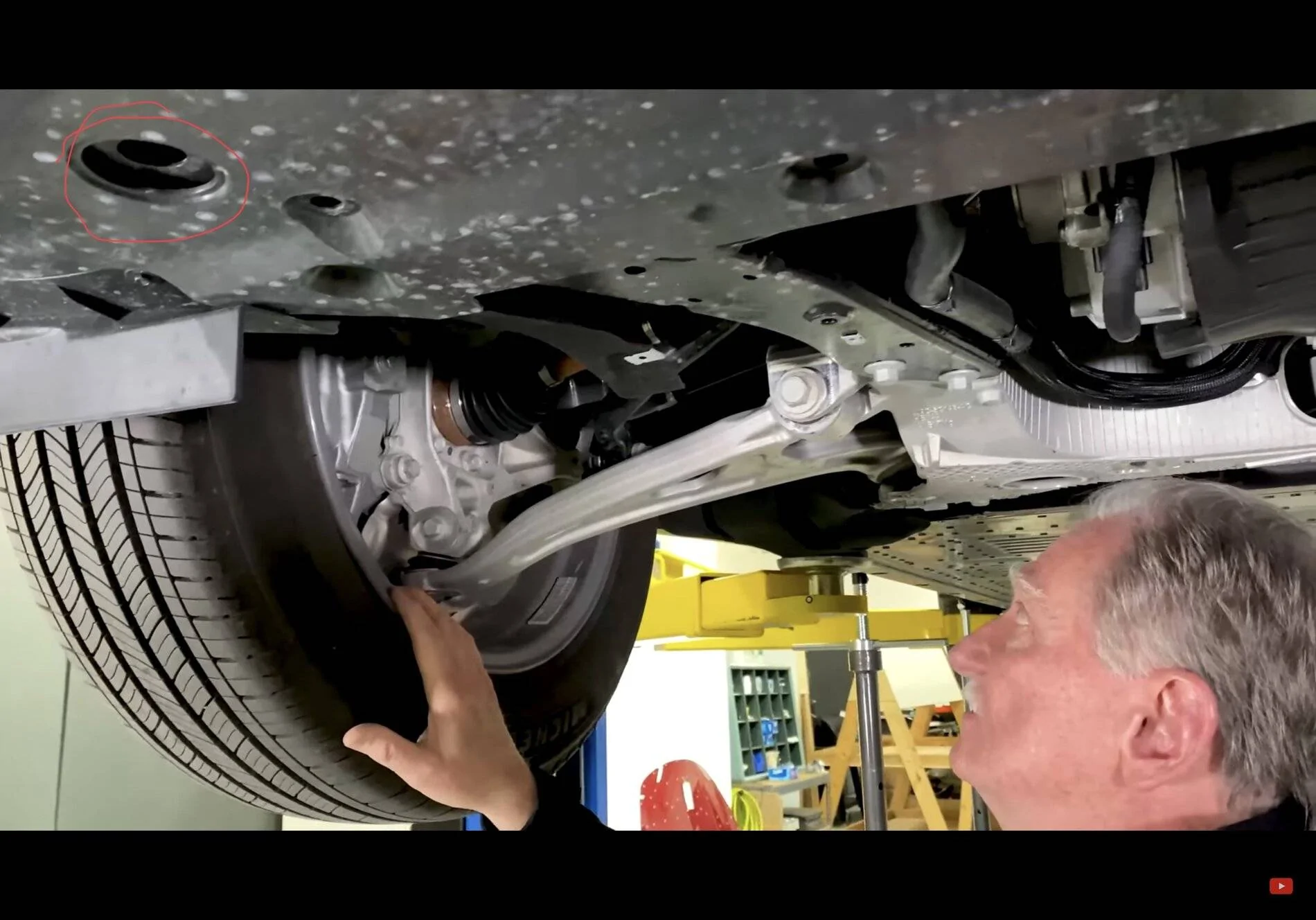

Just my 2.5 cents.
Nope.
Look under the front of your car. You will see two holes in front of the front wheels. That's where to tow it.

Here is a picture of what the tow point looks like. There is one on each side behind the front bumper.
Ford Mustang Mach-E My "Stop Safely Now" Saga hook
And the wheel strap is the correct way to secure the car to the tow bed.
Ford Mustang Mach-E My "Stop Safely Now" Saga wheel stra
