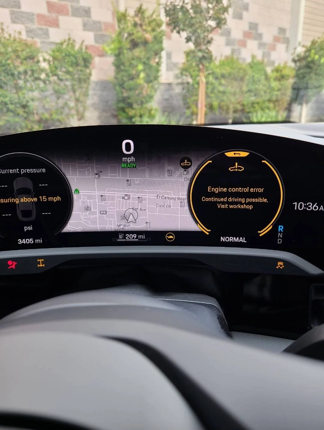

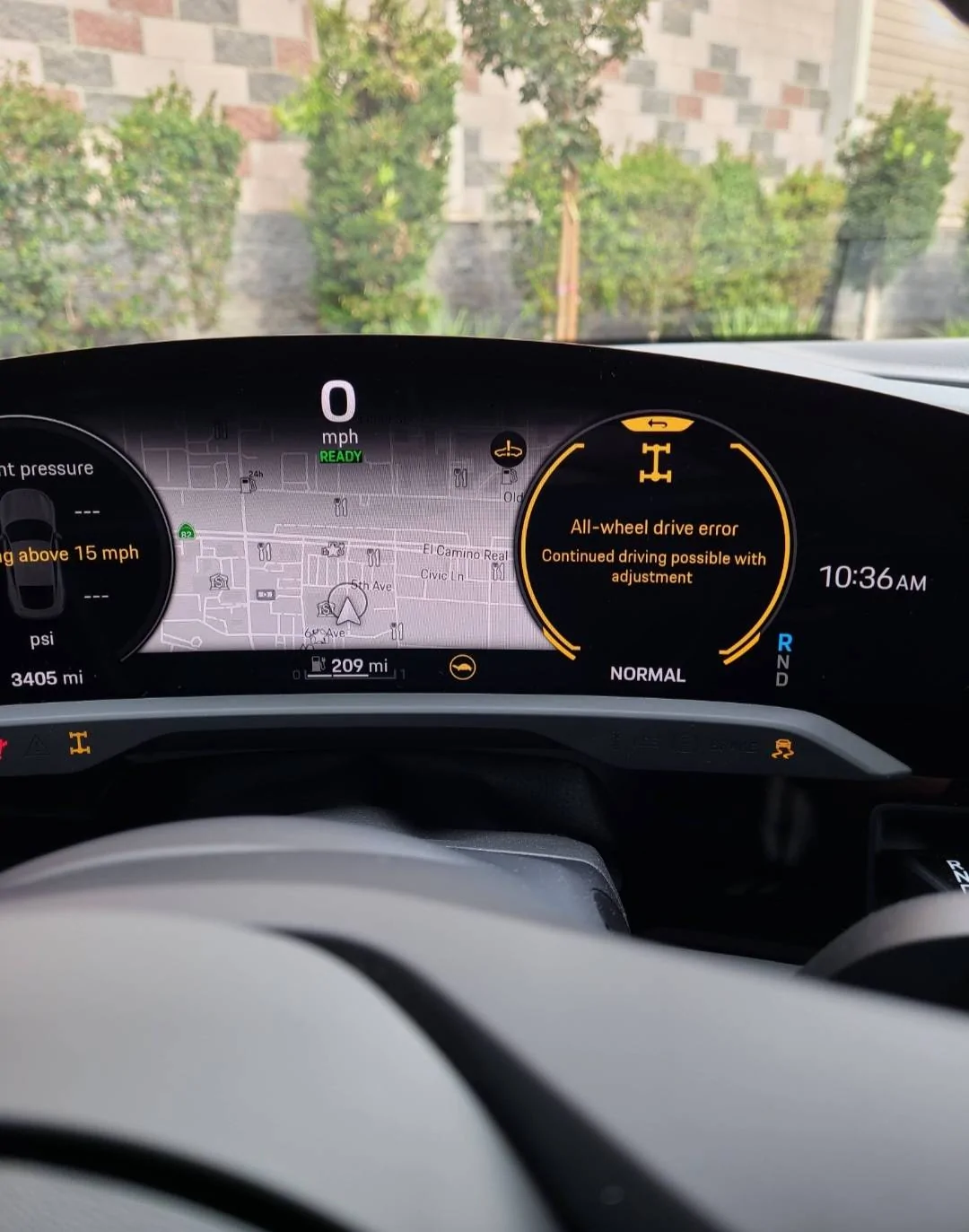

Taycan had 88 reports and only sold just under 12,000 units or 1/4 of the production of the MME. NHTSA has percent produced to numbers affected, along with multiple other factors considered prior to opening a formal ODI. Porsche fixed theirs 'Stop Safely Now' equivalent with software updates so we'll see what approach Ford takes.
It had about 40 when the investigation started. I owned one of them, that's how I know. An NHTSA investigator reached out to me for more details.
The Taycan's problem was different. It was purely a software bug with no hardware involved. The bug in the Power Electronics module software could throw a catastrophic error which made it stop while driving. But because it was just a software issue (no hardware damange) you could restart the car and it would work again, so it wouldn't live you stranded.
FWIW, I experienced the same issue even after the recall software update and I am reading in the Taycan forum that Porsche is updating the same module again...
Since you follow Taycan forums.... I loosely heard that the failure rate of the HV battery pack of the Taycans was the highest of all EVs. How often do the packs fail on that EV?
I don't follow much anymore but I would say I have seen 5-10 cases reported in the forum in about a year and most fail early during first weeks of ownership. I believe the taycan has the same battery as the Audi etron SUV so it has already been in production for several years. If there was a major issue we would have probably known.
