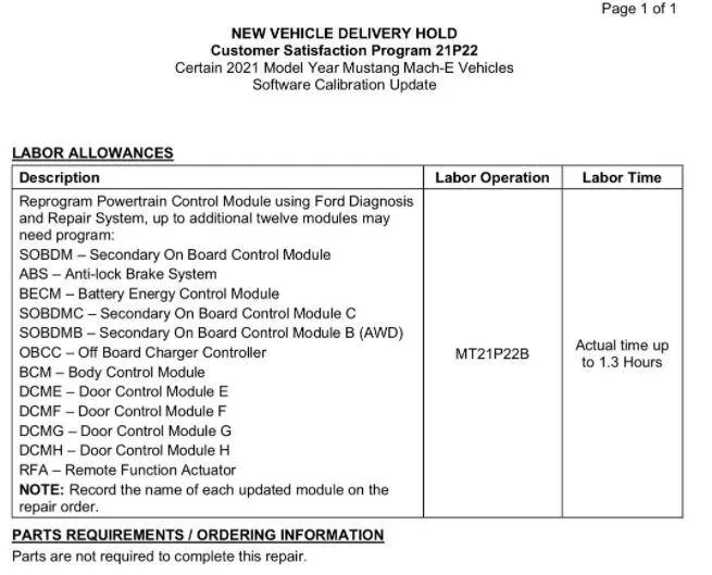

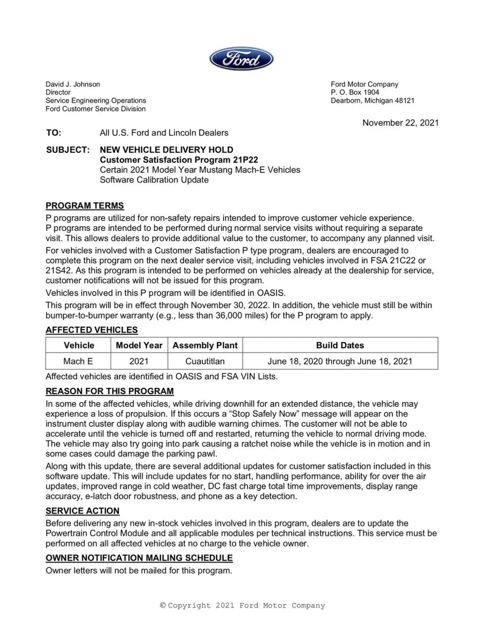

Once you get TSB 21p22 done by Dealership you *should* be ok in most cases for HV->LVB from what I've sifted out of the threads. You just have to check carefully that the Dealership actually suceeded in updating ALL the modules in the TSB.
Any chance you have a PDF of this TSB? I just got the HVB Warning this week and although the car drives okay, I have reduced power and am taking it in. It’d be nice to take a peek at this TSB to see if my symptoms match up.
I got my abbrevs wrong... It's a CSP, not a TSP... here's what I have on it, and all the modules that are supposed to get updated. The problem is that some dealerships have old versions of FDRS and don't finish updating all modules.... and unless you have access to the FDRS tools, you can't verify whether or not your vehicle got all available modules updated.
Ford Mustang Mach-E Stop safely now 01 CSP 21P22 update notic
Ford Mustang Mach-E Stop safely now 02 csp 21p22 modules ToBeUpdated
CSP 21P22 has now been extended to cover additional build dates through September 30, 2021.
