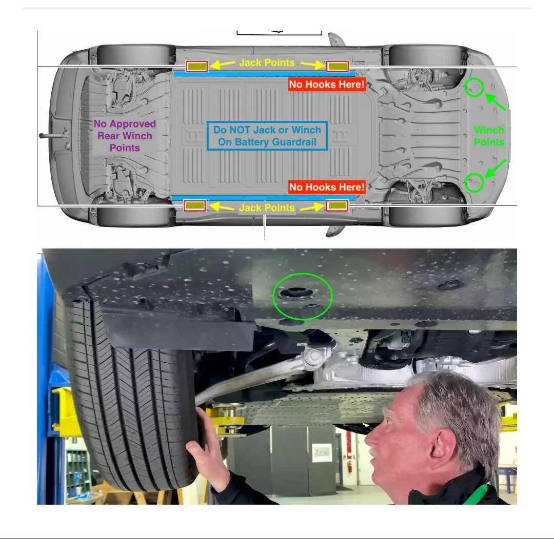

Absolutely make sure the tow truck driver knows it’s an electric vehicle knows where the tow points are knows what to do otherwise you can destroy the car. I had that issue with two cars sold them both now waiting for another one and unsure whether they have fixed it it’s a high voltage problem between the 12 V and the main battery module
-ABOVE is the Reason it took 8 hours to get a tow- NO ONE will risk almost $30k in damage
